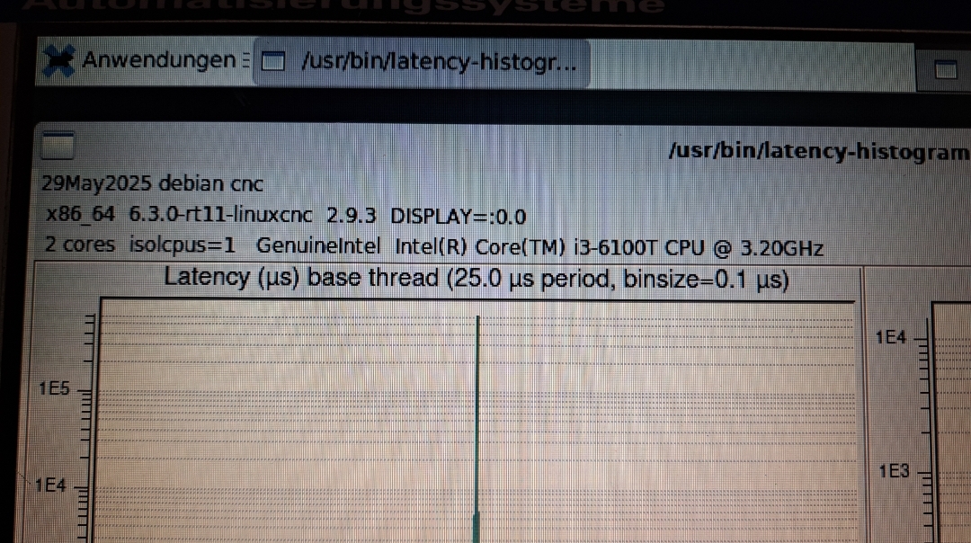

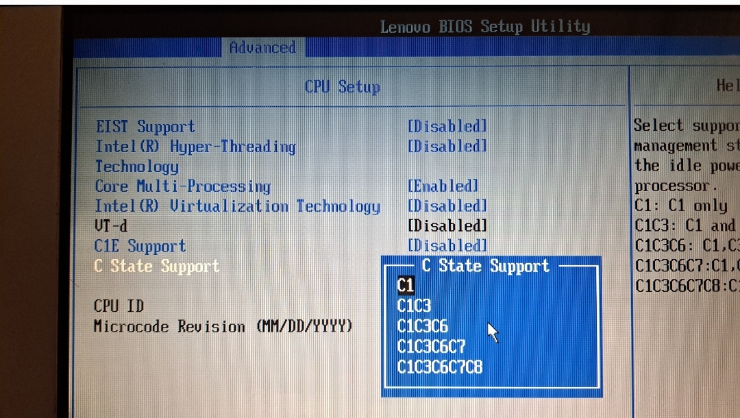

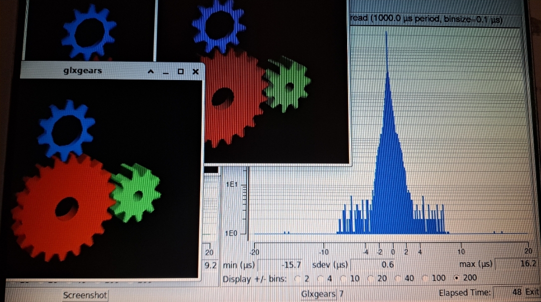

1 year 5 months ago #329289
by juliankoenig87
Replied by juliankoenig87 on topic Getting Setup with PC and MESA
Thinkcentre tinys (m73, m93, m710q ....) working great. They have Intel nics.
But also Fujitsu Esprimos working great with Realtek nics. To be honest we encounters over the past year, that realtek working a lot faster. Also pci realtek boards working damn good.
But yes, historically there were problems with realtek nics, so one can have problems. But I personally looking nowadays for realtek instead of intel, but I know what I have to look for.
For a beginner I would say a Lenovo Thinkcentre tiny (maybe with wlan on board) is a really good machie. Look for m73 or m93 with 8GB and ssd and you will be happy. Isolcpus needed! and of course the lines for the intel nic. Other than that no need for tweaking when speaking of 1kHz thread.

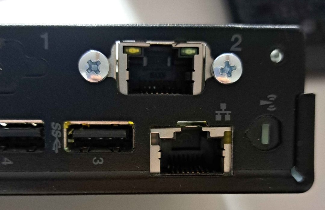

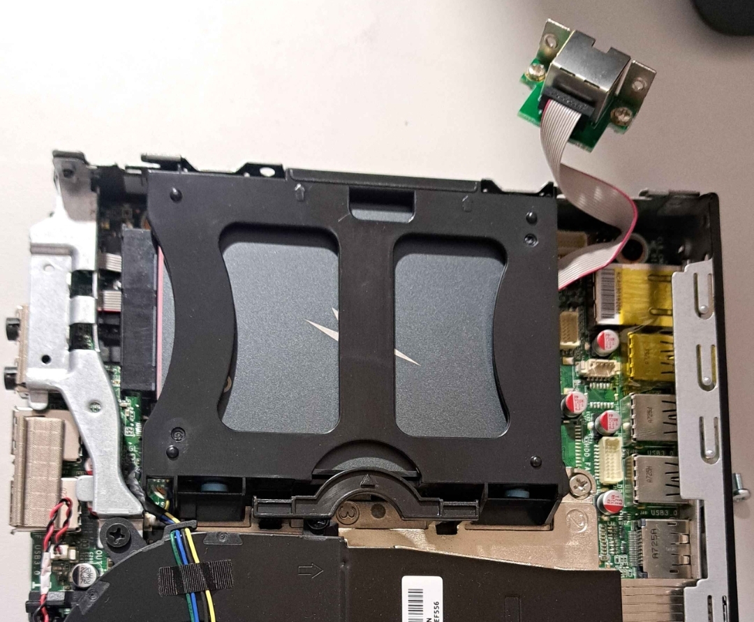

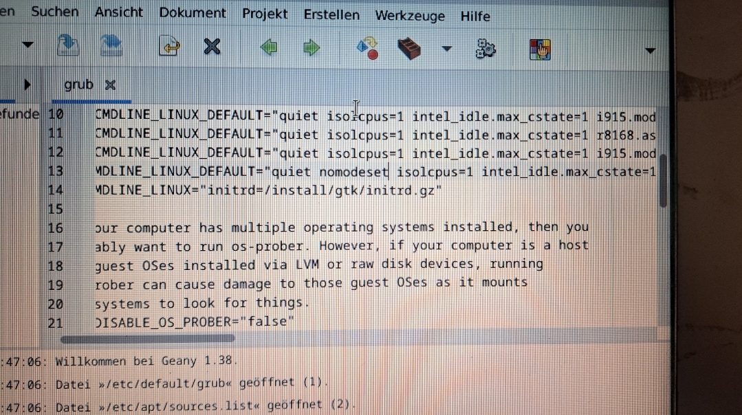

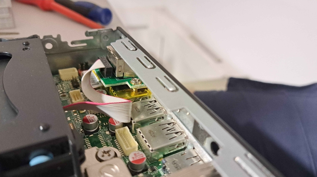

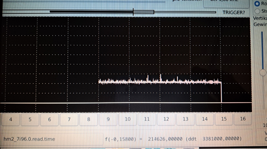

1 year 5 months ago - 1 year 5 months ago #329327
by juliankoenig87
Cool. M710q works fine. Have one in a router installed. Can give you the grub infos for the first test.
Just for information. Have also a M2 to realtek nic installed in the m710q which runs stable 2 kHz servo thread. But that isnt necessary. The internal intel nic runs 1 kHz with ease.
