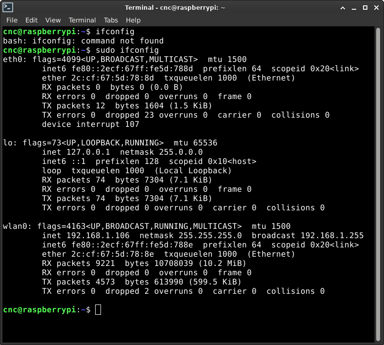

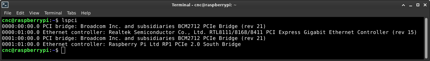

i am pretty sure that is the problem, as i see the card with lspci as described in the user guide:
but not in ifconfig:
it is also stated, drivers could be installed manually but its not recommended.

57:76:DE:B3:EC:D2:AA:DE:54:E4:C0:6EYou may have to check dmesg for any references to R8169. PCIe should be enabled, I used a NVMe boot drive. Remember that the location of config.txt is

Seems the card uses a R8168 interface. The R8168 requires a DKMS driver to get acceptable RT performance. Not sure how that goes with a Pi. I would not use it for ethercat but would be fine for general network use.
