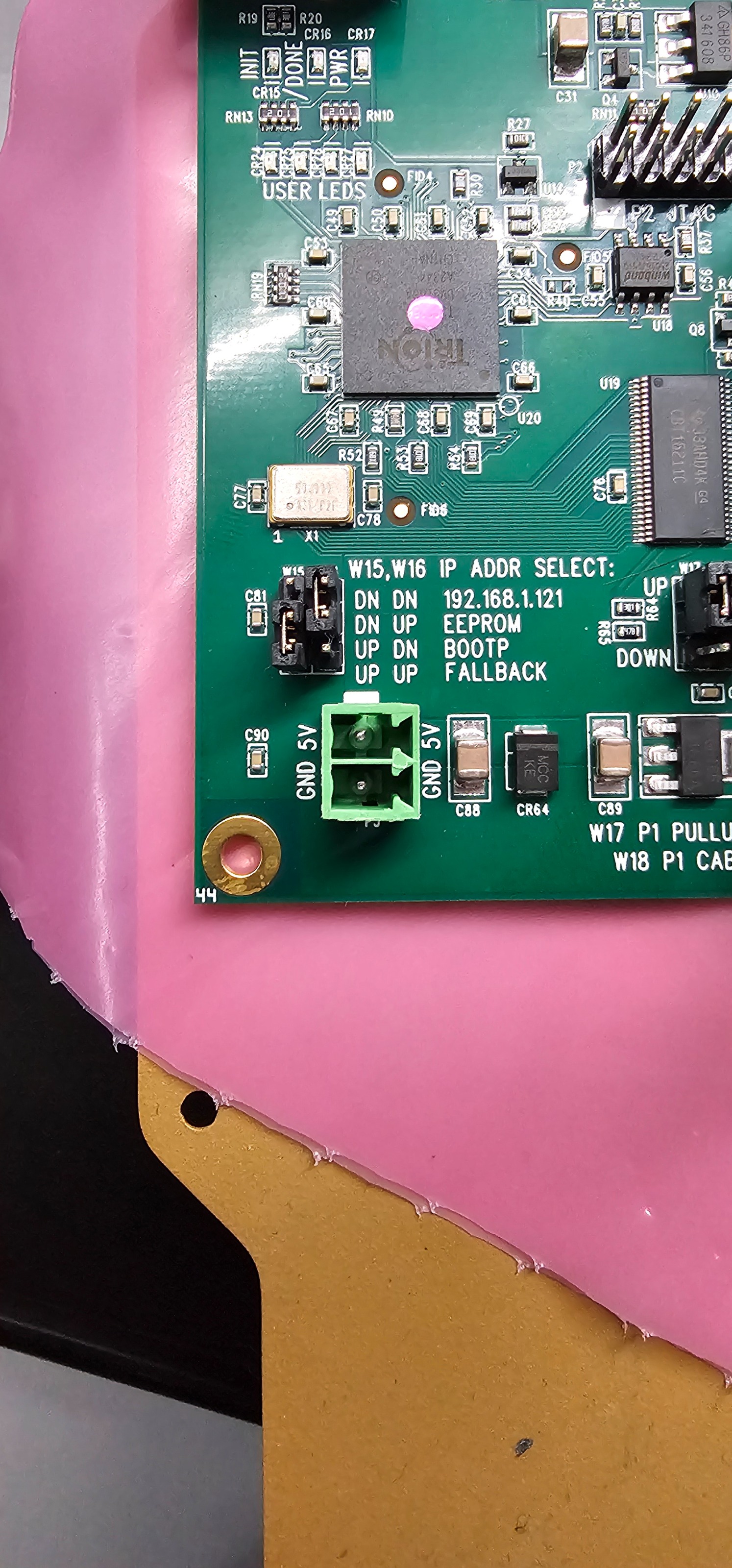

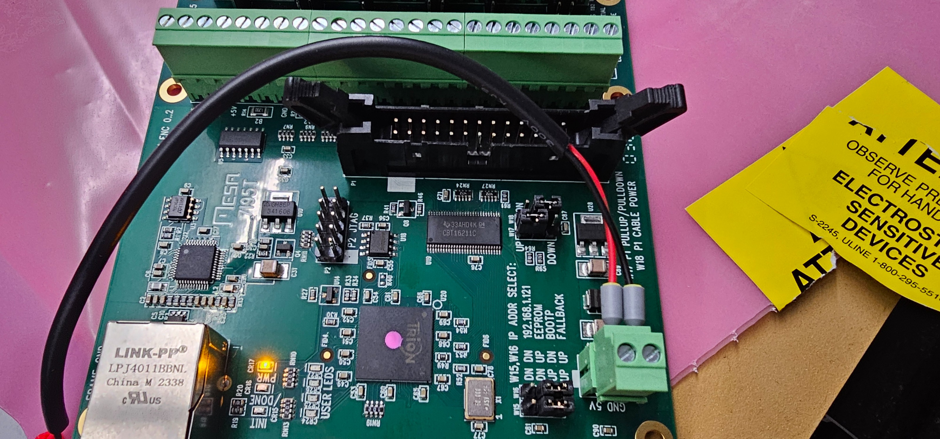

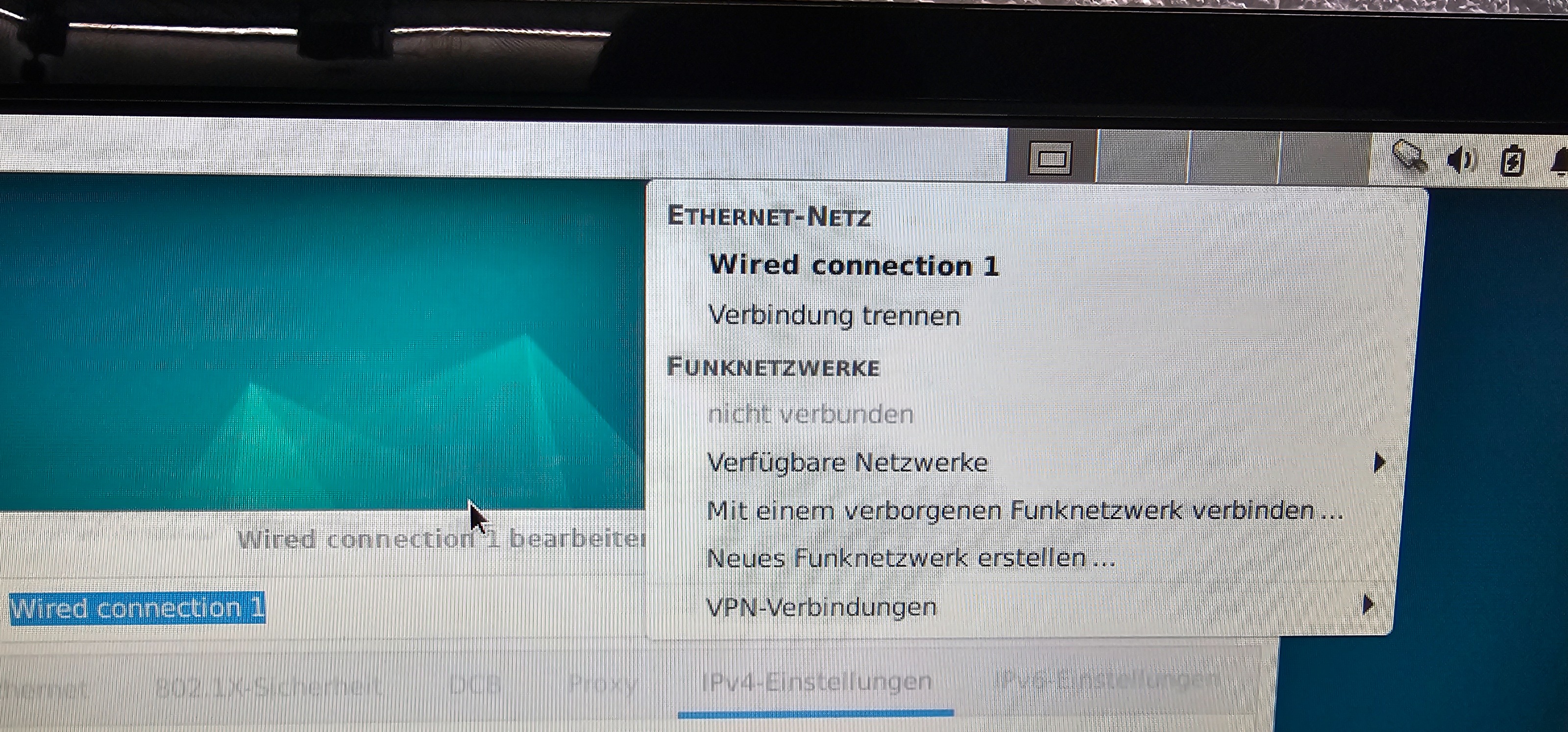

Fist up im brand new to this topic with linuxcnc.So i have bought a 7i95T FPGA Card and now i have the problem that i cant ping it or even read the config.The networkmanager says its connected to a ethernet Network, it recognices when its being disconected and connected.Ethernet Port on the card does blink from time to time (the way it does when sending and reciveing signals).When the card is being powerd on the DONE and INIT lights light up shortly once and the USER LEDS cycle as well.PWR is light up orange.No jumpers have been moved and it only has been connected to that ones pc´s ethernet port.
Searched everywhere to find an answer but no luck.

You have the IP address jumpers set to 192.168.1.121 mode (down/down)
rather than EEPROM mode (down,up)

So how would i have to set the jumper to be correct.
Havent yet figured out how there ment to be set

Like this ?

Yes, that is the EEPROM setting.
(default EEPROM IP address is 10.10.10.10)
- Posts: 22001
- Thank you received: 7488
23 Oct 2025 19:46 #336984
Replied by tommylight on topic Mesa 7i95T not responding
Yes.
In a terminal
ping 10.10.10.10
should return values with the time it takes to card and back in ns (nano seconds).
In a terminal
ping 10.10.10.10

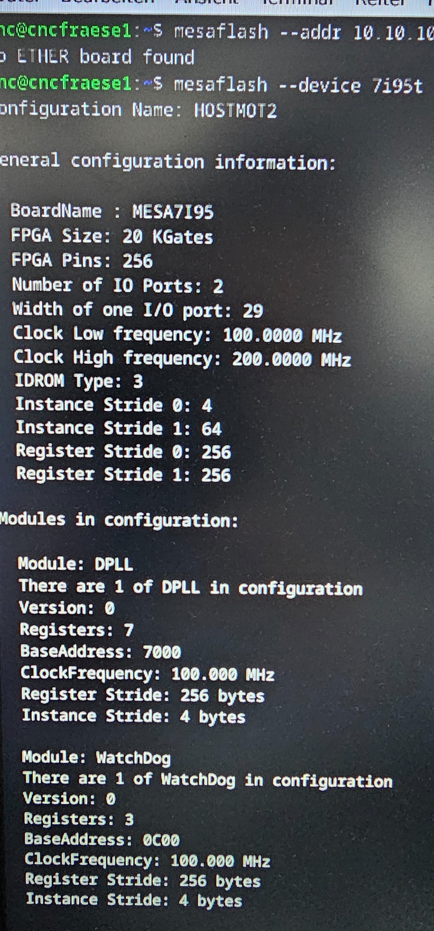

Thanks, it works but one more thing.
Even tho its a 7i95T is it normal that it only says 7i95

- Posts: 18111
- Thank you received: 5330
23 Oct 2025 20:44 #336989
Replied by PCW on topic Mesa 7i95T not responding
The 7I95T identifies as a 7I95 (even in hal) mainly so 7I95 configs will work with it.
