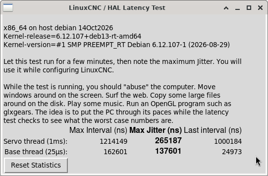

Hallo
I cant get my stepper motor to turn. It is linuxcnc version 2.9.4, a leadshine cs-d508 and a transmotec SHW4247-09-168. The configuration files originate from a 7i95t setup via MesaCT, but I have tried to adjust the prarameters of the ini file in order to get it running. When starting linuxcnc (axis gui) it powers the motor up (blocks the shaft) and at first does not show any errors. (Later with the test ngc file error finishing read and joint following error) The gui shows the movements according to the test ngc, but goes beyond x=50.
Only the x axis was set up since I wanted to keep ini and hal files as simple as possible in order to alleviate debuging and error tracking. I am aware the cs-d508 is a closed loop driver. After the system is correctly behaving, I intend to retrofit a DRO to my lathe and use its signal for a closed loop system
It does turn when used with an arduino and tb6600 With linuxcnc it turns neither with cs-d508 nur tb6600.
Any ideas what I am missing ?

I was not really aware of latency issues since according to my understanding the signals are provided by the mesa card. Whether mine does so correctly I cannot tell ( and dont know how to test ) so far. In the attachments the information you asked for.The latency test was done while in the internet but no more additional load for the computer. Neither a latency test done in the past nor hardware recommendations from the web gave me any hint this could in my case be a problem. Next, I will do some research about how to adjust the bios in order to improve things.

I changed the network adapters: Mesacard is now Intel 82579V, internet Realtek RTL8111/8168/8411
ping times now are 0.019 - 0.022 ms compared to approx. 0.03 ms before (see attachment).
No change in behaviour. The motor vibrates when it is supposed to move but I cannot see or feel, respectively, any movement.

The ping times show that the host is set to a 10.10.10.11 IP address and the 7I95T is set to 10.10.10.10
With and Intel MAC you should disable IRQ coalescing:
man hm2_eth
For testing, you can temporarily disable IRQ coalescing with this command:
sudo ethtool -C eno1 rx-usecs 0
( replace en01 with your Ethernet device name if different )
For testing general host latency, when a base thread is not used (like with Mesa cards),
you should run the latency test with the base thread disabled:
latency-test 1ms
or
latency-histogram --nobase -sbinsize 500
Also you should go through all the standard latency reducing methods here including the isolcpus grub setting:
linuxcnc.org/docs/html/install/latency-test.html
Just to get things going you should make sure the step time is 5000
and worst case you may need to increase the servo tread period to say 2 ms
(2000000 ns)
