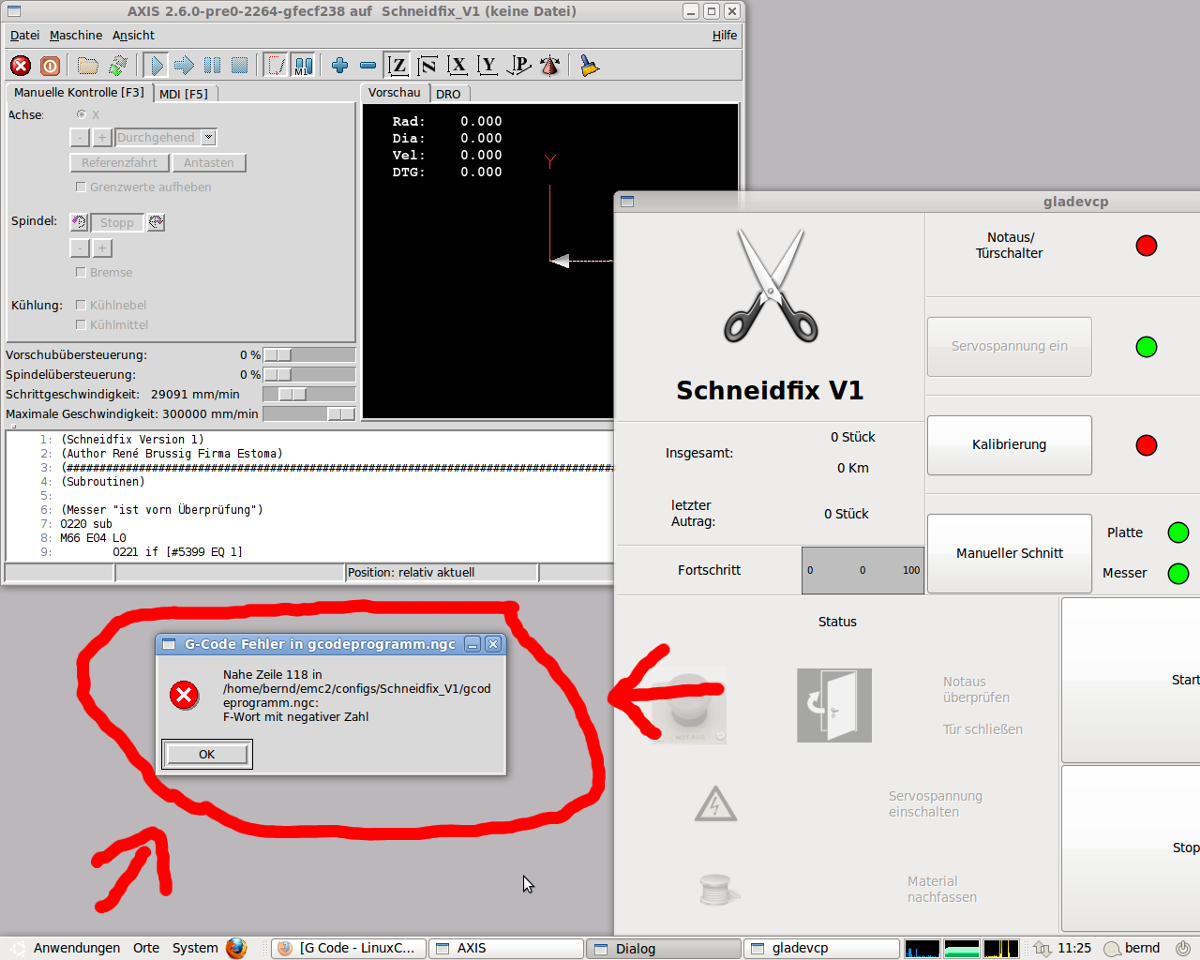

Hello,
I build this machine:
I want that every Operator our company can use this machine so i made a gladevcp userinterface,
The glade panel is standalone and loads after the axis program.
All hal boxes in this panel are connectet with analog ports.
The gcode programm read these analog ports
The problem is when axis starts the analog ports are zero and axis shows an error message.
how can stop axis from sending this gcode error messages.
In the attach is this gcode programm. Error is in Line 115
Sorry for my bad english.

You will have to somehow not have a negative feed value to prevent the error. Perhaps use an absolute number that can not be negative.
Very nice video and a neat machine... you do have a lot of error messages on your screen to work out.

Did not have time to follow the logic but perhaps if after...
#<rueckfahrspeed> = [#<temp1> - #<pos1>] / [#<schneidzeit> + #<haltezeit> * 60]
You added logic that...
If <rueckfahrspeed> is less than or equal to 0
#<rueckfahrspeed> equals 10 or some number that will not cause a problem
Then continue, again I have not followed your logic but earlier in your program you have...
#<rueckfahrspeed> = 10
Rick G
Rick G

Good idea Rick, I just tested in the Axis Sim and F0 is an acceptable G code so if less than 0 set to 0 should solve the problem.

I have found the problem.
At the start of axis the parameter #<laenge> = 0
with this parameter i calculate #<rueckfahrspeed>
#<temp1> = [#<laenge> + 20]
#<leerlaufzahl> = 0
o102 while [#<temp1> GT #<maxlaenge>]
#<temp1> = [#<temp1> - #<maxlaenge>]
#<leerlaufzahl> = [#<leerlaufzahl> + 1]
o102 endwhile
so get a negativ number
If fix this with
O112 if [#<laenge> EQ 0]
#<laenge> = 1000
O112 endif
modified Gcode in the attachments
now i get no error massage but when i now start axis the interpreter hang up.

After exiting Axis this error is shown.

If when you load a G code file with loops Axis hangs up it is usually a loop that does not ever exit or loops a zillion times.

Hi
JT beat me, the video looks like it is in an endless loop.
The errors are related to loading the .ngc file too which figures
Only thing to do is revert to the file that loaded and slowly introduce the changes until you hit a problem.
I would suspect that your substitution of 0 for 1000 is having an unforeseen effect in another section of the code.
regards
#<laenge> = 1000
O112 endif
this should be a lower than or equals if equate , i under stand this to equate to 0 only and not a lower than or equals , so i recon it hangs up
