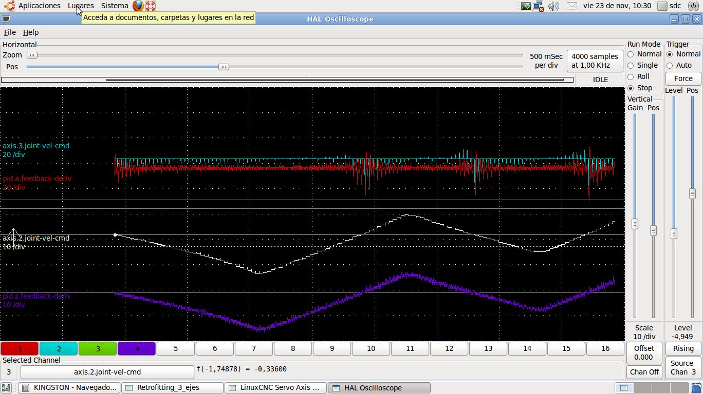

Hello all,
I'm trying to retrofit an old last turning machine with linuxcnc.
I have 3 axis:
X linear.
Z linear (with a toroidal tool)
A angular.
Really the whole thing is little more complicated because the tool axis (Z) is mounted in a pendulus arm, but I have developed the CAM software that calculates the position of the linear actuator to make everything work and the G code is just like 2 linear axis and one angular axis).
I'm using a 6i25+7i77 mesa cards and 3 servomotors (7.5 N/m torque and 3000 rpm)
Everything is more or less configure now, and I'm making some tests without coupling the motors with the machine axis, with a cilinder every thing works fine, but when I try to make a rectangular prims I have an strange error:
When the speed of the Z axis is 0 also the system is slowing dawn also the A axis and X axis.
Attached is a screenshot from Halscope. The blue line is the commanded speed for the rotation axis and the white is the commanded speed of the Z axis, you can see that when the commanded speed is zero in Z axis the system is slowing down also the rotation axis.

See that I'm using the inverse feed rate G93 and the G64 mode.
The desired behavior is maintain the rotation speed smoother as possible. Do you have any idea why is the system slowing the rotation?

The inverse time mode only means that the coordinated move will be completed in the time specified by the F word. Coordinated is the key word, when combining linear and angular moves the moves will all end up at the same time.

thanks a lot for your answer.
Then the solution to maintain the rotation speed more or less constant is configure the Y axis like angular and don't use the A axis, or making a new kinematics module to use with my machine. and give the toolpath in cartesian coordinates and let the kinematics module make the conversiont o to joint position.

I know of machines that the Y axis is rotational and were configured as linear. The problem is you have to calculate the scale for each diameter... but it is doable.
They now use a rotational axis for the Y and don't have any problems. I suspect the G code your using is faulty for what you desire.
