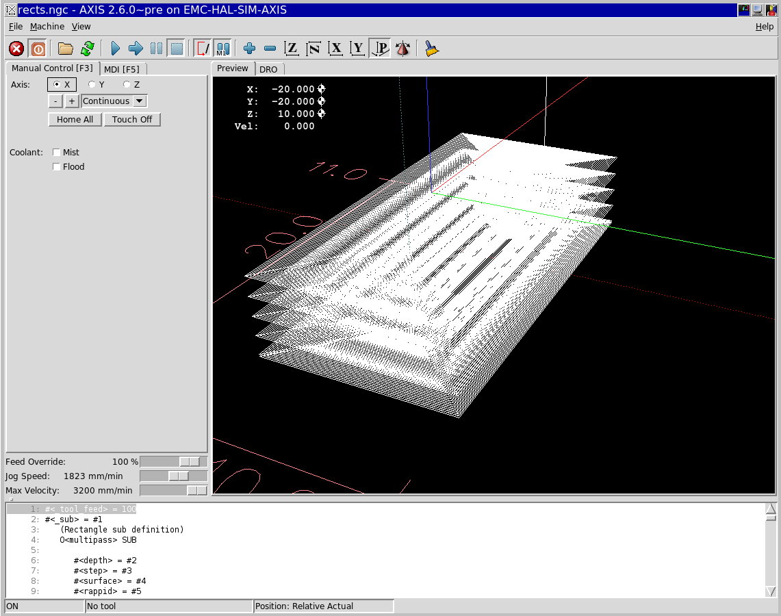

Yes, but I do want a local parameter.
You cannot expect a local parameter to be available outside of its scope, unless you pass it as an argument to another sub.
More over, the first one with local #<tester> will work too, because you've defined #<tester> at the top of the code outside the Subroutine. (see my second variant)
It does NOT work I tried it. Your second example only works because it is using the locally defined parameter of identical name, not the one defined one level above it.
And the most interesting: after opening second variant with #<sub> defined outside of O SUB, the first variant began to work fine until LinuxCNC restart.
I suspect that you have managed to confuse the interpreter at this point by having several parameters of the same name over different levels.
I thought originally that named parameters were stored in some sort of table, hence thinking that there was some indirection at work.
Looking at the code, named parameters are stored in an array by level. I know there is some problem regards the number of levels that can be nested and expect that you are actually referencing the values elsewhere than you think and when linuxncnc is reset the array is cleared.
It is a little unhelpful that the error produced is not the same as that logged
The error refers to that name not being defined in that level, but it is not what the error message says
from interp_named_parameters.cc
logNP("%s: referencing undefined named parameter '%s' level=%d", name, paramNameBuf, (paramNameBuf[0] == '_') ? 0 : _setup.call_level);
ERS(_("Named parameter #<%s> not defined"), paramNameBuf);
I think using globals for parameters expected to be read at other levels will resolve most of the problems
regards

If I run your code, with #<sub> referenced as #<_sub> and declared in global scope ie. outside of the O<multipass> SUB
it works as you expected, as far as I can see.

30 May 2013 17:12 #34957 by Nick
Replied by Nick on topic Gcode subroutings issues
Ups... I missed that.
But anyway this behavior seems to appear only with O-code.
If we change O#<sub> CALL to #<2> = [#<sub>+3] or G0 X#<sub> everything works.
And the error occurs right after opening the file, this code is not even called.
I know, but here all variables are on the same level :dry:
O<multipass> SUB
    #<sub> = #1
    O#<sub> CALL
O<multipass> ENDSUB
