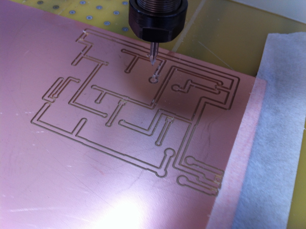

I did some PCB milling were I converted the Gerber data to PCB milling insulation data to remove the copper and leave the tracks. That works well (if the laminate is flat).
Now I like to try photosensitive laminate and expose the same insulation data with laser. The advantage is that I am not so Z-axis sensitive (PCB laminate is often not totally flat).
But when I go from one track to the next track the CNC tool will move up, and move the next track. When I do that with the laser the laser power will stay ON and the travel track will be exposed.
Is there a way to switch the laser power OFF when the Z-Axis moves up?

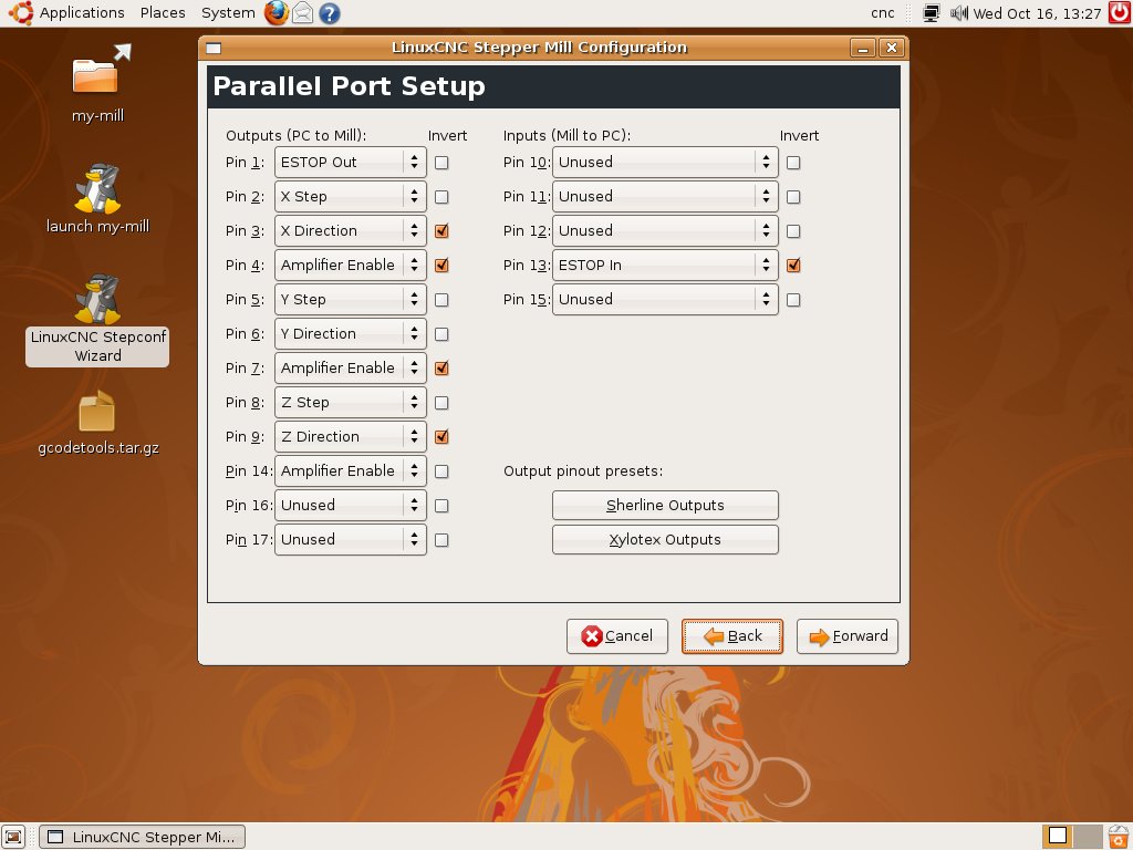

16 Oct 2013 15:15 - 16 Oct 2013 15:18 #39941
by cncbasher
Replied by cncbasher on topic PCB milling with laser - power off when Z is up
add in stepconf a spindle output , so select a spare pin as Spindle CW , this will give you an output that you can drive a relay and will give you on/off with M3 / M5
also if you add spindle pwm to a pin that would give you an output to vary the power level of the diode , using the spindle value as a level , if you can interface the pwm output to your laser driver
