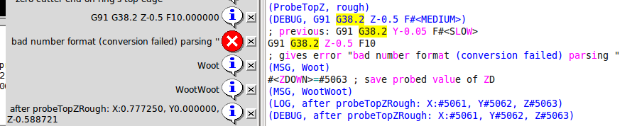

Getting error: "bad number format (conv failed) parsing""
This one's a run-time error. At a certain line--rather, between a certain PAIR of DEBUG comments--in the program AXIS displays an error msg (white X in red circle), but the program executes a few lines past it before ceasing to execute.
(EDIT: I forgot to mention that an (AXIS, stop) comment command precedes this code block.)
You can see from the attached (takes moment to attach screengrab...) that the suspect "G91" line (on the right) parses correctly (on the left) in the (DEBUG) statement at the top, but that in any case the actual "G91" line presented for execution has no parameters in it.
The left-hand display shows the output of the DEBUG, followed by the "bad number format" error, followed by the bracketing "Woot".
The problem may be that I am still thinking like a programmer in that I'm expecting the "bad format" error to be occurring BETWEEN the two comments, but it could be, I suppose, an error detected by some independent process that is queued to the error display and comes out wherever it happens to fall.
What's happening?

Very hard to tell much from such a small snippet, but should think it is coming from the line you highlight.
DEBUG does not parse anything, it echo's the line, making substitutions as required (printf-ish) and anyway that line in DEBUG is not the same as the one that fails
Look at .../src/rs274ngc/interp_read.cc in the linuxcnc sources
Interp::read_real_number()
for the origin of the error message

17 Jan 2014 15:54 #42919
by clunc
Thanks, ArcEye.
I didn't mean to say that DEBUG was parsing, but that the DEBUG statement demonstrated that (whatever) the parser was able to parse the parameters correctly.
I finally saw it: "<#ZDOWN>" instead of "#<ZDOWN>".
Sheesh, at least here's one real-world example of what "bad number format (connection failed parsing "" means.
Sorry for the poor use of bandwidth, but I'm very happy to get the insights into how to peek into the underlying source code.
