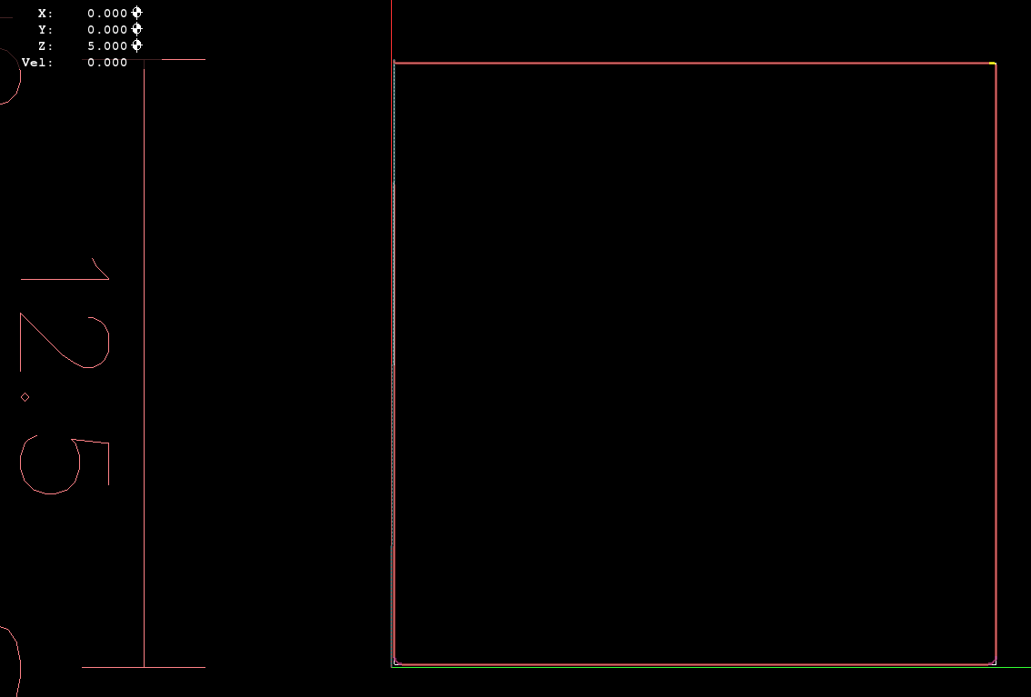

Hi All,
I am new to cnc and trying to engrave a square (0.5 in. x 0.5 in. outside edge) into aluminum with a sherline 3-axis cnc mill using tool diamteter compensation. The program is below, created with the help of inkscape. It works perfectly, the square is exactly the size i want, except that the last cut line overshoots on the Y axis by about 1/2 the tool diameter. Can anyone see what I have done wrong?
Thanks!

Hi
This would be a very good project to learn coding by hand, CAD/CAM seems overkill.
I am not sure exactly what dimensions you started with, it looks as though you are using cutter comp and adjusting the coordinates.
If you write a simple program to cut a 12.5mm square like so
Because you have told the interpreter that the cutter diameter is 1mm and you want to stay to the right side of the line (G42 D1)
all you need to do is program the finished size you actually want, in this case 12.5 mm
The plot from the cut below shows that it takes a course 0.5mm inside the line all the way around
regards

M2Because you have told the interpreter that the cutter diameter is 1mm and you want to stay to the right side of the line (G42 D1)
