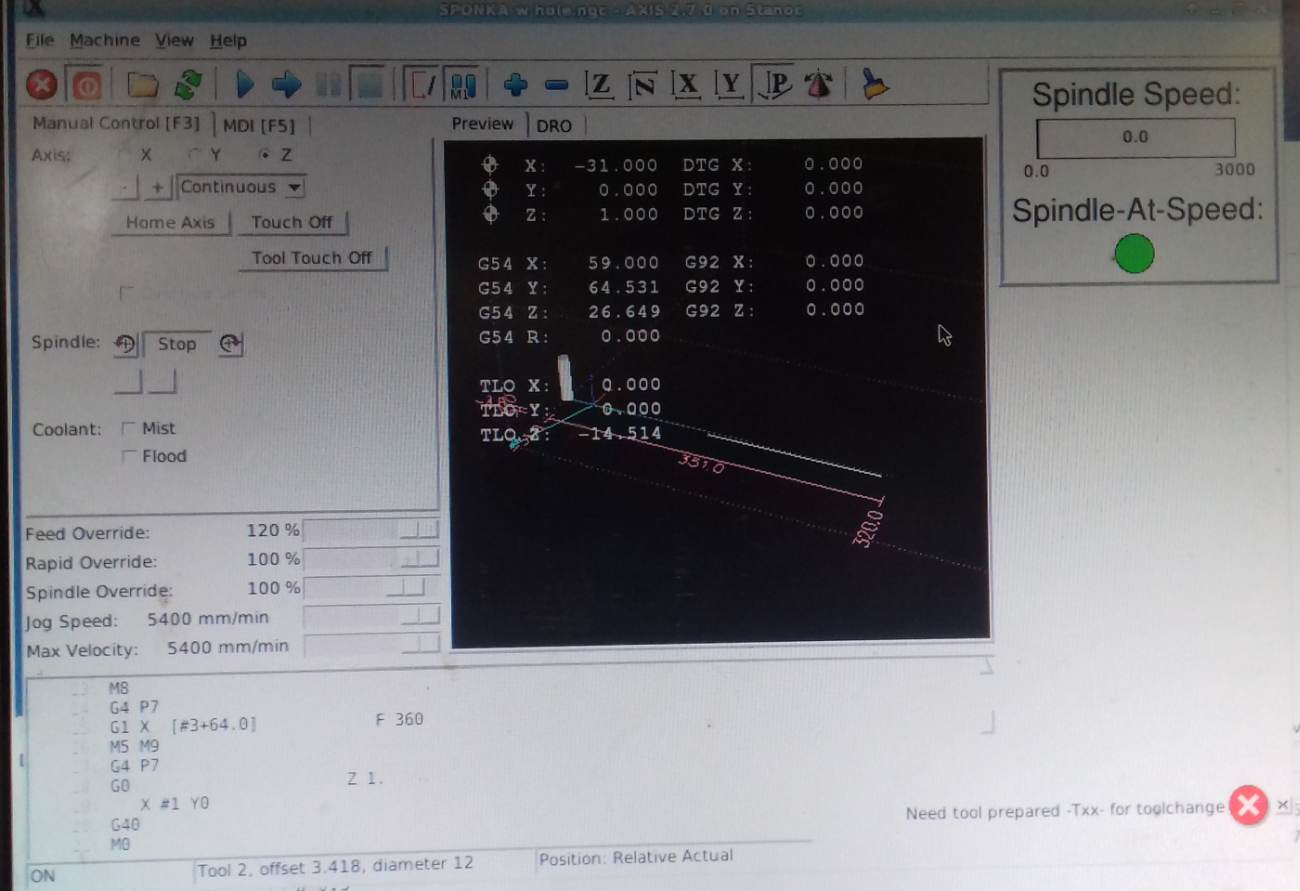

Got message "Need tool prepared - Txx- for toolchange" was created by fester

It would help to know what you did to get the error. I suspect you issued M6 without a Tn with n being the tool number like T1. You can issue a Tn then later on issue a M6 but not the other way around.

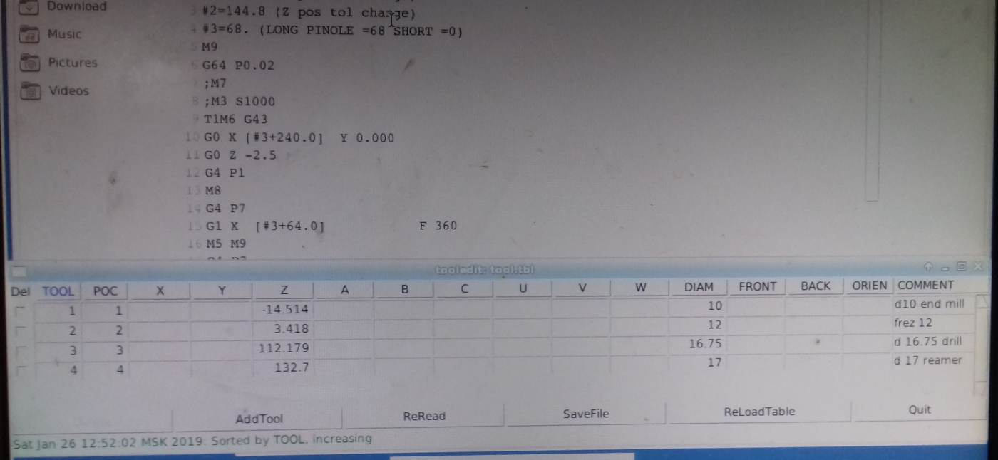

Don't post photos of the G code instead attach the file so others can test the actual code.

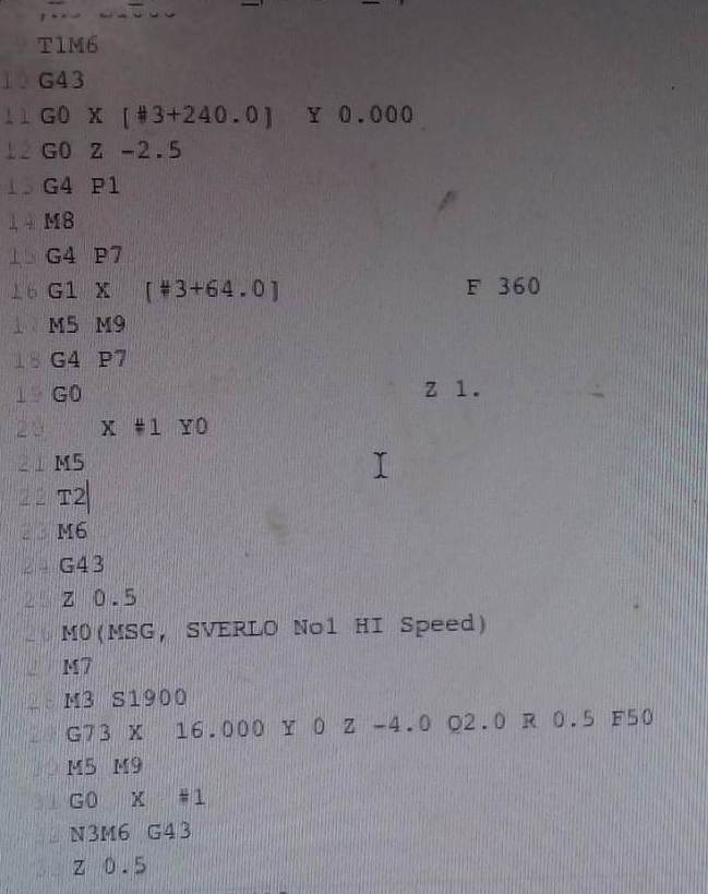

The trouble was solved by deleting strings #22-24
with
and typing instead
and at string #32 there was
I've corrected it by
Now all is OK, thanks.
The error msg appear at T2, so I suppose there was some illegal invisible symbol in the prog, but maybe my mistake in string #32 (N3M6) made such effect.

I couldn't figure out, that the system looks so far forward.
Maybe it'll be helpful for someone.
Replied by fester on topic Got message "Need tool prepared - Txx- for toolchange"
That was the clue!fester wrote: and at string #32 there was
I've corrected it byCode:N3M6 G43Code:T3M6 G43
