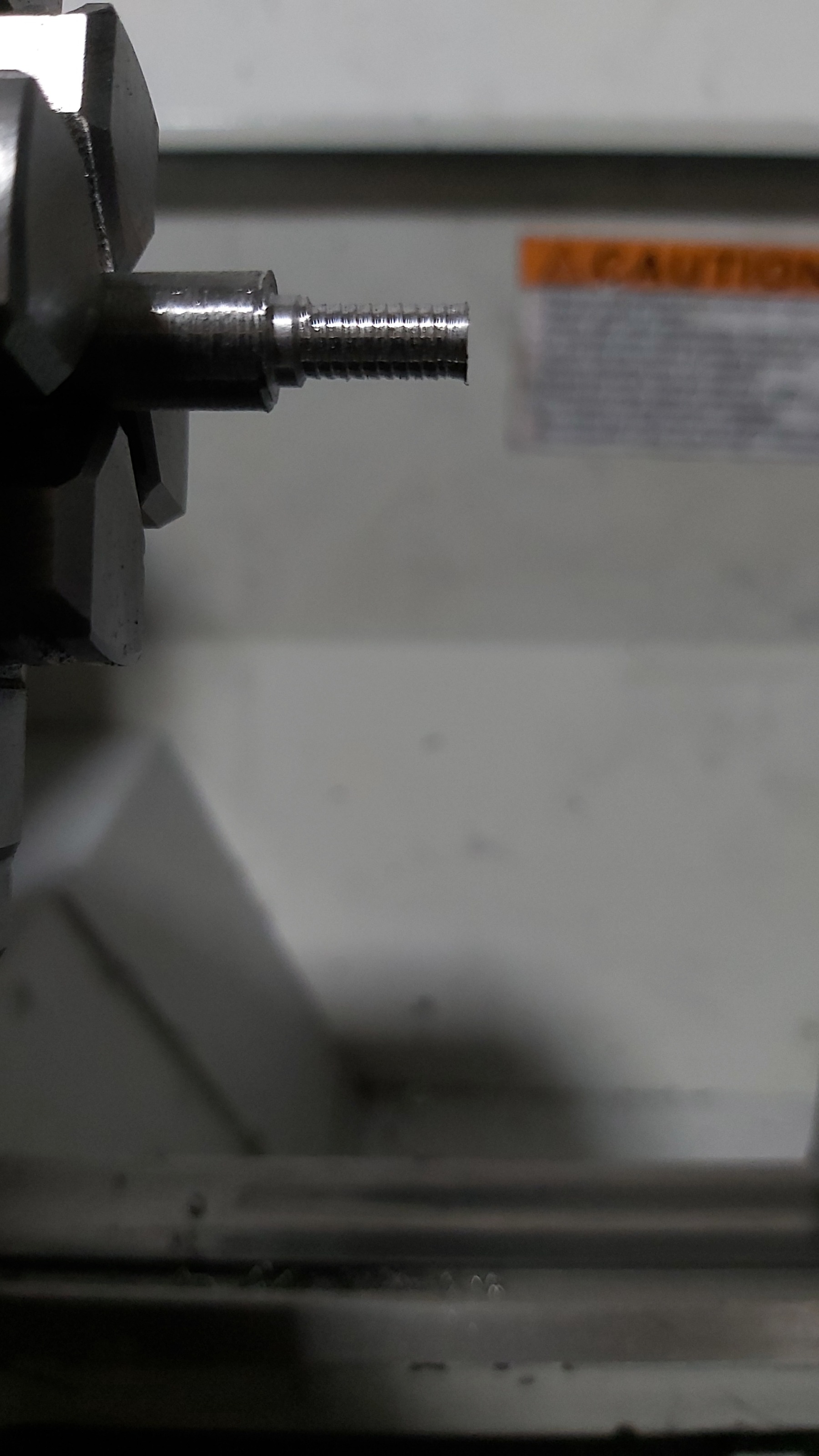

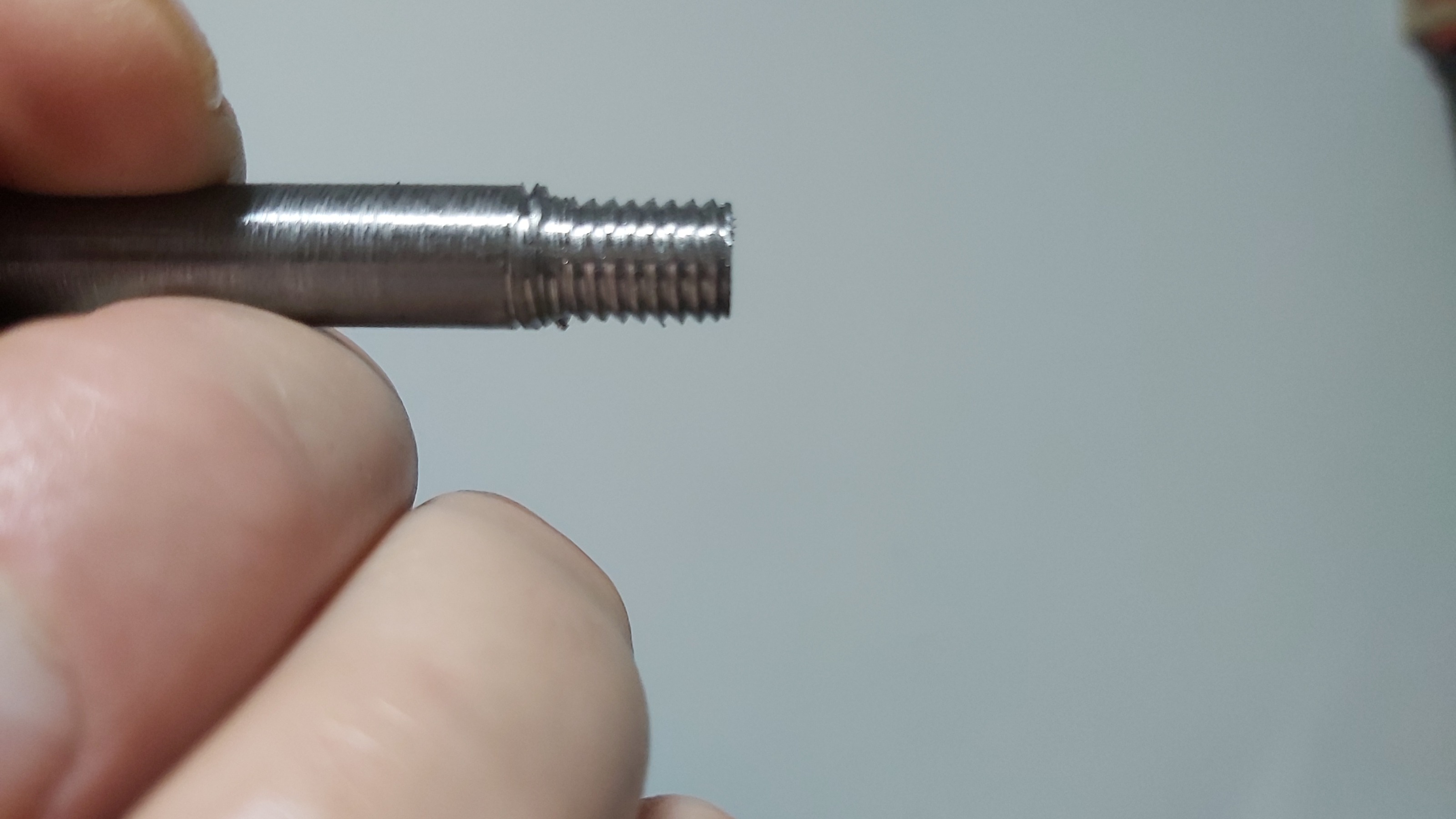

Hi, after a lot of struggling I have managed to make something similar to a bagel.
The problem I have is that each pass the cut is brought forward a bit.

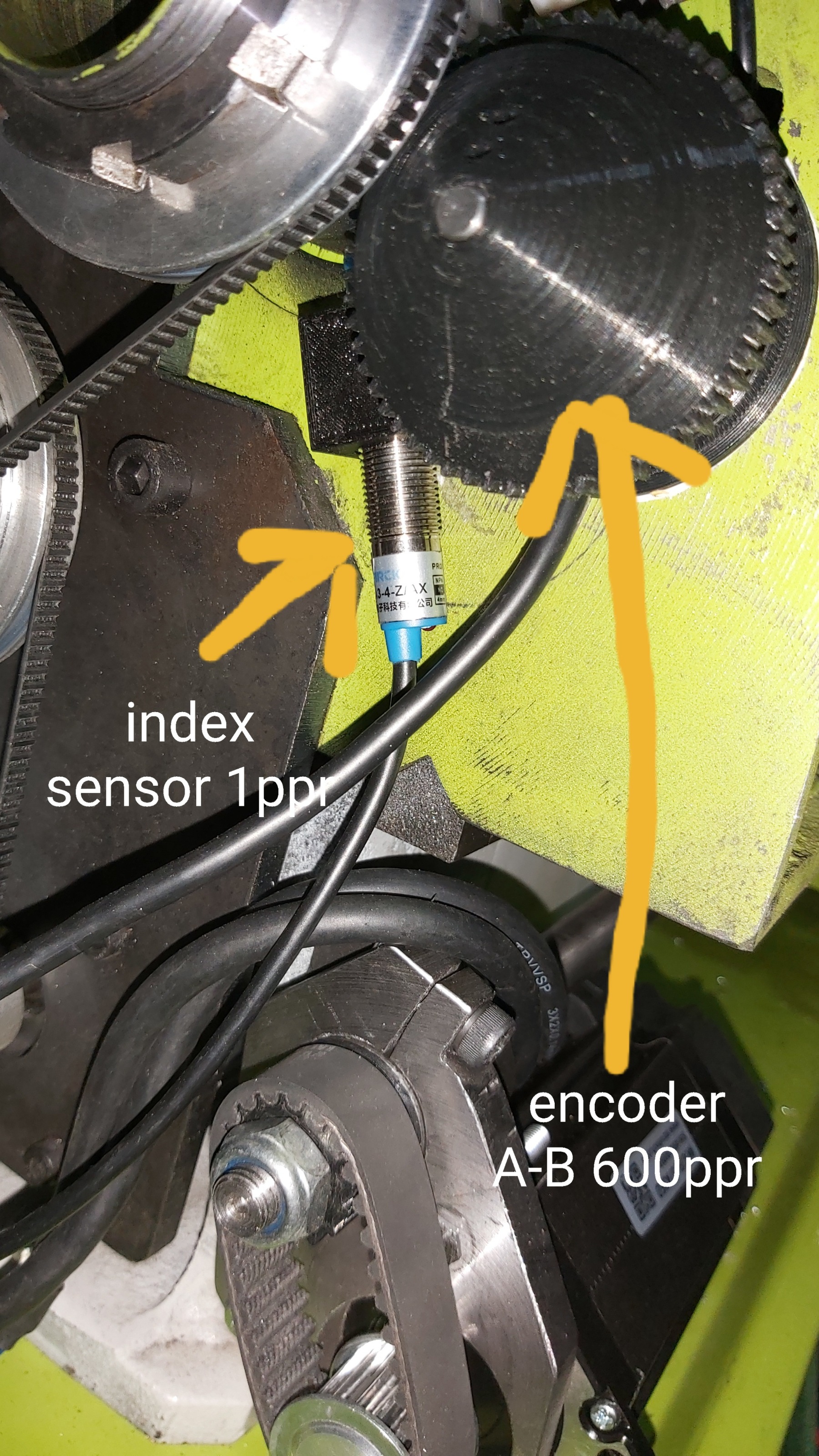

I have an A-B encoder with 600ppr and a 1ppr rate sensor. the encoder is connected to phase A and the index sensor is connected to the spindle index.
I would really appreciate if someone can tell me what is going on.

Scaling is not correct, or to fast spindle speed if using a parallel port, or encoder cable not shielded so interference causes erratic counts.

Having a scope would help, but sometimes using a simple DVM can be enough to spot interference.
Set spindle to run at say 200RPM, measure the voltage betwen gnd and one of the encoder inputs, it should not fluctuate, measure the other chanel, also should be no fluctuations in voltage reading.
Set at 400 and measure again, no fluctuations, vut voltage might be different value.
Set at 600 and measure again.
The voltage vill be diferent value for diferent speeds by a bit, should be same for encoder A and B.
You still did not mention what is counting the encoder.
If it is a parallel port, do not bother measuring, just try lower speed..
Still, if the error distance is the same after every start of threading operation, it is a scaling issue.
Then again, it can be the Z axis is skipping. Does it return to the same starting point after the operation is complete?

14 Dec 2022 18:08 #259482
by Ismacr63
when the operation ends it does not return to the same point, I put a mark in Z0 and when the operation ends Z0 stays a little further forward.
when it makes a pass, the Z axis moves to the beginning for a new pass very quickly, but I don't know how to lower that speed. the general speed setting in Z is set slower than it travels in threading.

It travels at the G0 speed (MAX_VELOCITY from the INI file, in general)
Try lowering that a bit. But first try lowering the MAX_ACCELL
Also, do you have backlash compensation turned on?

15 Dec 2022 19:06 #259571
by Ismacr63
Replied by Ismacr63 on topic G76 problem
I have corrected the backlash compensation and it was not the problem.
From the tests that I have been doing, the problem is that I lose steps in Z.
I have tried to lower the maximum speed in stepconf wizard, but whatever I put the motor moves just as fast with the G76 (very fast). with Z+ or Z- the motor moves much slower.
In the INI file the MAX_VELOCITY value is always = 36.5384615385 no matter what you put in the stepconf wizard.

As you say, I have slowed down and it seems that I no longer lose steps and it makes a decent thread. but how is it possible to lose steps with a closed loop motor?if the Stepconf Wizard is not doing what you want, you should feel free to edit your INI file. The INI and HAL files are intended to be human-readable and user-edited.
