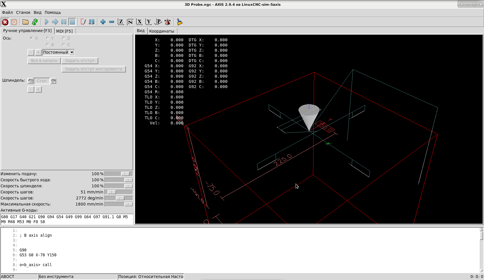

26 Aug 2025 06:49 #333932 by xenon-alien
Replied by xenon-alien on topic Round system parameter to tenths?
I figured out how to make it work the axis alignment
But on 2.8.4 LCNC my code hangs out the LCNC when i uncomment the:
O100 do
O100 while [#_<ValueABS> GT 0.007]
The whole code in the attachment.
I want to combine 3 measurings in one file (also in attachment), but the same result - The LCNC freezes out without errors.
The decimal test code works fine
Maybe the global parameters makes the issue?
Can anyone tell how to solve this?
28 Aug 2025 14:00 #334042 by andypugh
Replied by andypugh on topic Round system parameter to tenths?
You may be seeing a problem caused by the G-code preview. That runs through the code to draw the lines, but won't update values based on probe results etc (as it doesn't _move_ anything).
The trick here is probably
O100 while [#<_task> EQ 1.0 AND #<_deltaabs> GT 0.007]
Which will end the loop early in preview generation.
linuxcnc.org/docs/stable/html/gcode/over...ub:system-parameters
The following user(s) said Thank You: xenon-alien
29 Aug 2025 07:36 - 29 Aug 2025 08:42 #334076 by xenon-alien
Thank you! It's HELPED!!
