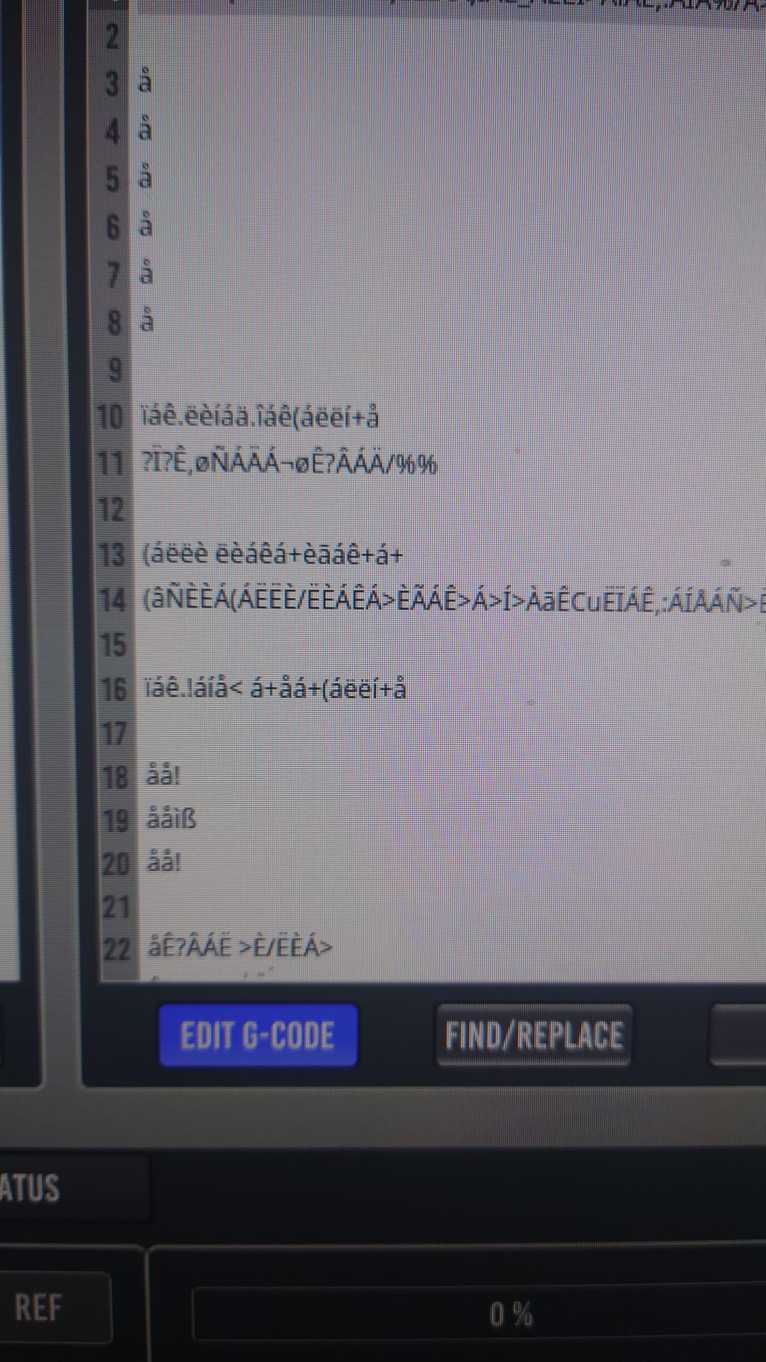

Hi folks,
did this appear to anyone of you in former times?
I'm fairly new to CNC and brandnew to LinuxCNC (MiniMill 2.9) and I needed a 'warmup_routine' for my machine, so I used the help of AI and generated a file to my purpose.
I imported the code to my Windows editor and saved the file as <name>.ngc.
I wrote shorter files on my own in g-code in advance, saved them, transfered them to the machine and opened them: they worked from the first second.
As I tried to open the g-code with the AI generated parts, I recieved absolute trashed characters in the code, the complete code was unreadable!
When I opened this file with the 'gedit' from Linux, everything looked fine...
Anyone of has some ideas, tipps or solutions?

Do not use windows editors or office suits for editing machine files.
Use simple text editors such as notepad on windows or mousepad, gedit, nano, geany, etc on Linux.

I tried Editor, Notepad++ and eq. all the same result!
Still trying to figure out what the problem is...
If I open the file with gedit from Linux, everything looks fine, but as soonas I change to LinuxCNC I have the same crap...
