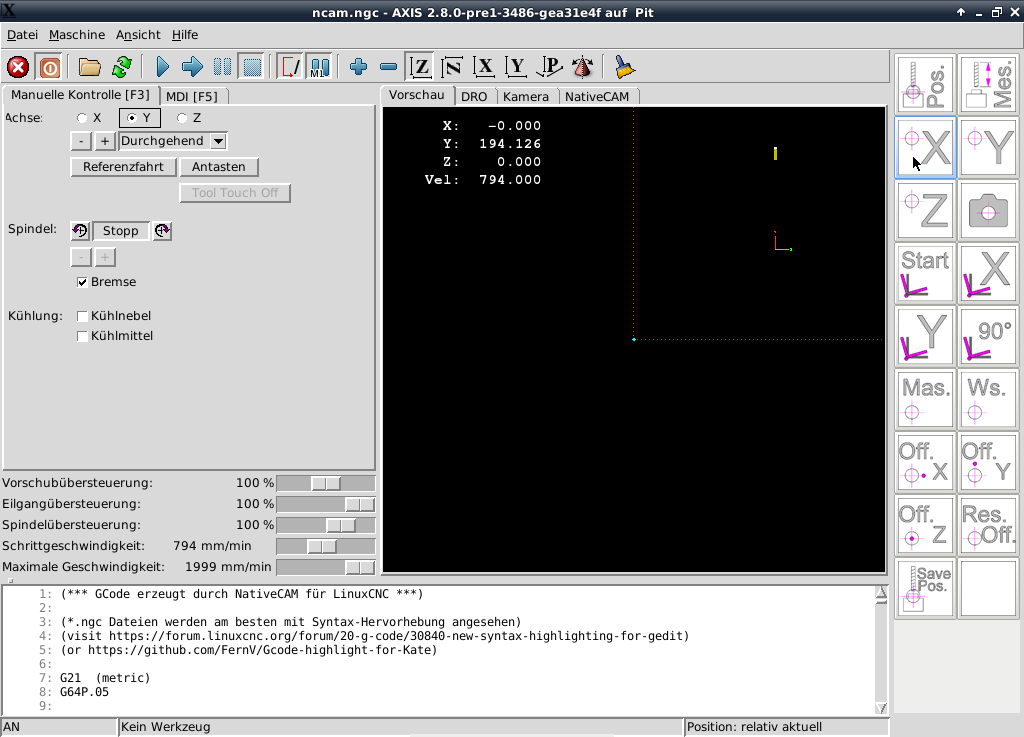

Hello,
i made a glade side Panel for axis which works fine:
Here is my problem:
If you move the mouse into the side panel while moving the machine with the cursor keys, the machine continues moving even if you let go of the key. This can only be stopped by moving the mouse out of the panel and pressing the cursor keys again. Is there a way to avoid this dangerous behaviour?
I attached the whole config (a lot of copy and paste in it :blush: )

26 Jan 2018 06:27 #105033 by +Jan+
Replied by +Jan+ on topic Glade Panel in Axis blocks arrow keys
No Idea? Maybe wrong Forum Category?

28 Jan 2018 17:07 #105127 by +Jan+
Hello Chris,
I`ve did some further tests:
- Testing the behaviour with standard sample glade configs: Same Problem
- Embedding the glade panel as tab: Same Problem
- Updateding from 2.7.11 to 2.7.12 and then to 2.8 Master: Same Problem
The ESC key works in all configurations.
I`ve found an old topic with about a very similar problem (no solution): forum.linuxcnc.org/48-gladevcp/28429-gla...widgets?limitstart=0
I'm grateful for every idea how this problem could be solved.
Best wishes
Jan

29 Jan 2018 03:40 - 29 Jan 2018 03:44 #105146 by +Jan+
Hello Chris,
thanks a lot for this comment.
I found the file (on my machine the path is /usr/lib/pymodules/python2.7/gladevcp) and did some modifications.
I tried to remove the whole ignore section:
    d = display.Display()
    fw = drawable.Window(d.display, forward, 0)
    ks = gtk.keysyms
    ignore = [
    def gtk2xlib(e, fw, g, type=None):
This leads to the following behaviour:
- Pushing the arrow key for x+ or x- , moving the mouse into the glade panel and then releasing the arrow key ==> release not detected
- Moving than with the mouse out of the glade panel and hitting the arrow key once again ==> release detected and machine stops
- Pushing x+ or x- arrow key, moving the mouse into the glade panel and then releasing the arrow key ==> RELEASE DETECTED!
- Then pushing the arrow key y+ or y-, moving the mouse into the glade panel and releasing the arrow key ==> release not detected
- Pushing y+ or y- arrow key, moving the mouse into the glade panel and then releasing the arrow key ==> RELEASE DETECTED!
- But then the release of x+ and x- is not detected anymore... and so on...
- For Z the behaviour is different: If I move the mouse into the glade panel the axis does not stop if I release the page up/down key, but the direction can be inverted while while the mouse is inside the panel (which is not possibile on the other axes).
For easier understanding I recorded the screen and logged the keys:
I do not need to move the axes while the mouse is inside the glade panel, but then the machine has to stop when I move into the glade panel. Any idea to reach this goal?
Best wishes
Jan
