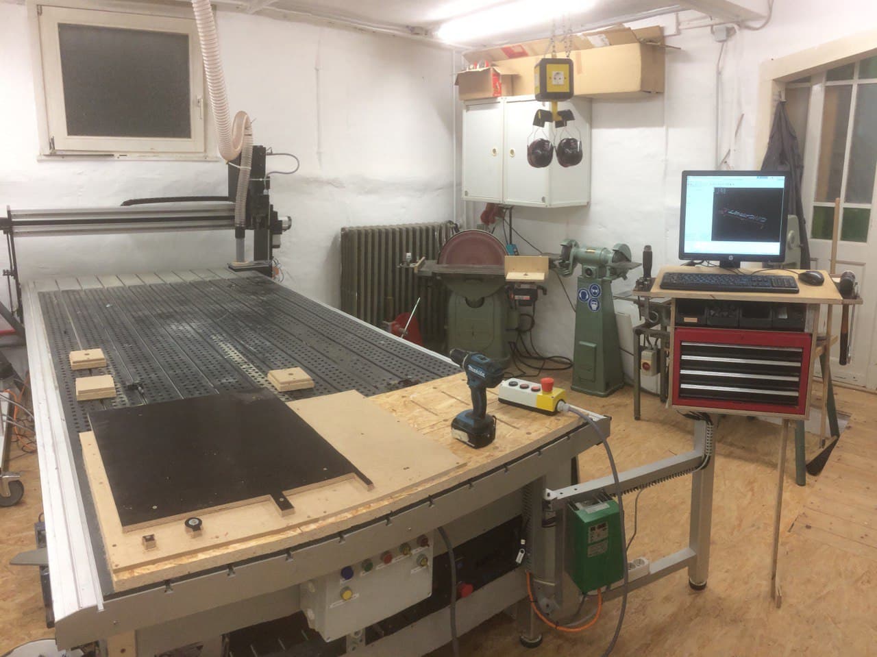

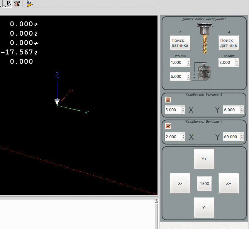

Hello,
three years later, I am facing the same problem again. I have a new machine which I run with Linuxcnc 2.8.2.
The Glade panel is still the same, and I use the XEMBED.py file we created for LinuxCNC 2.8 Master back then.
That's how the machine behaves:
- Pushing the arrow key for x+ or x- , moving the mouse into the glade panel and then releasing the arrow key ==> release not detected
- Moving than with the mouse out of the glade panel and hitting the arrow key once again ==> release detected and machine stops
- Pushing x+ or x- arrow key, moving the mouse into the glade panel and then releasing the arrow key ==> RELEASE DETECTED!
- Then pushing the arrow key y+ or y-, moving the mouse into the glade panel and releasing the arrow key ==> release not detected
- Pushing y+ or y- arrow key, moving the mouse into the glade panel and then releasing the arrow key ==> RELEASE DETECTED!
- But then the release of x+ and x- is not detected anymore... and so on...
I have again created a video with key logging and open terminal for debugging:
Here is the code of the Xembed file:
Where could be the error?
Thanks in advance
Jan

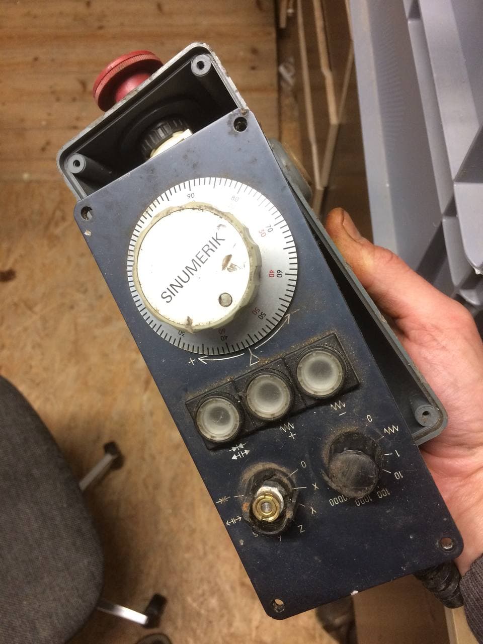

That would be a workaround, but not a good one. The machine is too big:
I need hardware keys which I can use without looking on them
The next step is then to put the electronic handwheel from the scrap back into operation.
Until then, however, I would like to keep the cursor keys. Do you have the same problem when using the hardware arrow keys?
Best wishes
Jan
Best wishes
Jan
12 Oct 2021 22:41 #222983
Replied by andypugh on topic Glade Panel in Axis blocks arrow keys
I think that the old pendant looks like too much work.
So, consider buying one of the XHC-type pendants that LinuxCNC already supports.
linuxcnc.org/docs/2.8/html/man/man1/xhc-whb04b-6.1.html
- Posts: 12156
- Thank you received: 4149
13 Oct 2021 01:20 #222992
Replied by rodw on topic Glade Panel in Axis blocks arrow keys
If its a standard MPG encoder and the axis selection and scales are hardwired , its quite easy to wire it into a Mesa MPG input (eg on 776e).
I use a 433Mhz wireless pendant with a receiver box that is all hardwired into a Mesa 7i76e. There is a MPG example in the docs which will guide you. I use binary coded inputs that output a logical bitmap which I decode to save a few pins.
