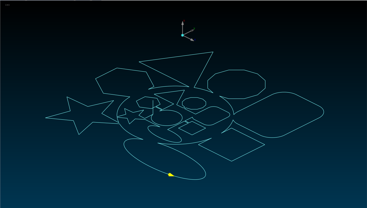

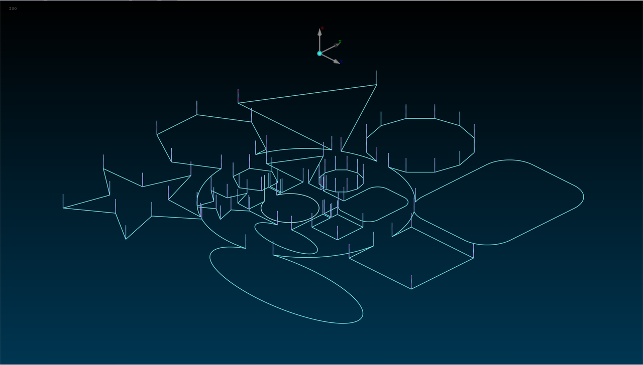

Hi Vre,
This for info. I hope you can use it.
The linuxcnc scurve planner has now tangential knife output value to hal.
The hal rotational output value could be coupled to a axis motor or device for rotation.
Within the the planner you can also benefit from the clothoid fillets, where the path
tends to be g3 continu, ideal for a drag knife application.

@Vre,
It's not in master at github linuxcnc. I use Codeberg to host source code.
It is in working state. But as always. It just needs testers, and feedback helps improve the final result.
