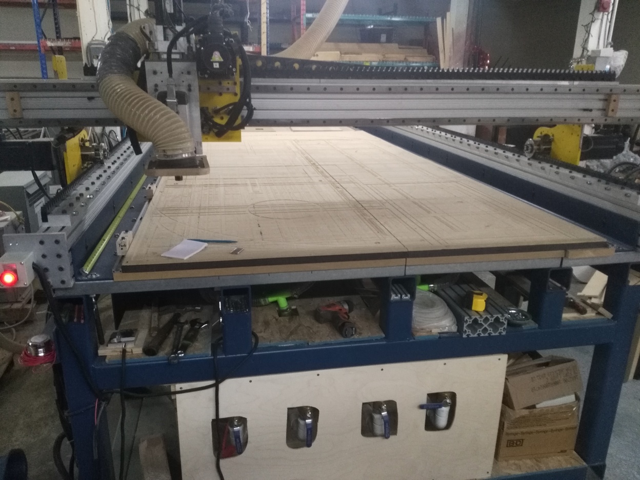

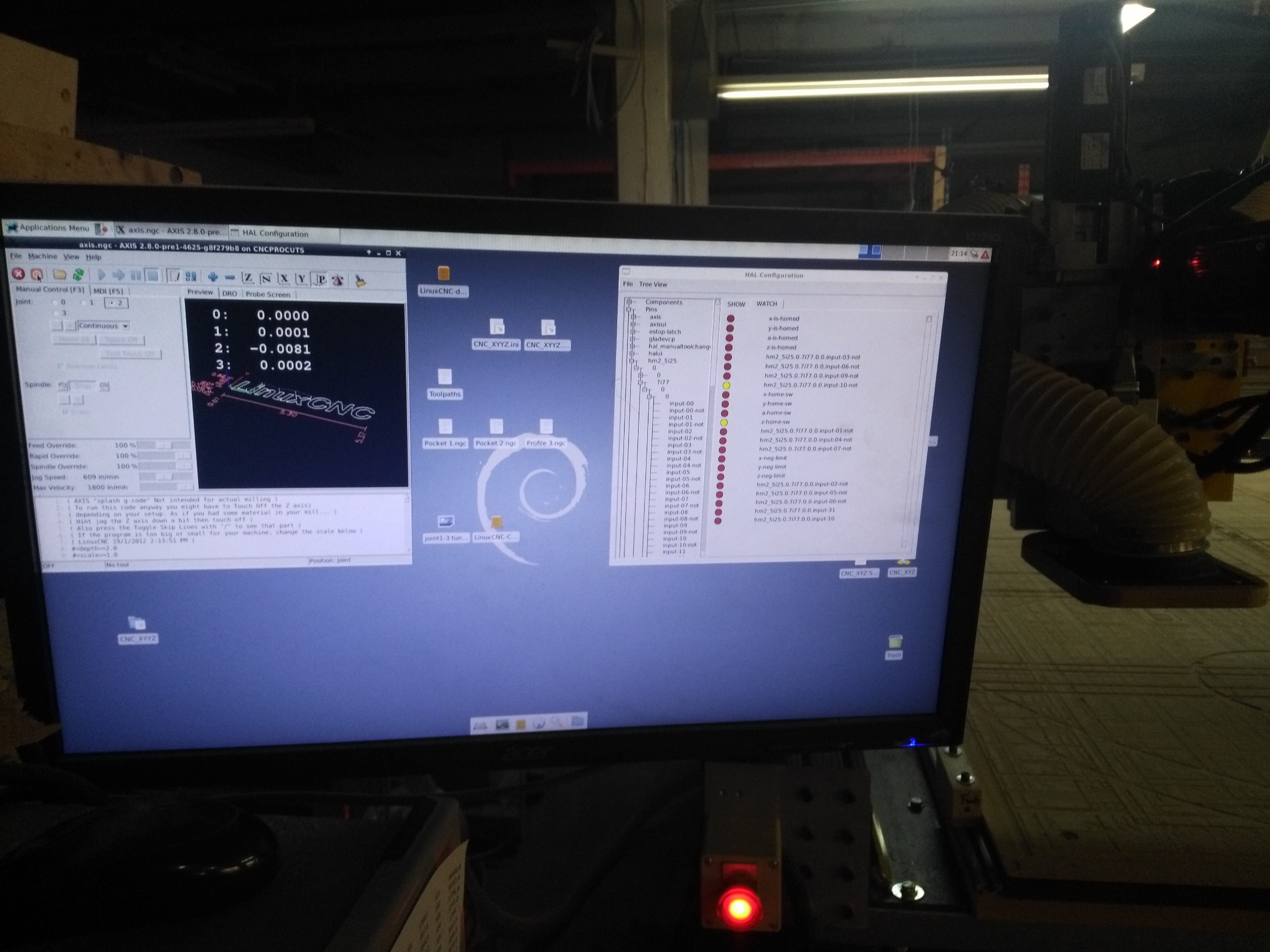

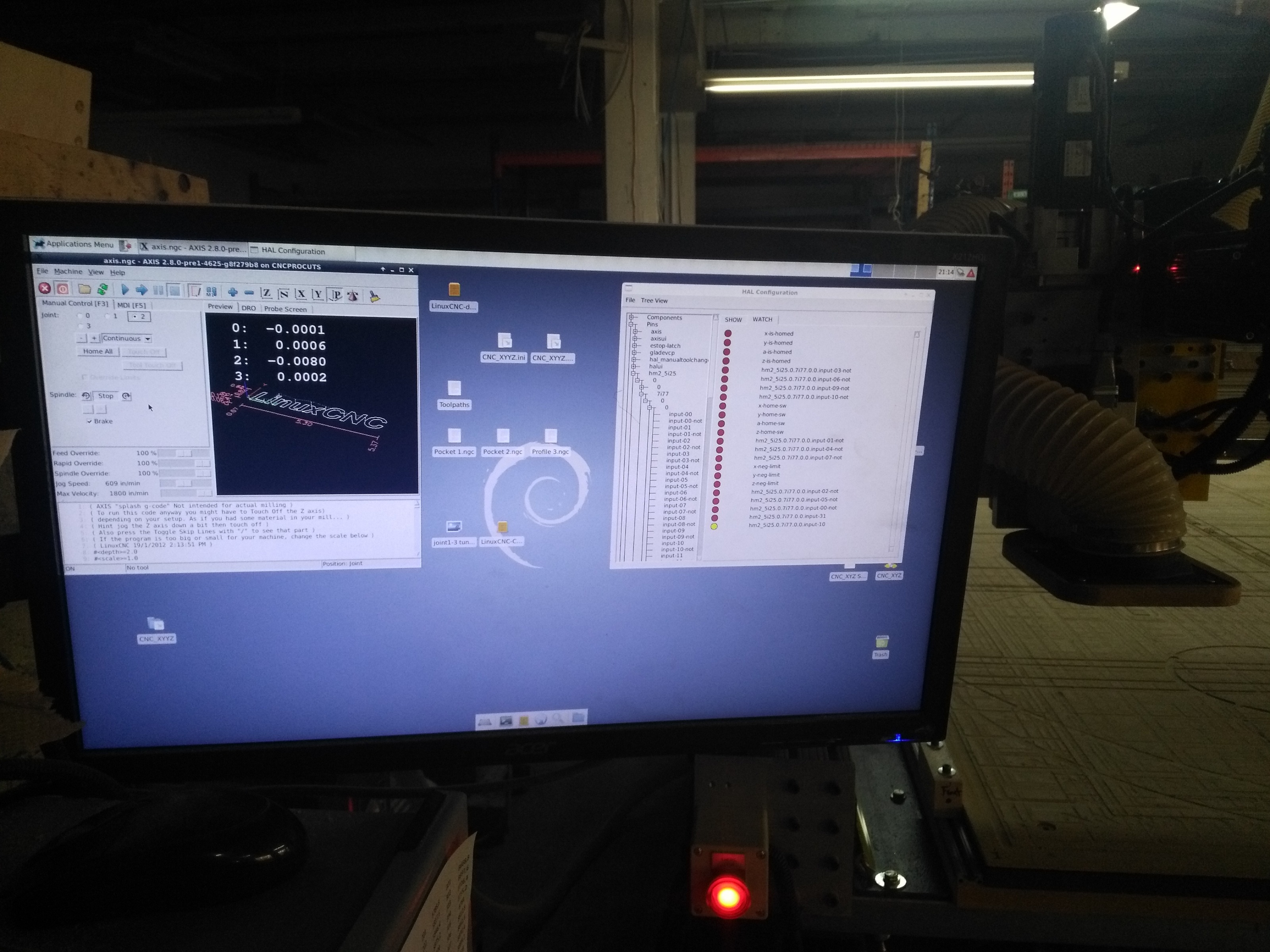

I have a weird intermittent bug that involves homing, and when I have this bug I cannot use the homing to square the table so the cnc becomes useless. Major bug.
It was working fine for 2 years but every once in a while had the bug … rebooted and restarted everything a couple of times and it re worked … now it is not …
I have trace it to the input of the 7i77 card and I was getting ready to displace them on the 7i84 … not remembering how to address it in HAL … for the axes limit switches … that I did and saw this …
Picture of drives not enabled … proximity sensors functioning and reporting
Picture of drives enabled … proximity sensors not working but the triple edge finder triggers … go figure …
On both pictures, the red dot at the top on the right side is the Z-Home that is triggered (the other red dot besides it is a reflection on the motor)
When the drives are not enabled, they appear functional; the HAL configuration WATCH screen has the hm2_5i25.0.7i77.0.0.input-07-not reporting live and correctly. All other input also work fine when the drives are not enabled.
The minute I put the drives ON … HAL configuration WATCH screen is dead on that input … whatever I do … the sensor trigs, the relay too, not the input … but the triple edge finder is responding … hm2_5i25.0.7i77.0.0.input-31 is still live and correct.
So when I put the drives ON, I loose proximity sensors … why …

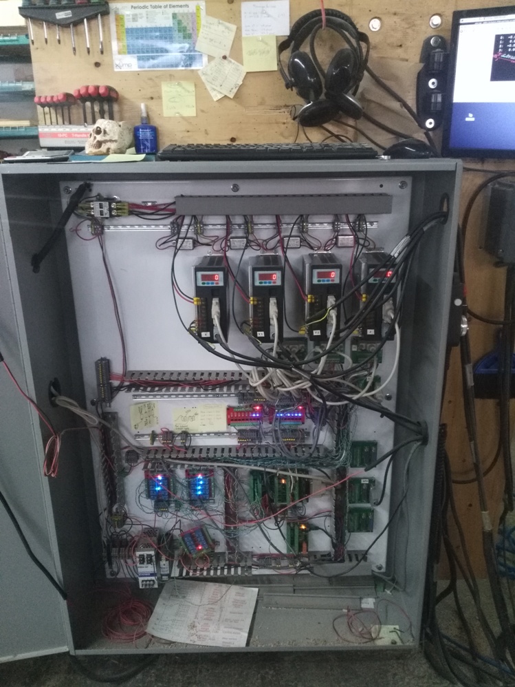

- Mike@CNCproCuts.com
- Posts: 15
26 Apr 2019 16:30 #131990
by Mike@CNCproCuts.com
Replied by Mike@CNCproCuts.com on topic Weird intermittent bug involving proximity sensors and homing
My drives are 1.8kw and all of them has noise filters. ground loops ? would a ground loop work for a while and then stop working ?
Hitting the stop button disables the drive and then all sensors work ... very weird to see things light up (when homing the Z and it does not react I use the E-Stop)
I'll include a picture of the control box ... give me a sec

- Posts: 21910
- Thank you received: 7466
26 Apr 2019 21:07 #132021
Replied by tommylight on topic Weird intermittent bug involving proximity sensors and homing
That looks like an imminent fire hazard !
As Todd mentioned, that is a noise issue form motor drives, and after looking at the pictures that is the first think to look into. Grounding problems can occur in many ways, but from experience the first thing to look at is : did you change the power outlet ?
