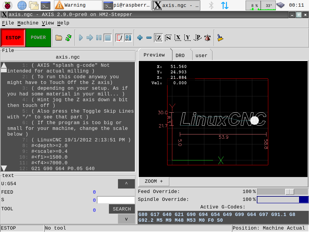

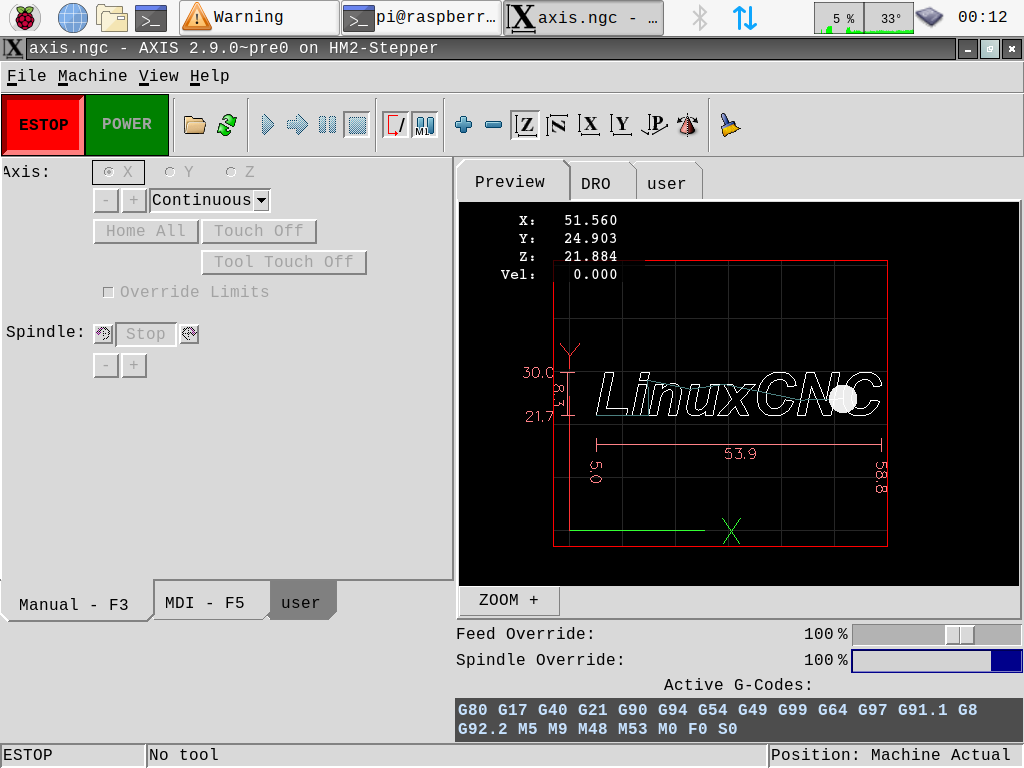

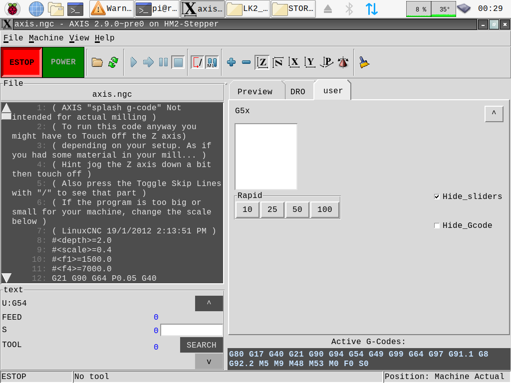

08 Dec 2020 20:30 - 25 Sep 2022 11:14 #191443 by zack
herewith example of touch axis in small factoreverything is scalableicons in usr/share/axis/imagesaxis.tcl in usr/share/axis/tcl etcaxis(py) in user/bin
Attachment not found

15 Dec 2020 01:05 #192009 by cakeslob
Replied by cakeslob on topic [solved]Axis for 800x480 screen w/ usercommand
almost missed that sneaky update, looks good with the panes vertical, it seems to be the best way to trim down on space but still be useable. ive been doing the same thing with my larger screen, its still rough though

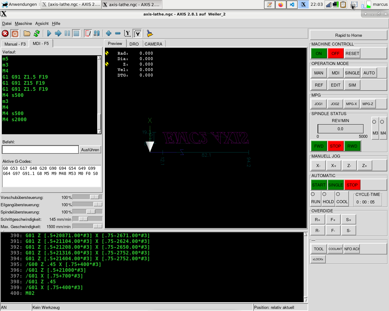

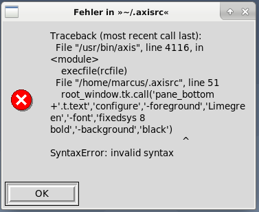

10 Feb 2021 11:43 - 10 Feb 2021 19:27 #198265 by Heisenberg
Replied by Heisenberg on topic [solved]Axis for 800x480 screen w/ usercommand
Is there any difference between an .axisrc or .py file?
I want to change the color of the background of the actual gcode and the mdi window from white to black, the font into green.
The examples from the linuxcnc page don´t work an it tells me always that "'.pane.top.gcodes'" dos not exists.
I tried to understand the code and i don't get how "'.pane.bottom.t'" , '.pane.top.gcodes' and all this belong together...
My configuration is linuxcnc 2.8.1 and its normal axis gui. I tried a little bit with an .axisrc file an but i am still walking in the dark...
Last edit: 10 Feb 2021 19:27 by Heisenberg. Reason: picture
12 Feb 2021 21:45 #198590 by cakeslob
I am also still in the dark. If you post your .axisrc file that would be helpful, cant tell from the error but maybe too many ' '

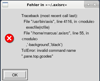

23 Feb 2021 21:13 - 23 Feb 2021 21:22 #199892 by Heisenberg
I have tried it an it works with the MDI history.
But I get still get an error message with the active gcodes.
I am using the german language, could it be that the error is because of the language pack?
Is there any way that i can read about which name belongs to a tab or is this just try and fail?

24 Feb 2021 05:39 - 24 Feb 2021 05:49 #199927 by cakeslob
my apologies, that change to modal seems to be only in master, for 2.8 it should be this
#modal text
root_window.tk.call('.pane.top.tabs.fmdi.gcodes','configure'
,'-foreground','limegreen'
,"-font","mono 8 bold"
,'-background','black')
this is a list of the widgets from the axis.py file

i cant explain very much because i barely grasp the concept
.pane - main(?)
.top - top pane (preview and manual/mdi), bottom pane (.bottom) is gcode
.tabs - refers to the left tabs Manual and mdi, .right refers to the preview and dro
.fmdi - the mdi tab, the .fmanual manual tab , when using a notebook widget(tab thing) it adds an f to the tab name, part of b widget
.gcodes - the tk text widget for the modal gcodes, .gcodel is the tk lable wiget for the "active gcodes" text

24 Feb 2021 08:57 #199942 by phillc54
Replied by phillc54 on topic [solved]Axis for 800x480 screen w/ usercommand
You can find widget info with something like the following in .axisrc
Just make the widget you need info about equal my_widget then you will get a list of children and available options.
Warning: Spoiler!
