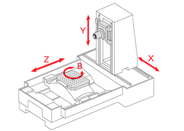

Hi how to make a view for a milling machine with a horizontal Z axis? By default, we have vertical Z and I need the view to be like on the machine, i.e. horizontally www.steckermachine.com/hs-fs/hubfs/Blog/...g?width=600&name=CNC -Machine-Axis-1.png.
I added the Lathe mode in INI but then I can not see the 3D image (there is only a top view) and I have a rotating C axis in the Z axis and I would like to see it in 3D like here forum.linuxcnc.org/media/kunena/attachme...-11-01at18.21.58.png
I tried to rotate the view manually, but it also does not work because it only allows you to rotate it by certain angles, so it is impossible to set the detail on the left side and the horizontal Z axis. Is it possible to set the view for such a machine?

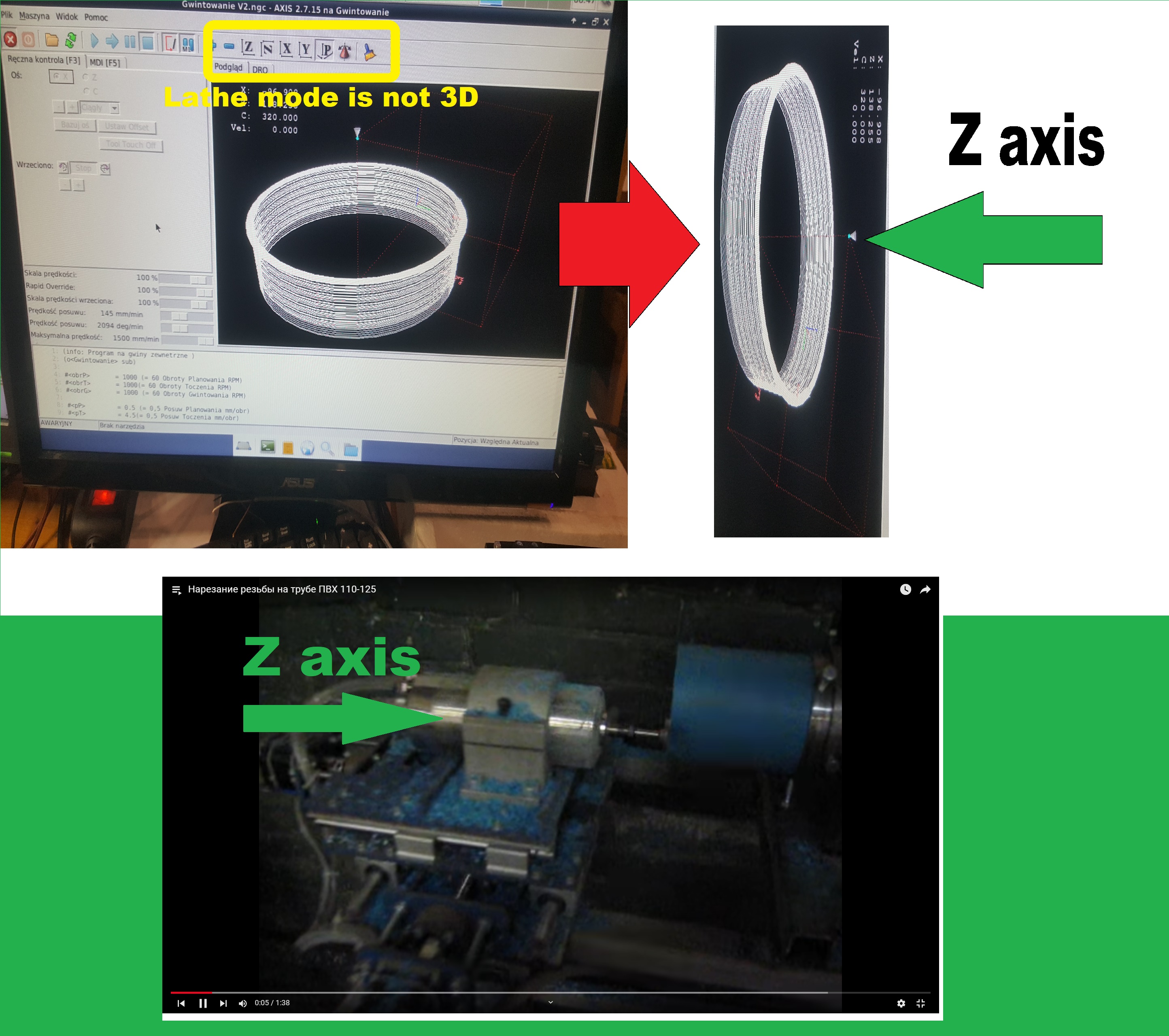

I'm trying to do something like in the video
The Z axis is horizontal and this is the view I would like to have the C axis wraps around the Z axis
The lathe view / mode does not have a 3D view option, it is only a top view and you cannot see what the machine is doing
https://www.forum.linuxcnc.org/21-axis/44499-how-do-i-rotate-a-coordinate-system-z-axis-horizontal-milling-machine#gallerywww.forum.linuxcnc.org/21-axis/44499-how...ling-machine#gallery

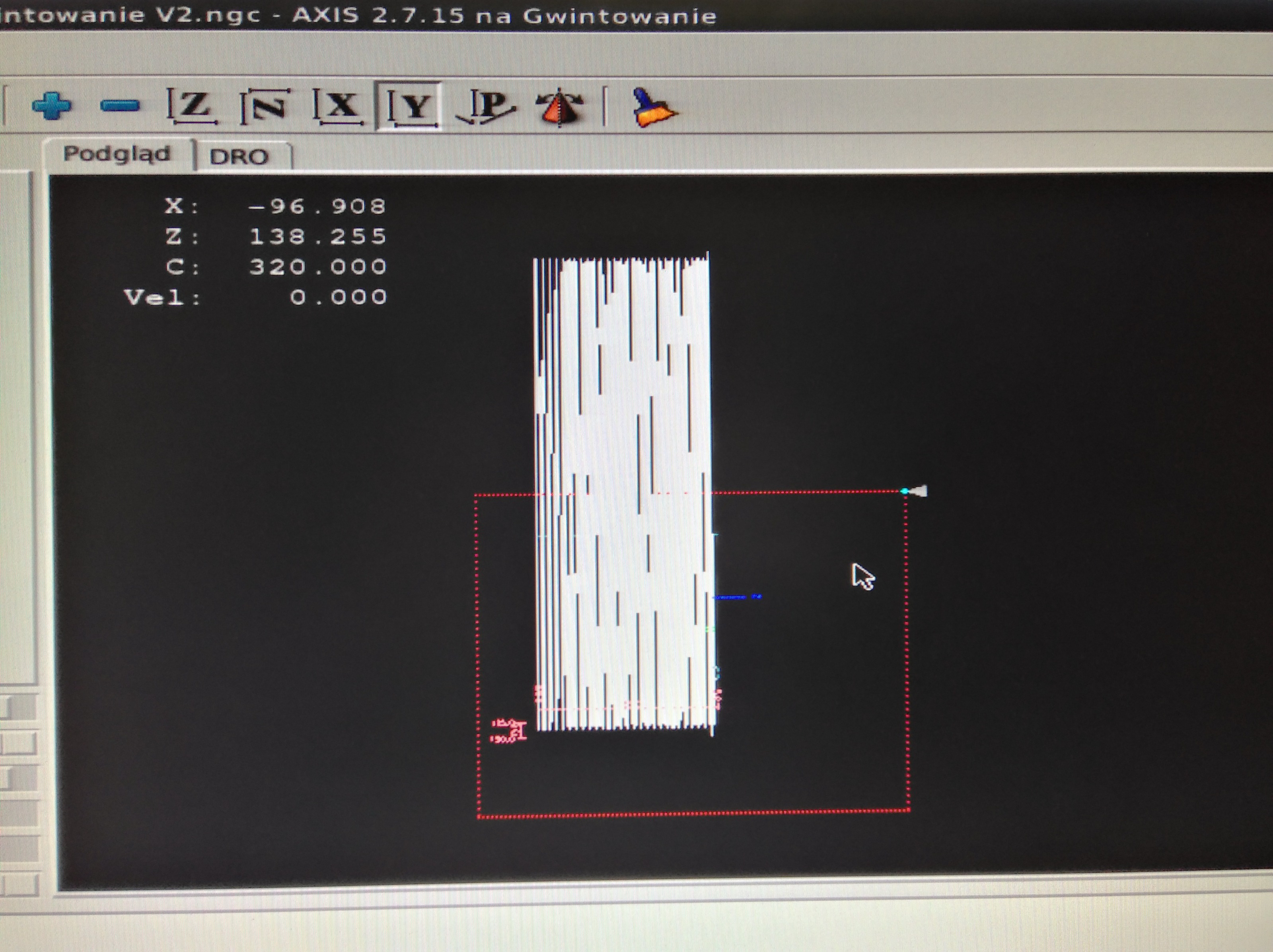

What I pasted is a real view of my G-code on the pipe. As you can see, this is a standard view with a vertical Z www.forum.linuxcnc.org/21-axis/44499-how...ling-machine#gallery . I want linuxCNC to run horizontally with the Z axis view like a real machine (that's why I pasted an image rotated 90 in "Paint" to show how I want to see the detail).
There is no problem with the C axis wrap around Z view, it works OK.
Even by hand, you can't rotate the view the way I want - Just linnuxCNC doesn't allow you to rotate the view at will - it has some frame encoded, limiting this freedom in the direction I need.

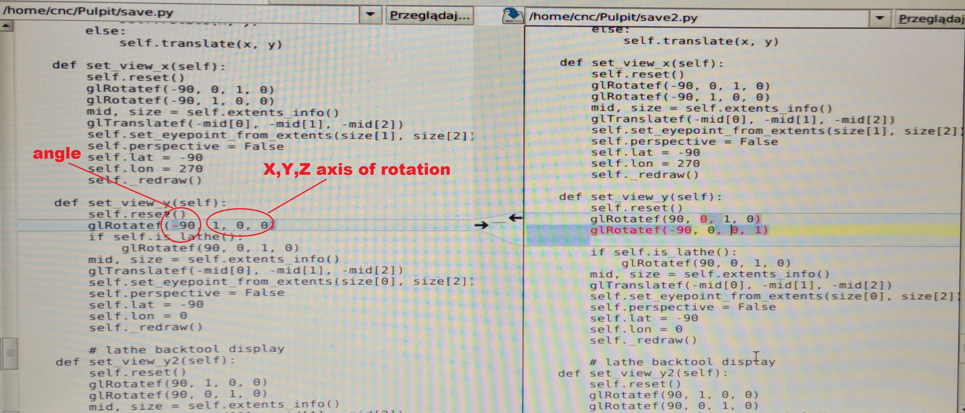

I have experimented with changing the z2 view definition in glnav.py.
I haven't got what I wanted, but I think it can be done.
With a stock 2.8 installation the file is /usr/lib/python2.7/dist-packages/glnav.py
I tried changing the "Z2" view, to do this you need to edit line 386. The glRotatef(() line here:
As this is a system file you will need to use sudo to edit it. I used "sudo geany" from the command line to open the editor with the right privileges.
glRotatef is documented here:
www.khronos.org/registry/OpenGL-Refpages...1/xhtml/glRotate.xml
With some clearer examples here:
community.khronos.org/t/glrotatef/14062/2
You might need to rotate in two stages to get the view you want (which is why there are two rotates in the sample above)
You need to save the .py file then re-open LinuxCNC to check the result.
def set_view_z2(self):
self.reset()
glRotatef(-90, 0, 0, 1)
glRotatef(45, 1, 1, 0)
mid, size = self.extents_info()
glTranslatef(-mid[0], -mid[1], -mid[2])
self.set_eyepoint_from_extents(size[1], size[0])
self.perspective = False
self.lat = 0
self.lon = 270
self._redraw()As this is a system file you will need to use sudo to edit it. I used "sudo geany" from the command line to open the editor with the right privileges.

Thank you for your help, you led me well
LinuxCNC 2.7.15 file is /usr/lib/pymodules/python2.7/glnav.py
glLoadIdentity()
tx, ty, tz = mat[12:15]
glTranslatef(tx, ty, tz)
glRotatef(snap(lat), *w.rotation_vectors[1])
glRotatef(snap(lon), *w.rotation_vectors[0])
glTranslatef(-xcenter, -ycenter, -zcenter)
w.lat = lat
w.lon = lon
def set_view_y(self):
self.reset()
glRotatef(90, 0, 1, 0)
if self.is_lathe():
self.set_eyepoint_from_extents(size[0], size[2])
self.lat = -90
self.lon = 0
self._redraw()
# lathe backtool display
