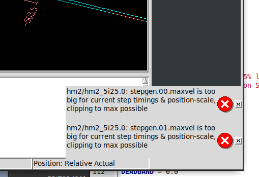

I have a strange behavior from axis, as it seems to ignore the values entered in my ini file, and replace it with bogus ones.
It takes sometimes a dozen tries to get the machine moving at the right speed / acceleration, and more than often , the X limit returns an error while Axis shows the position still moving.. . It eventually runs perfectly after a while, until next reboot...Sometimes however , all the 3 axis are affected.

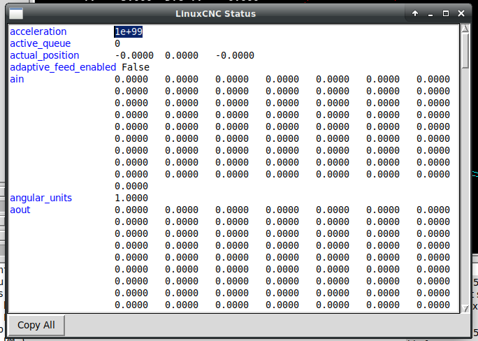

But LinuxCnc status displays a ridiculously high acceleration value (99 digits) that I can't find in any of file.

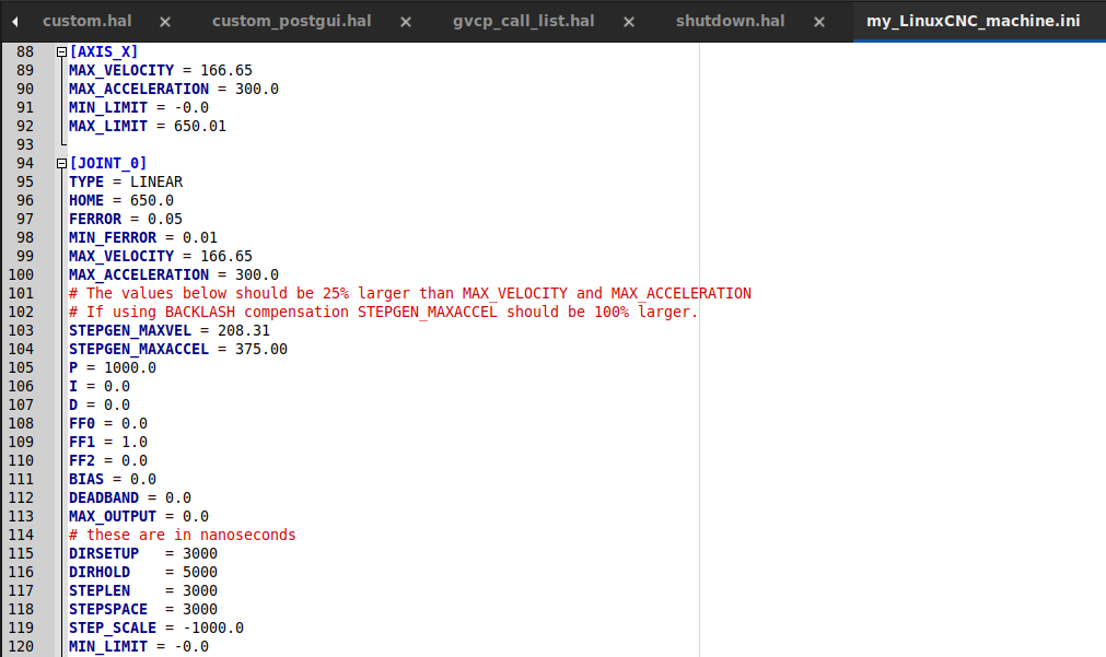

The error (as LinuxCNC reports in the first image) is that you have a velocity that
is impossible to reach with the specified step timings.
In your .ini file, you have a step time of 3000 and a step space of 3000 ns which
allows a maximum step rate of 166.666 KHz but you have STEPGEN_MAXVEL set to
208.31 and a STEP_SCALE of 1000 which means a maximum step rate of
208.31 KHz must be possible.
To fix this you must either shorten the step timings or lower the joint and stepgen velocities
(the 1+99 accel in the status display is not the joint limit and probably represents
a status readout bug which is harmless)

Obviously adding 25% to the maximum value was NOT the best idea..
