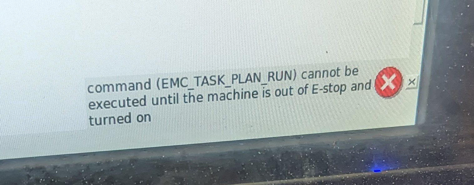

I am have a problem when loading up AXIS. I am getting an error "command (EMC_TASK_PLAN_RUN) cannot be executed until the machine is out of E-stop and turned on." We recently replaced the 5V power supply because the program was not recognizing the hm2_7i43 board due to the bad power supply. Anyone have an idea on how to fix this?

Does the error come up when starting LinuxCNC whithout touching anything?
If yes, usually a stuck key on keyboard, of interference from bad grounding/shielding.
