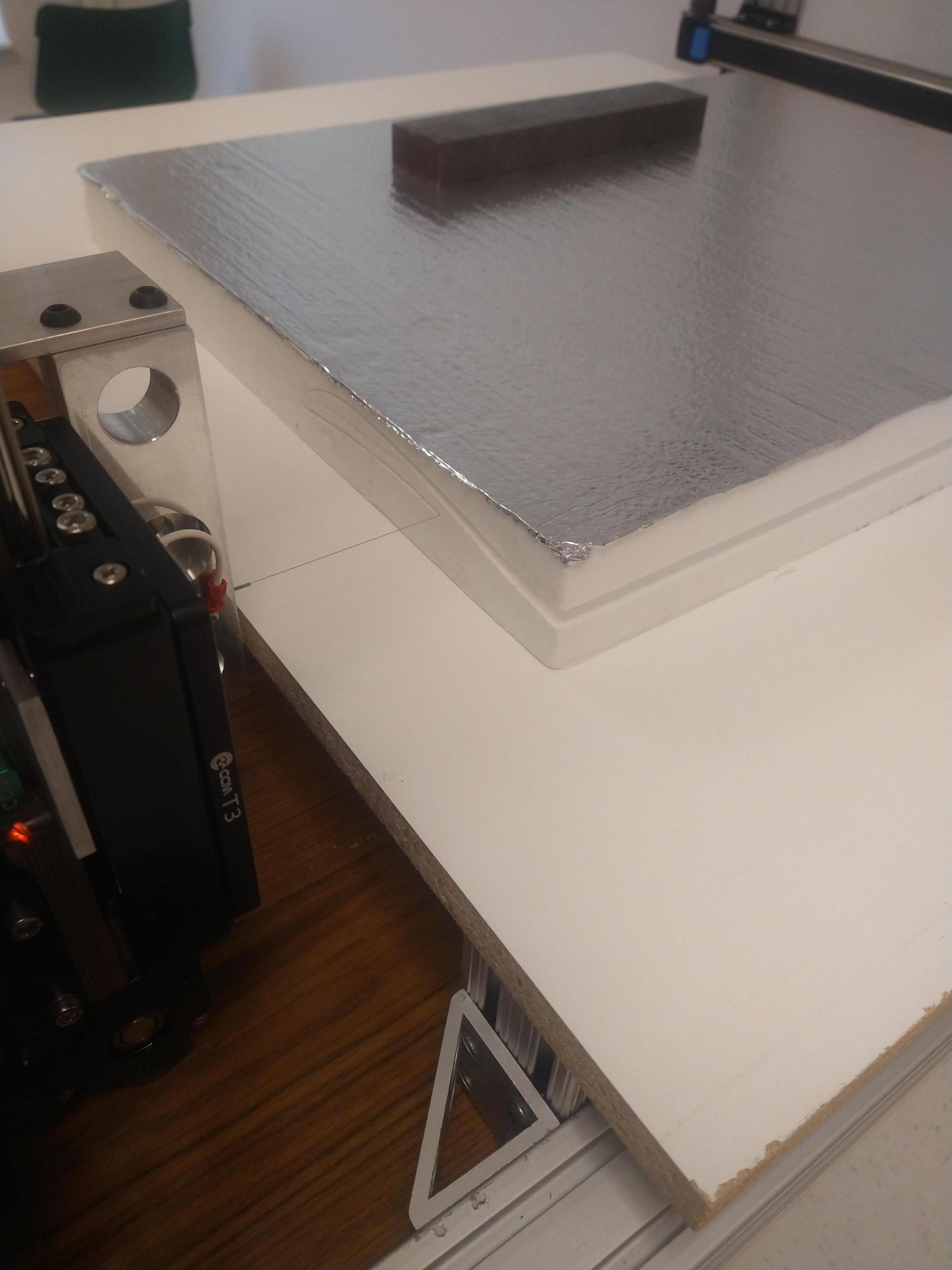

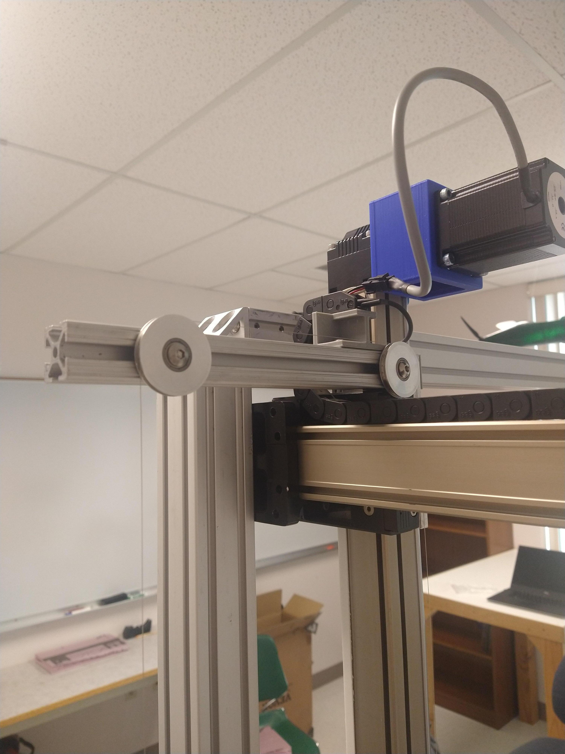

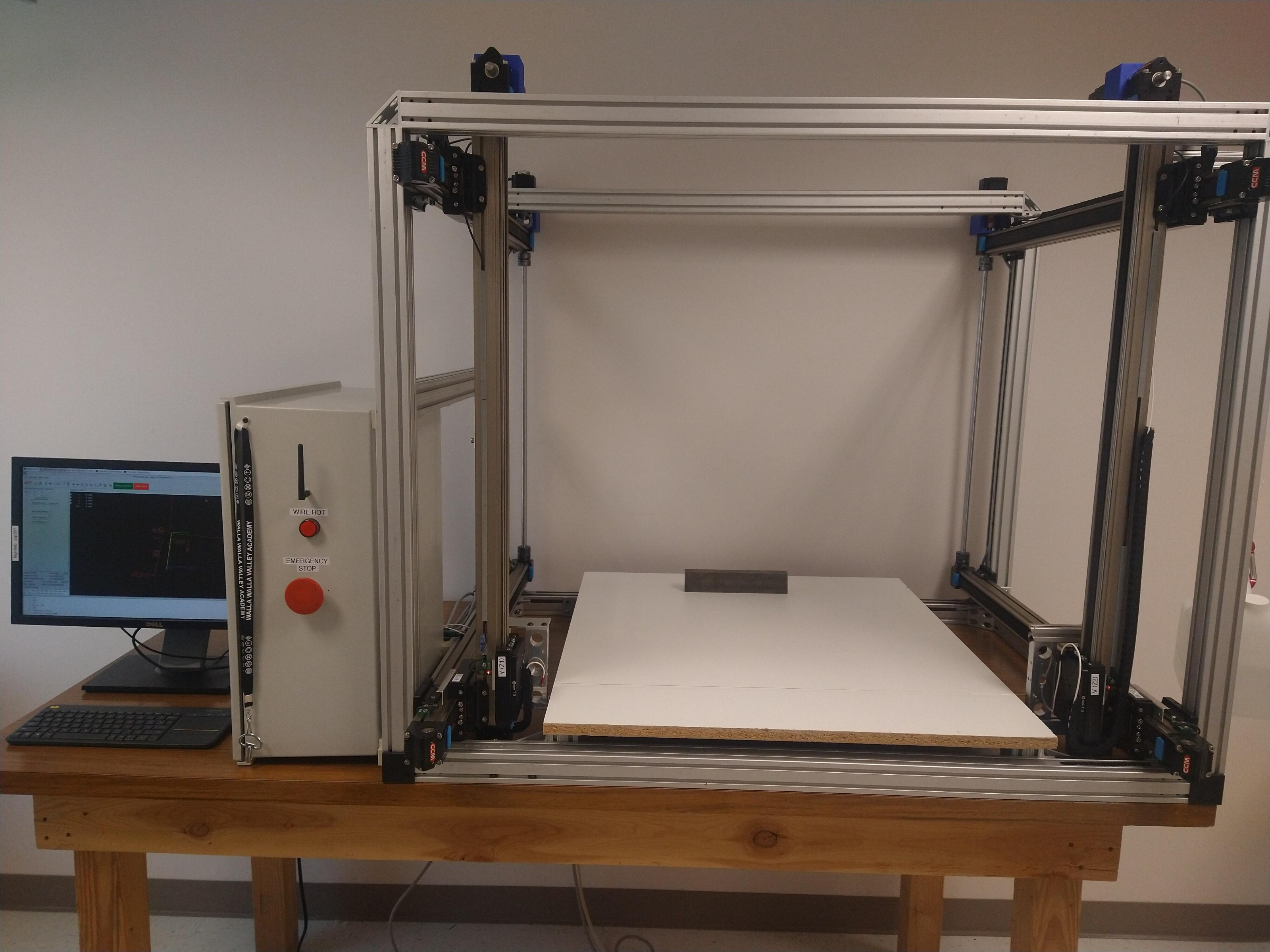

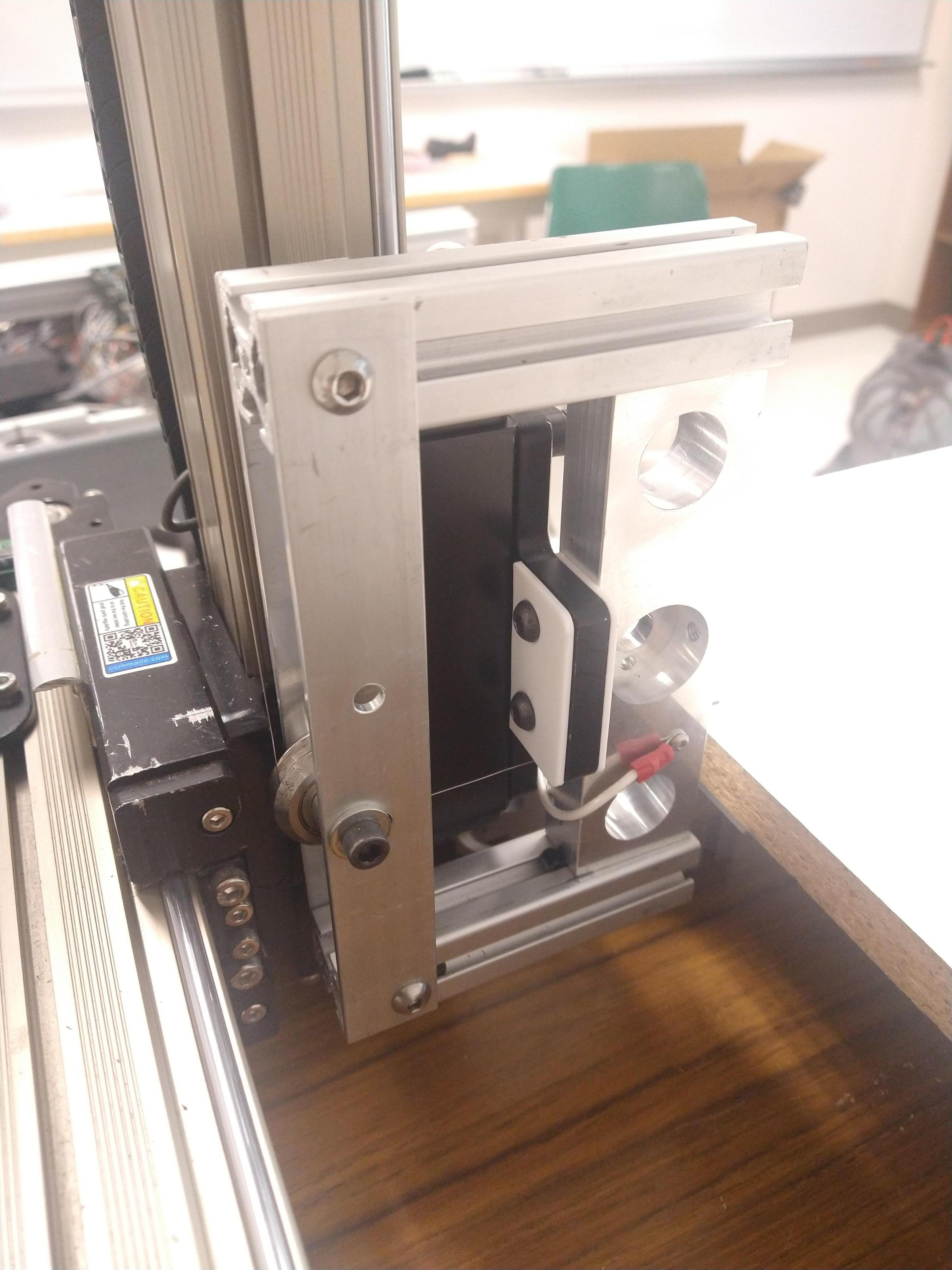

I have a rebuilt 4-axis foam cutter working with 2.9.3, but I would like to change how it is displayed in Axis. The default display is XY; UV, with the wire vertical. In reality, the axes are YZ; VW, with the wire horizontal. I have tried changing all occurrences of XYUV to YZVW in the axis_foam.ini simulation, which does not give any error messages, but no change is visible in the Axis preview. It still shows the UV plane above the XY plane with the wire between.
Any suggestions on how to achieve this?
