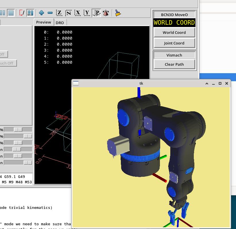

Add Tab to Axis View Pane

If you use Qtvcp to render the vismach panel, you can embed it with a command such as this:
[DISPLAY]
# Embed tabs
EMBED_TAB_NAME= qtscreen
EMBED_TAB_COMMAND= halcmd loadusr -Wn qtvcp_embed qtvcp -d -c qtvcp_embed -x {XID} vismach_mill_xyz
linuxcnc.org/docs/stable/html/gui/qtvcp-vismach.html
[DISPLAY]
# Embed tabs

I switched over to Qt Vismach for the display. The panel is created and works, it just doesn't embed. The sim runs, its just that I get the following errors at startup.
Replied by Project_Hopeless on topic Add Tab to Axis View Pane
Is the variable vismach_mill_xyz generic or should it reference a specific file in my sim?cmorley post=309070 userid=482If you use Qtvcp to render the vismach panel, you can embed it with a command such as this:
[DISPLAY]
# Embed tabs
Traceback (most recent call last):File "/usr/lib/python3/dist-packages/OpenGL/latebind.py", line 43, in __call__return self._finalCall( *args, **named )^^^^^^^^^^^^^^^^^^^^^^^^^^^^^^^^^TypeError: 'NoneType' object is not callable During handling of the above exception, another exception occurred: Traceback (most recent call last):File "/usr/lib/python3/dist-packages/qtvcp/lib/qt_vismach/qt_vismach.py", line 255, in paintGLself.drawObjects()File "/usr/lib/python3/dist-packages/qtvcp/lib/qt_vismach/qt_vismach.py", line 325, in drawObjectsself.hud.draw()File "/usr/lib/python3/dist-packages/qtvcp/lib/qt_vismach/primitives.py", line 898, in drawself.fontbase, self._width, linespace = use_pango_font(self._font, 0, 128)^^^^^^^^^^^^^^^^^^^^^^^^^^^^^^^^^^File "/usr/lib/python3/dist-packages/qtvcp/lib/qt_vismach/primitives.py", line 66, in use_pango_fontGL.glBitmap(1, 0, 0, 0, 0, h-d, bytearray([0]*4))File "/usr/lib/python3/dist-packages/OpenGL/latebind.py", line 47, in __call__return self._finalCall( *args, **named )^^^^^^^^^^^^^^^^^^^^^^^^^^^^^^^^^File "/usr/lib/python3/dist-packages/OpenGL/wrapper.py", line 700, in wrapperCallraise errFile "/usr/lib/python3/dist-packages/OpenGL/wrapper.py", line 693, in wrapperCallresult = wrappedOperation( *cArguments )^^^^^^^^^^^^^^^^^^^^^^^^^^^^^^^File "/usr/lib/python3/dist-packages/OpenGL/platform/baseplatform.py", line 415, in __call__return self( *args, **named )^^^^^^^^^^^^^^^^^^^^^^File "/usr/lib/python3/dist-packages/OpenGL/error.py", line 230, in glCheckErrorraise self._errorClass(OpenGL.error.GLError: GLError(err = 1285,description = b'out of memory',baseOperation = glBitmap,pyArgs = (1,0,0,0,0,23.0,<OpenGL.arrays._buffers.Py_buffer object at 0x7fb250c629f0>,),cArgs = (1,0,0,0,0,23.0,<OpenGL.arrays._buffers.Py_buffer object at 0x7fb250c629f0>,),cArguments = (1,0,0,0,0,23.0,<OpenGL.arrays._buffers.Py_buffer object at 0x7fb250c629f0>,)) Please Log in or Create an account to join the conversation.

What version of linuxcnc are you using?
vismach_mill_xyz is a builtin example panel. Use it to check that embedding works.
You would need to adapt your Tk based panel to Qr it's not too much work but there are no how too examples.

version 2.9.2.What version of linuxcnc are you using?

Just to confirm it works, try the sim config: axis/qtvcp/qtvismach_tab
you should get axis with a sample vismach in the tab.
