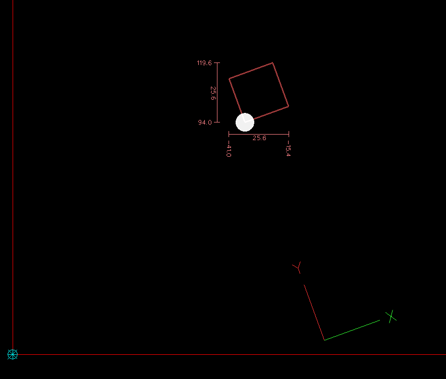

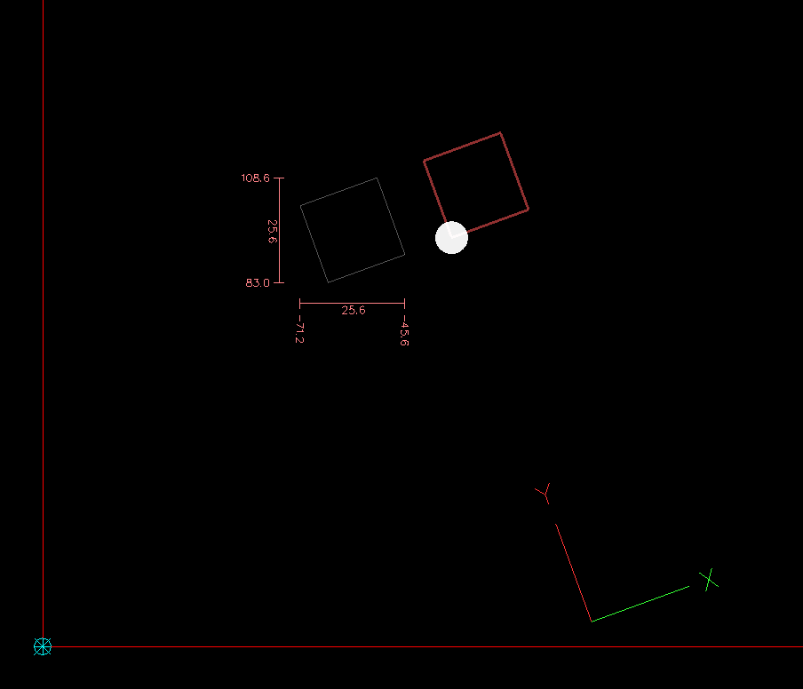

I have this preview problem in Axis:
There is a rotation:
In the routine:
This gives a displaced preview:
The problem only occurs, when 1 axis use current absolute position, the other axis moved to position in current ucs, and a rotation R set.
If both X and Y positions are set by G55 X100 Y100 or G53 X100 Y100 or if rotation is set to zero, preview works perfect.
- G10 L2 P2 R20
In the routine:
- G0 G55 Y100
- #<MX> = #<_x>
- #<MY> = #<_y>
G1 G55 X#<MX> X#<MY> F1000
X[#<MX> + 20]
Y[#<MY> + 20]
X#<MX>
Y#<MY>
M2The problem only occurs, when 1 axis use current absolute position, the other axis moved to position in current ucs, and a rotation R set.

I have the same issue. I tried to rotate the G54 coordinate system slightly to account for a slightly misaligned part fixture. However, the G10 L2 P1 R1 command moved the origin around like described above. I would assume the coordinate system would be rotated around the origin of the respective coordinate system, thus not moving the origin. I could manually set the origin in the rotated coordinate system and then preview and movement of the machine were like expected.
