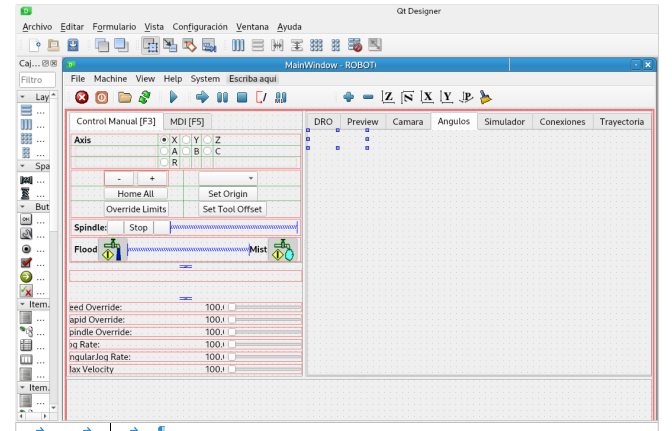

Hi. I am a little bit confuse about working with your own Panels.
I modified the AXIS.ui with this panel ROBOT.ui
Se image 1. ROBOTui
Basically, I only added 6 tab windows

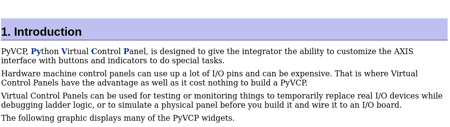

Then, as in the documentary PyVCP says it must be included in the INI I did it.
See image 2 PyVCP

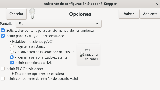

But when I run again the Linux Stepconf to include the changes I find a place where I should add custom panels.
See image 3 Stepconf
In conclusion I don´t know where I have to place my custom ROBOT.ui that is an AXIS.ui modified.

The instructions in the manual are what you should follow for building or modifying a configuration.
Stepconfig, is a wizard application for creating basic machine configurations. It asks you questions and you fill in the answers about your machine config, then it builds the configurations files (*.hal, *.ini ...) for you. The end result being a set of machine config files that might work for you, or be a stepping off point giving you a framework to create a more complex configuration from.
PS once you've created a config using one of the wizards, if you make manual hand modifications to the config files, do not try to make changes using the wizards. Because the wizards do not look at the existing config files for info, any previous changes to them will be lost and overwritten. (They work from other files that are not used for running Linuxcnc.)

Looks like you are using Qtaxis?
Looks like you are modifying the screen rather then embedding a custom panel?
You would need to follow Qtvcp docs for Qtaxis modifications. I can help once you confirm what you are doing.

I used Qt 5 Designer to modify Qtaxis.ui
Through these new 5 tab windows I will add some widgets to each tab window. One will have a Camera, another a simulation of the robot made in FreeCAD, etc.
Any help would be many steps forwards. Thanks a lot.
