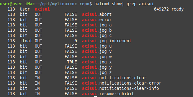

This should work for 2.8 and up, notice the hal command at the end for refreshing the Gremlin (plotter).
Replied by tommylight on topic How to refresh the Axis screen after setting offsets G10 L20
G10 L20 P0 X0 Y0 \ %halcmd setp axisui.refresh 1Please Log in or Create an account to join the conversation.
- Posts: 4819
- Thank you received: 2177
01 Jun 2025 04:29 #329500
Replied by Aciera on topic How to refresh the Axis screen after setting offsets G10 L20
- Posts: 22036
- Thank you received: 7504
01 Jun 2025 08:23 #329509
PlasmaC uses it, i have it on several machines in daily use, so might be there....
Just checked the 2.10 on this PC, not there either...

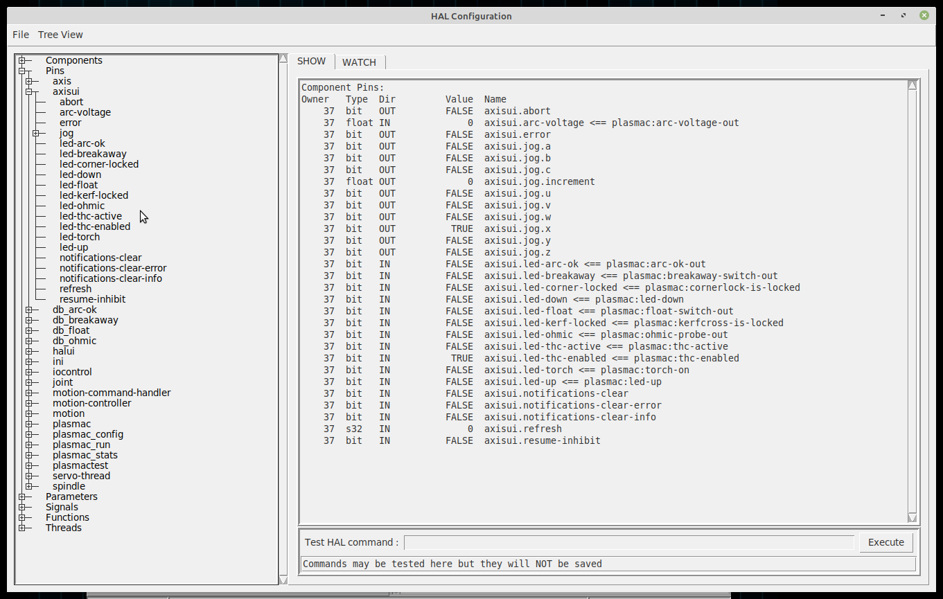

- Posts: 22036
01 Jun 2025 09:13 #329511
- cakeslob
- Posts: 927
- Thank you received: 280
04 Jul 2025 20:48 #331292
by cakeslob
Replied by cakeslob on topic How to refresh the Axis screen after setting offsets G10 L20
yeah its a pin phil added in the plasmac usercommand file
github.com/LinuxCNC/linuxcnc/blob/master...c2/plasmac2.py#L5689
