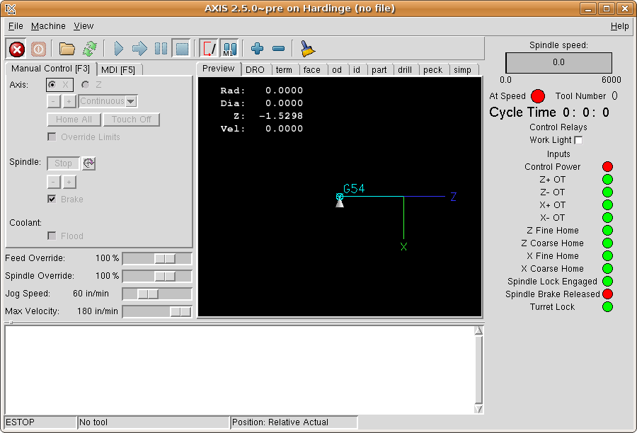

Axis Tabs was created by BigJohnT
Dewey Garret has a cool ngcgui that can now be embedded into the tabs of Axis.
README has instructions and download info:
www.panix.com/~dgarrett/ngcgui/README
