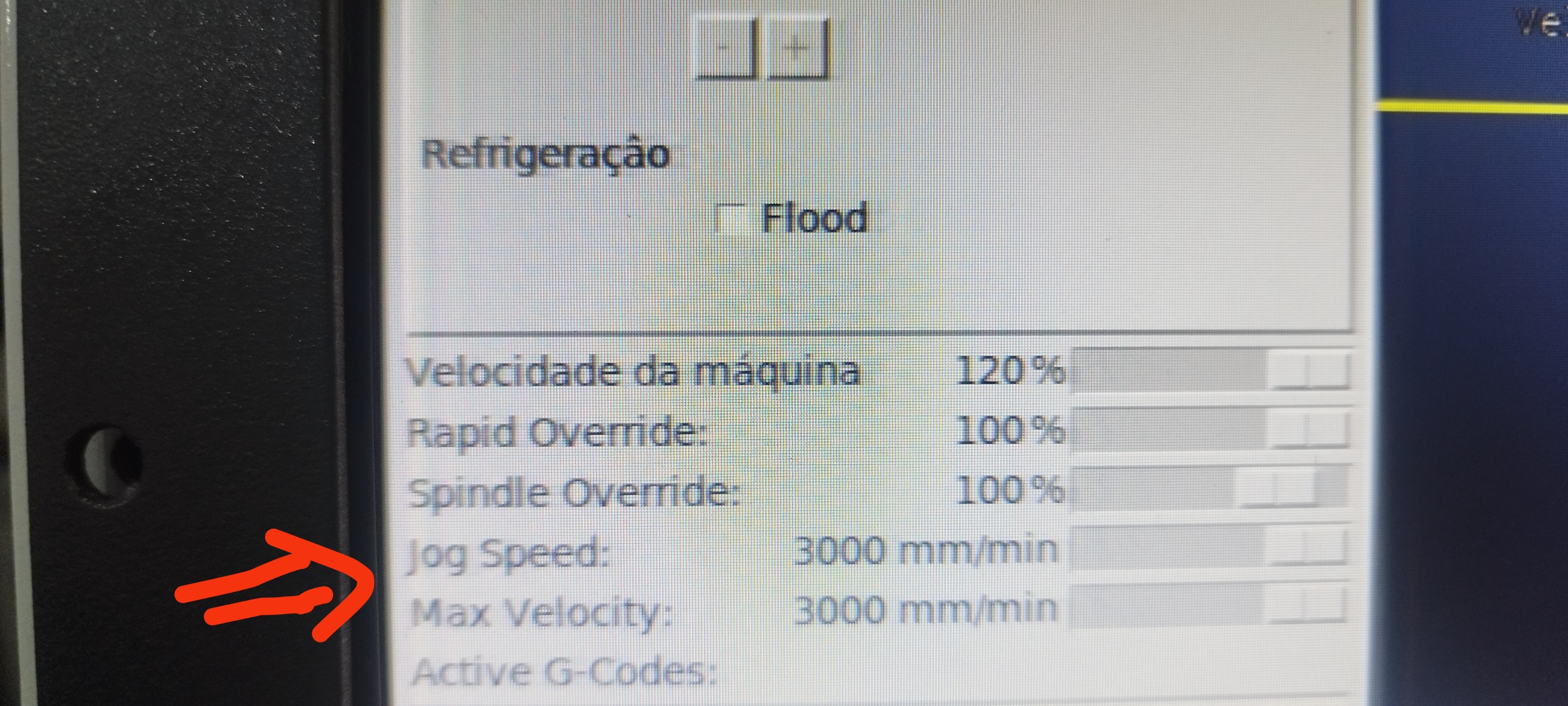

Hi guys, I'd like to know how to read the value of the jog speed component as shown in the attached image.

You can read the values for any of these controls, except for the jog speed control. :(
