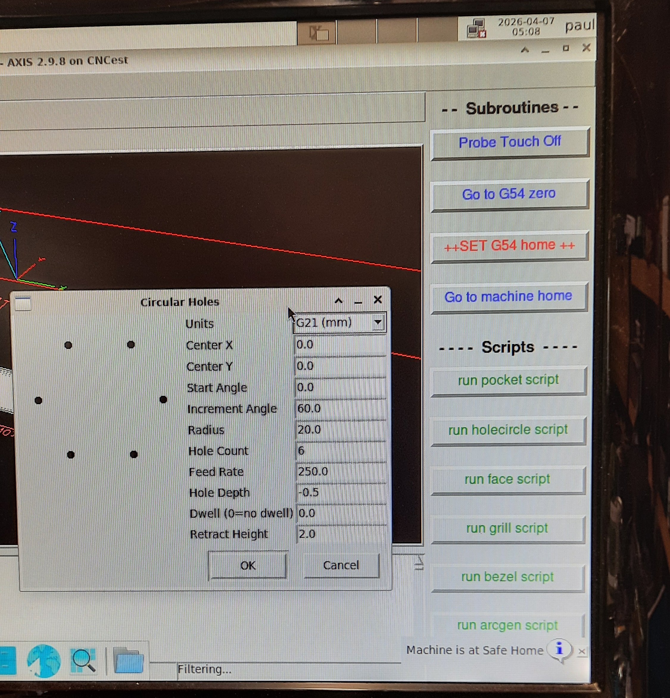

I am a new user of a few months with linuxCNC and AXIS and  found a resource of several Python scripts to use in Axis but many of them failed to work as most where created many years ago and not for use in Python3 so I fiddled and tweaked until they did then I enhanced some and created some others for my own use to save having to go to CAD to make toolpaths and run from a button on the sidebar in Axis.
Would these be of any interest I am willing to share (not knowing how to is an issue :) ). ADMIN...Unsure if this is the correct place to post this if not please let me know and either move to somewhere else or delete.

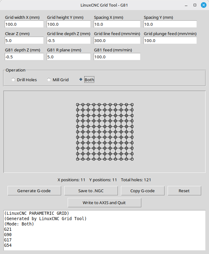

First Python3 script "linuxcnc_grid_tool_G81_axis.py" this can be run eother from within axis and loads toolpath directly into axis or from desktop using python on Geady or terminal and save to .NGC file.
The script I use to engrave a grid on my sacrificial MDF machine bed and drill fixing holes at grid intersections
I have 12 scripts in total available to upload and also 5 subroutines i can upload them individually or as a zip.

I have added a zip file containing subroutines and python scripts I use on Axis I have them listed below some I have made and others I have tweaked to work in Python3 (not all needed doing).
Contained in Python Scripts Folder
    Engrave.py              A script to create a single line of text.
    Ruler.py                A script to generate a ruler with markings.
    Bezel.py                A script to create a rotary scale with or without number markings.
    Contour.py              A script to enable creating toolpaths on a variety of shapes Circle,oval,rectangle,slot,polygon and path with a range of modifiers.
    Face.py                 A script to generate toolpath to cut a defined area.
    Grill.py                A script to generate a set of holes for a grill in a variety of shapes with user definable settings.
    Holecircle.py           Script runs from within linuxcnc to create toolpath to drill holes on a PCD.
    Grid_G81.py             Script to drill a grid of hole or mill a grid of lines or both useful when creating sacrificial work beds on a router.
    PresetG54.py            Script to create a preset file for G54 offset.
    Pocket.py               Script to create toolpaths to cnc machine round and rectangular pockets.
    pcd_hole_circle.py      Script to generate toolpath to drill holes on a PCD or save as a csv file.
Subroutines
Contained in the Subroutines folder
     g54_here.ngc           Sets G54 offset at current position
     go_to_home.ngc         returns tool to G54 x and y position after raising Z
     safe_g28.ngc           Sends the tool back to absolute machine home after raising Z
     z_touch.ngc            simple subroutine to set Z height with a touch probe
