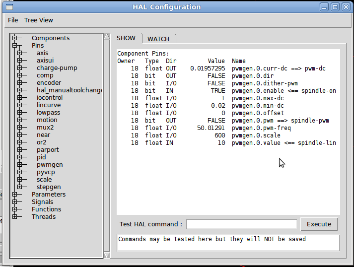

I found strange behaviour of PWM in my machine.
The PWM config is this:
loadrt pwmgen output_type=1
addf pwmgen.update servo-thread
addf pwmgen.make-pulses base-thread
setp pwmgen.0.pwm-freq 50.0
setp pwmgen.0.value 0.02
setp pwmgen.0.dither-pwm true
setp pwmgen.0.enable true
net spindle-pwm <= pwmgen.0.pwm
And I except that I got pulse every 20 msec.
But that's not true. I got 10 pulses every 20 msec, and then is silence around 250msec long!
I was thinking that dither does that but with setp pwmgen.0.dither-pwm false is same output.
I got correct output if I set setp pwmgen.0.value 0.05 or if I change base period from 25000 to 30000.
what happens there?!?
Here is screenshot and log file from hal.

16 Jan 2014 01:38 #42841 by eslavko
Replied by eslavko on topic Strange PWM
One more thing...
Just look that's parameters!
curr-dc is 0.019
min-dc is 0.02
the difference is just way too big to be rounding errors...
And for information the pwm works as should at base period of 18us. (but system is little slow then) seems that around 20 and 27us is some sweet spot where pwm does malfunct! :sick:

16 Jan 2014 16:44 #42868 by eslavko
Today I change computer and got same result. :ohmy:
After long examination I discovered that it's not linuxcnc problem but my.
After pwmgen I have OR gate to force PWM high if I want to override speed controll. and this seems like this
loadrt or2 count=2
addf or2.0 servo-thread
net spindle-pwm => or2.0.in0
net spindle-full => or2.0.in1
net spindle-pwmx <= or2.0.out => parport.0.pin-01-out
And in halscope indeed I see alliased result as Andy suspect! But close match I see in real scope tied on pin too so I was think is not alliased.!
But alliasing in halscope is caused as I sample at servo period (I can't sample long enought in base period to see that), but real scope on pin get's alliased result as I run OR2 gate in wrong thread (servo) instead (base). So aliasing ocour in OR2 gate. (works like mixer)
After moving OR2 to base thread all thing works normal...
...fell so stupid... :evil:
