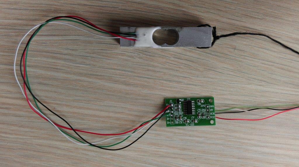

HI,
Here is hal modul for communication with ADC HX711. I want to use it for setup tension on cutting wire through PID and servo motor.
Martin
Martin

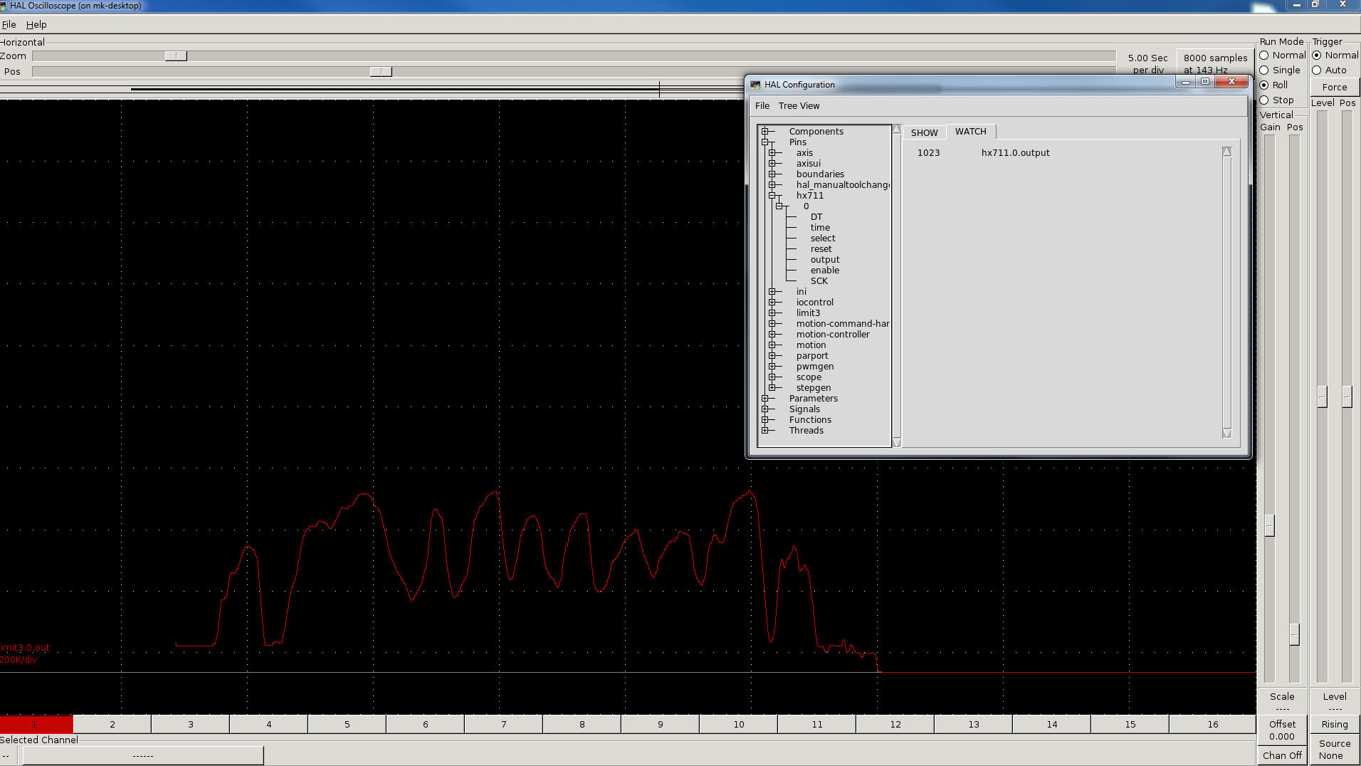

HI,
I tried add some description and change variable u32 to unsigned.
here is new hx711.comp
Martin
and some picture
Martin

}and some picture
Last edit: 25 May 2015 14:50 by fupeama. Reason: change float to unsigned in output value
