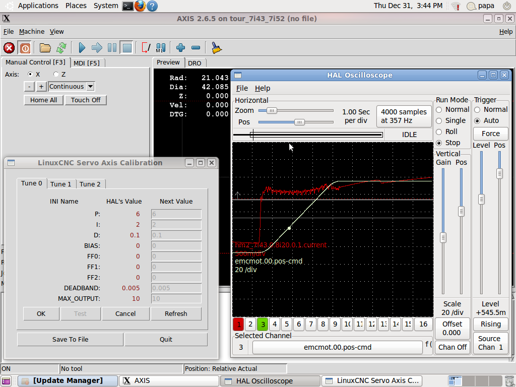

Hi all,
Quick reminder I have a 7i43 + 7i52 + 8i20 and a used servo motor, as I stated in my last post I haven't the technical information of the motor.
After several tests I managed to get the following details about it:
When I'm using the AXIS UI to jog a bit (ie. 5 mm) I can see that the current (as reported through hal meter) is around 0.7 Amps but also I noticed that the current is always increasing when the motor is in stand-bye up to ~5Amps and then AXIS disconnect it.
Current related parameters for the 8i20 are :
I don't think that it's normal can you confirm ? If not normal what can/should I do
I'm attaching the .ini and the .hal files (there is a cleaned version that didn't contains all my comments)

I started to monitor the emcmot.00.pos-cmd and pid.x.error, I noticed that the error was diminishing very slowly when the current was increasing in absolute value (at what seems to be a plateau in the pos-cmd) I started to wonder if the deadband parameter was not too demanding for my configuration or my motor. When I reduced it to 0.05 the current was not increasing anymore soon after reaching the plateau for the command.
According to the documentation it seems that it should be at least 10 times smaller given the resolution of the encoder (if not more).
I'm attaching the scope of the current before and after reaching the plateau of the command, we can see that the current starts to increase (I'm not very skilled at halscope and I'm not able to capture a trace for a long period).

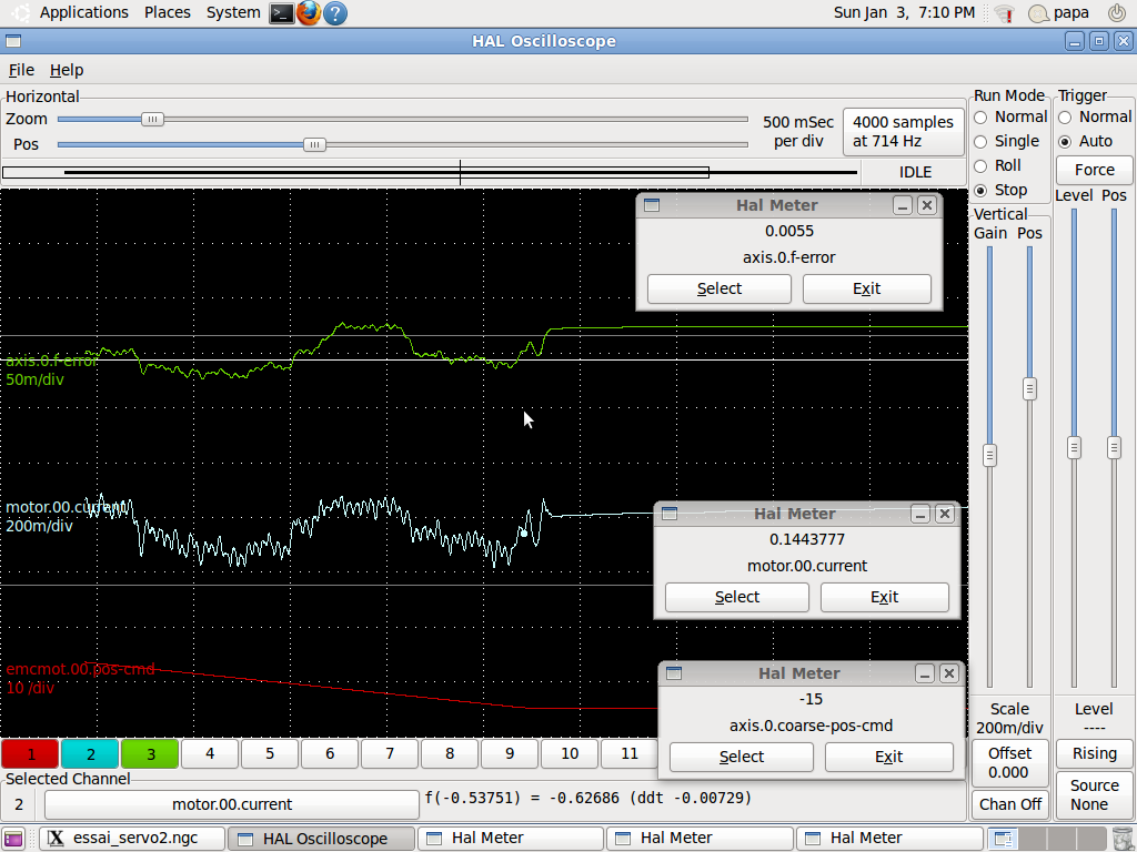

can you plot the following error at the same time?

Hello Peter,
Find attached the new graph with the error added.
