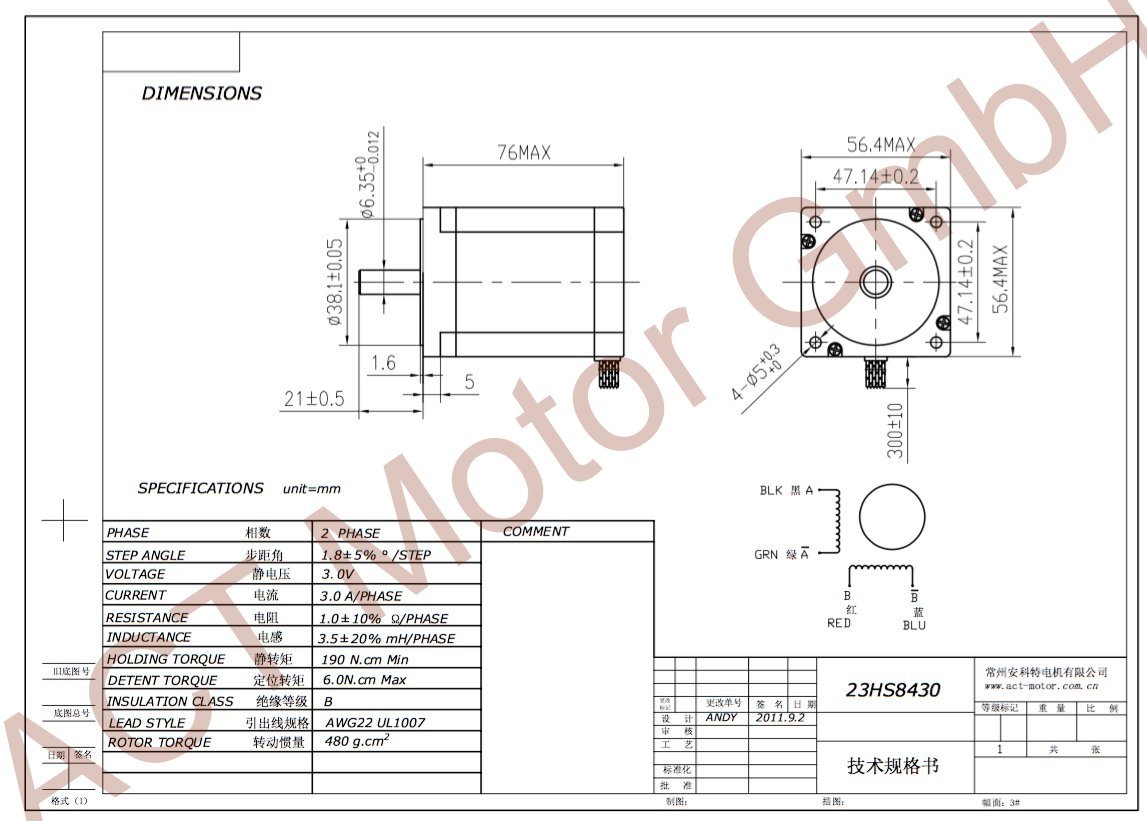

To be honest, I am also a bit unsure whether I connected the motor to the EL7041 in the correct way,
as the labeling is different between my old parallel port based step motor amplifier(A+ A- B+ B-) and Beckhoff(A1, A2, B1, B2).
As motor for testing, I use a 23HS8430
Datasheet: images-na.ssl-images-amazon.com/images/I...LTncpIL._SL1147_.jpg
The old connection layout was as follows:
B- = RED
B+ = GREEN
A- = BLUE
A+ = YELLOW
Regards,
Hawkeye

#net z-home-sw-in => axis.2.home-sw-in To be honest, I am also a bit unsure whether I connected the motor to the EL7041 in the correct way,
B- = RED
B+ = GREEN
A- = BLUE
A+ = YELLOW
Regards,
Hawkeye
