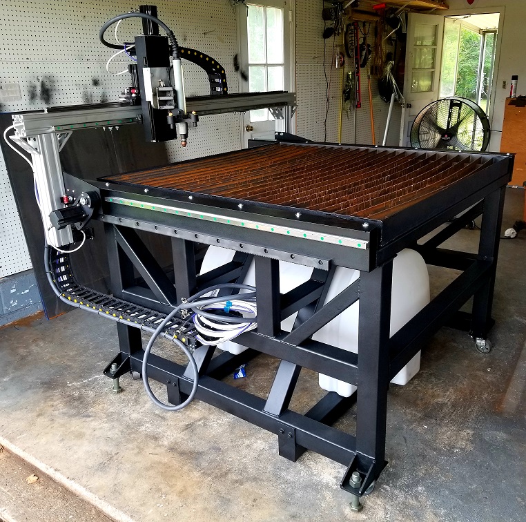

Attached a pic of my latest table build. 4'x4' Plasma

The upper left side of your machine looks very sharp in first sight. But in overall your picture is very good in first sight.
Many users are afraid to post pictures. It is only good to post pictures. For me you did a good hardware job !!!

And yes, it is a nice machine. Well done!
