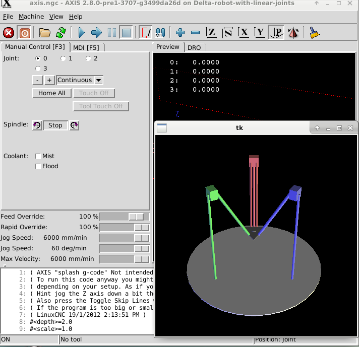

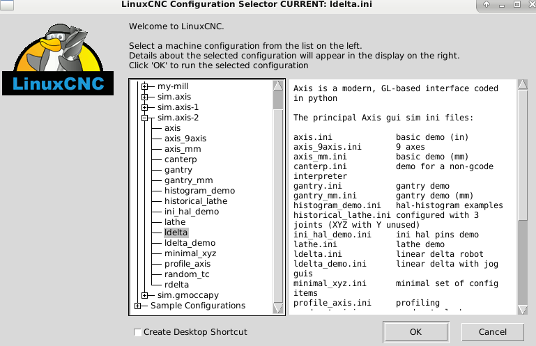

This file already exists in linuxcnc. I have tested this with 2.8 pre
In 2.8 pre lineair delta is available
Maybe this short hal file sample can help you :
# core HAL config file for simulation
# first load all the RT modules that will be needed
# kinematics
loadrt [KINS]KINEMATICS
#loadrt lineardeltakins
# motion controller, get name and thread periods from ini file
loadrt [EMCMOT]EMCMOT servo_period_nsec=[EMCMOT]SERVO_PERIOD num_joints=[KINS]JOINTS
loadusr -W lineardelta MIN_JOINT=-420

thanks,
I just had to upgrade to master
thank you very much
