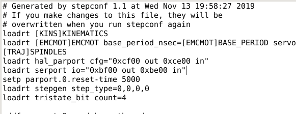

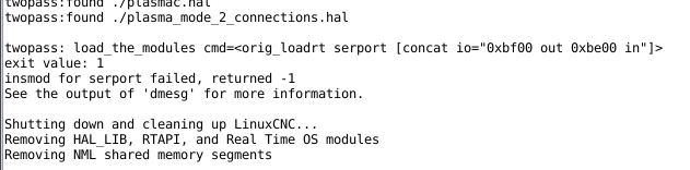

Serial port addressing was created by bright
- Posts: 19899
03 Dec 2019 00:50 #151797

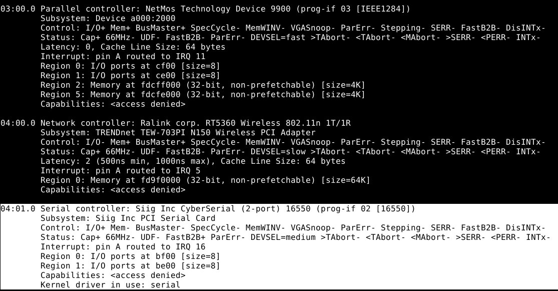

Replied by andypugh on topic Serial port addressing
You might have to prevent the kernel serial driver loading.
Try running "modprobe serial" before running LinuxCNC.
(use lsmod to see if there actually is a serial driver loaded)
