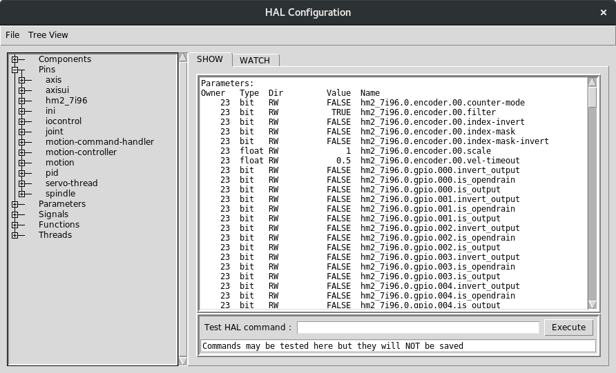

04 Dec 2019 08:23 #151998 by jools
Currently have the spindle connected to an AC servo and was considering PWM but liked the idea of speed control as PWM on startup gave very little torque.
So I connected the servo up and hooked it to a spare stepgen on the 7i96. To get the basic settings I ran a pnc conf for a 7i76 and copied pasted the spindle section across editing the bits to 7i96. Read the 1.8 manual about mesa, hal and ini but couldn't find the answer.
The spindle turns on and monitoring the hal pins shows things should be correct apart from:
- Speed is limited to 1100 RPM gained from the servo driver readout. This is achieved with one click of the 'axis button that increases speed'.
- My encoder feedback through the 7i96 is stupidly high. Its suggesting I'm doing 3 million rpm
- I don't think my PID is hooked up as spindle-output when monitored as a signal never moves
Any help is appreciated.
Jools

04 Dec 2019 11:04 #152009 by PCW
1. I don't think you can rule out the PWM control method unless you have fully tuned the control loop
2. if you are going to use a step/dir servo for a spindle, you don't really need PID at all,
you just set the stepgen velocity with commanded spindle RPM (with proper stepgen scaling)
3. You likely have a extremely high spindle RPM readout for 2 reasons, A: the encoder velocity pin is in RPS (= 60x RPM) newer LinuxCNC versions provide a velocity pin scaled in RPM, this should be used instead, lacking this the scale component would need to be used if you wanted to display encoder derived RPM
4. If you are using PWM and PID the tuning is chiefly done with FF0 = 1.00.

05 Dec 2019 10:50 #152075 by jools
Hi Peter
Yes you were correct. I was seeing 'scale' next to the stepgen output and abitrarily reading it as encoder scale.
I have the spindle working now in this mode and scaled correctly. I reduced the dir and pulse timings and I can get to the spindle speed I need and it seems to work fine; thanks for the pointer.
I think I need to use the scale component here. I was reading the encoder pins on the HM2 in both RPS and RPM and neither was correct. Having sorted the speed and scaling though I can now say I am out by a factor of 10,000 which would seem to correspond to the quadrature count of my 2500 cpr encoder.
I tried to add the encoder but when I do again I get faults at start up. The 'loadrt' code is in my hal and references the number of encoders in my ini. This was set by the 7i96 config tool. If I addf encoder.update−counters as below from the manual then I need to add a thread for it to be sampled. Now my setup doesn't have a base thread which I would need, or something of a faster speed to the servo period, to attach this function to. I added a 'load rt' for base period just before the servo period in the hal and added 50000ns in the ini for it to reference. This threw me an error on start up.
From the manual:
FUNCTIONS
encoder.update−counters (no floating-point)
Does the actual counting, by sampling the encoder signals and decoding the quadrature waveforms. Must be called as frequently as possible, preferably twice as fast as the maximum desired count rate. Operates on all channels at once.
encoder.capture−position (uses floating point)
Captures the raw counts from update−counters and performs scaling and other necessary conversion, handles counter rollover, etc. Can (and should) be called less frequently than update−counters. Operates on all channels at once.

Looking further I found in my parameters this. which says my encoder scale is 1. As it should be 10,000 then this seems the likely culprit to my ills. Looking through the hal though this parameter is not mentioned anywhere and isn't referenced in ini file either.
B)
Managed to figure it out. After a few tries of setting it and it failing I managed to figure it out and set the parameter.
To help others my failings came from adding an = sign between the setp instance name... and the value.
My encoder now reads the right speed my final hal and ini are below in case anyone else has this problem.

06 Dec 2019 06:38 #152152 by andypugh
Are you trying to use a software encoder counter or the 7i96 hardware encoder counter?
  • jools
  • jools's Avatar Topic Author
  • Offline
  • Elite Member
  • Elite Member
11 Dec 2019 10:48 #152487 by jools
Hi Andy
I’ve sorted it now thanks.
It was on the 7i96 but the doc’s didn’t say how to do that in the spindle section. I got there in the end though using other pncconf generated Hal’s and hunting around.
Cheers
Jools
