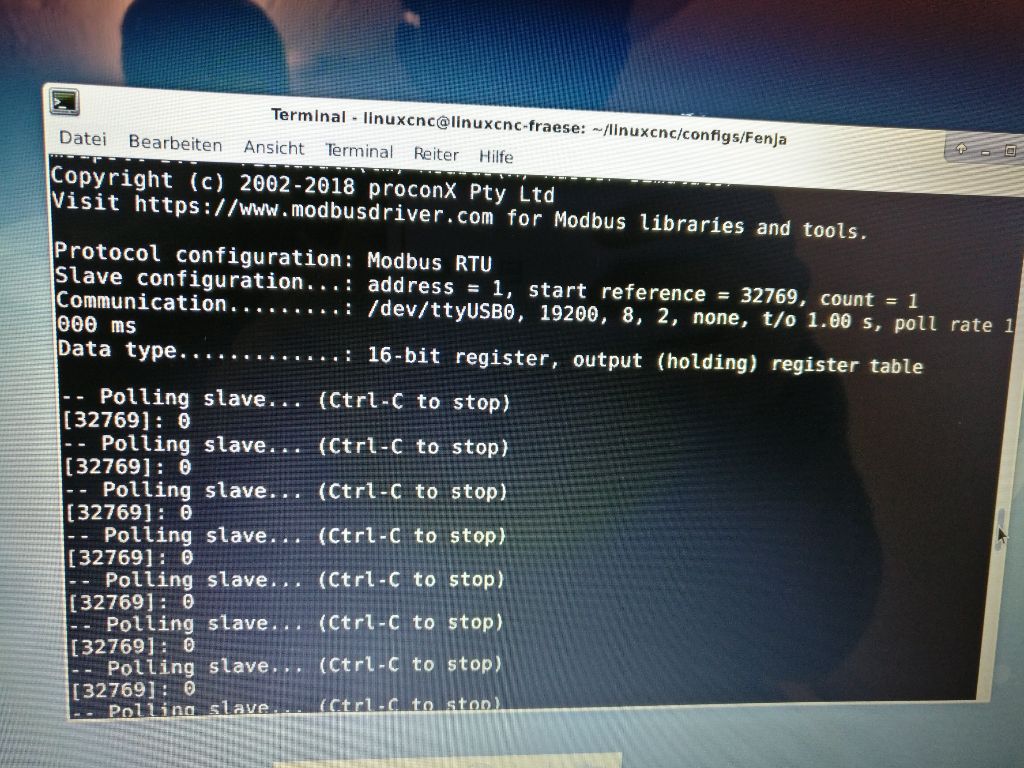

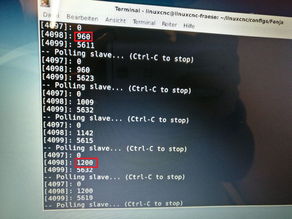

I'm gettin ahead.At first i changed baud rate (thx to mike for that hint) then I got connected but gettin a checksum error.Trying out change decimal from 4097 described in the manual to 4098 I got the frequency displayed in modpull .Frequency changes are shown in Terminal if i turn pots on VFD. I have to add all the decimal numbers I need by 1 digit for whatever reason it works(linuxcnc start counting decimal 0 or 1?)Just wonder whats wrong here. I still get a loop error when I call mb2hal.ini in hal terminal.

Looks like halrun/mb2hal is missing write rights to /dev/ttyUSB0
modpoll works because you're running it as sudo.

I have testet without sudo and it still works . So i can exclude this error. Anyone another idea?
