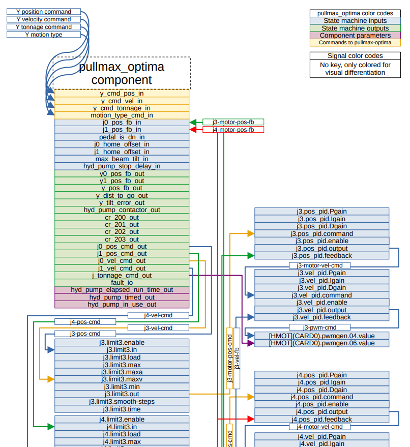

Hello,
question for andypugh : what software do you use to produce the nice schematic in the svg file of wiki.linuxcnc.org/cgi-bin/wiki.pl?SpindleOrient ?

I used Excel. :-/

I also wondered about that....
Turns out that is only available in the cloud based (and therefore to me totally unacceptable (I have a paid licence for earlier "proper" version, and absolutely don't like the new "upgrades", and the fact that I have to pay them more for every month I use it)) office 365. Bummer!
I really wanted to share my updated schematic I made, first to update it to include new pins in 2.8 and to get your feedback on if my additions are correct.
And then to help others in the future.
And I do find a good schematic so much easier to work with than text-based files. At least when it comes to signal flow and trace the different signal paths (and I am an electronics engineer, and have grown up with reading schematics.....).
I will have to look in to if it's possible to use open office.
I have to say I do miss Visio now.....

Open office should do the trick.
I use google sheets that is not as good as Excel but you can work on your sheets from any device, I found this handy.
You are electronics engineer, have a look at this : wiki.linuxcnc.org/cgi-bin/wiki.pl?Eagle2HAL
And : softsolder.com/2013/02/28/eagle-6-4-sche...-creation-checklist/
and all very good related posts from this guy.

If I was drawing the schematic again today, I would probably use Miro.
That is cloud-based too, but it is basically for drawing such diagrams.
miro.com/

If you're just looking for a schematic, you should take a closer look at KiCad.

Don't know whether this would be a solution for your use case or not, I have been doing this in libreoffice draw. Sometimes I get to crowding the pages a bit, but if I'm not planning on printing to paper it is easy enough to set the page size larger.
Each hal component pin is an individual rectangle. The signal wires are 'connectors' so they readily stick to the rectangles and come with when I pull rectangles around. For the signal names I've just been pasting smaller rectangles on top of the connector lines. They're not attached and easily get lost if I start rearranging stuff. Next time I'm drawing one of these I want to use two connector lines to one signal like:
[hal pin a] - - - [signal name] - - - >[hal pin b]
(still in libreoffice draw) the first connector will be drawn from "hal pin a" to the signal name rectangle. The second one will be from signal name to "hal pin b"
With the rectangles I do a lot of copy/paste. I don't drag them around much with the mouse, rather select and move in increments with the arrow keys or enter calculated positions.
I frequently work with the page display zoomed in some when doing this, makes it easier to grab the handles.
I see andypugh has his input/output pins left vs right justified, that is a new idea for me, I'll start doing that way as well. I had all my text center justified.
