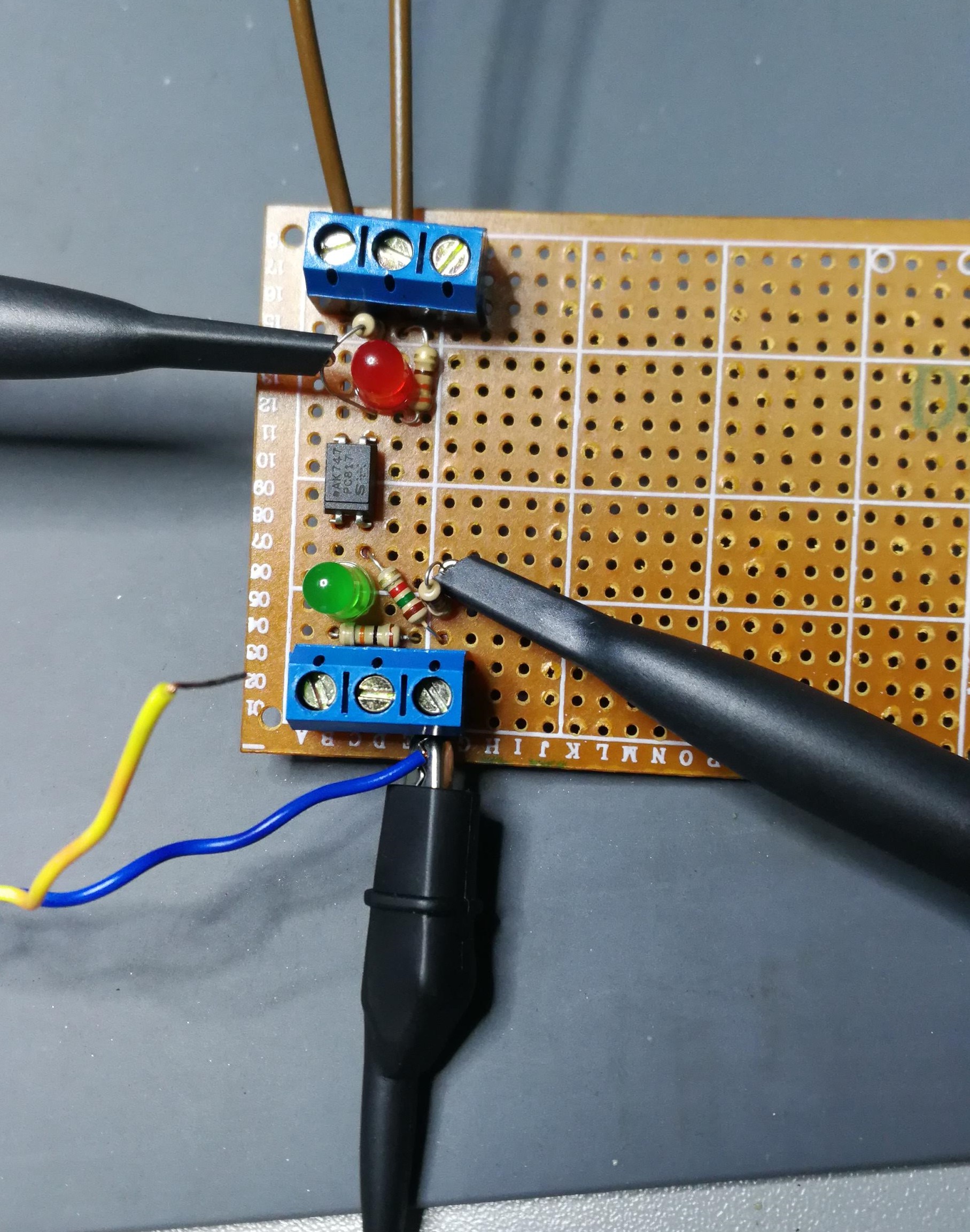

If I use a 5V encoder for A, B signals. Can I connect a 24 V sensor output in place of the Index?
Do I have to use a transition system that converts 24V to 5V?
I don't see this information anywhere in manual 7i76E
- Posts: 18118
- Thank you received: 5336
04 Jan 2020 09:32 #153998
Replied by PCW on topic G33.1 - no position reset when index detects
You would need to translate the voltage from the sensor to 5V
(voltages in excess of 12V will damage the 7I76E encoder inputs)
This translation could be done with an opto-coupler or similar device
The following user(s) said Thank You: Cynas

04 Jan 2020 09:37 #153999
by Cynas
Replied by Cynas on topic G33.1 - no position reset when index detects
I will try to build such a system
Thank you

04 Jan 2020 14:23 #154018
by Cynas
- Cynas
- Posts: 22
- Thank you received: 3

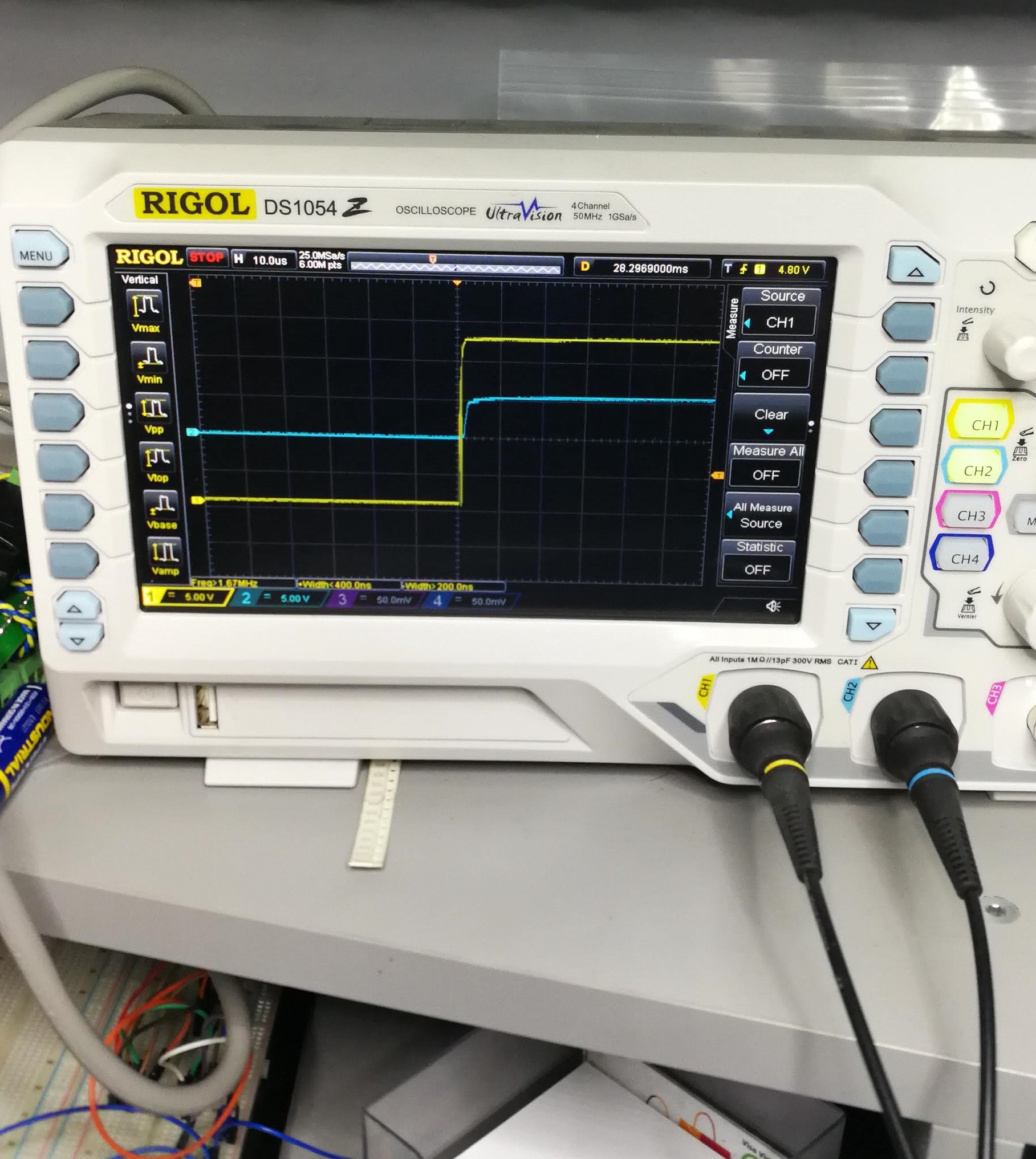

08 Jan 2020 09:11 #154312
by Cynas
One picture expresses more than 1000 words
