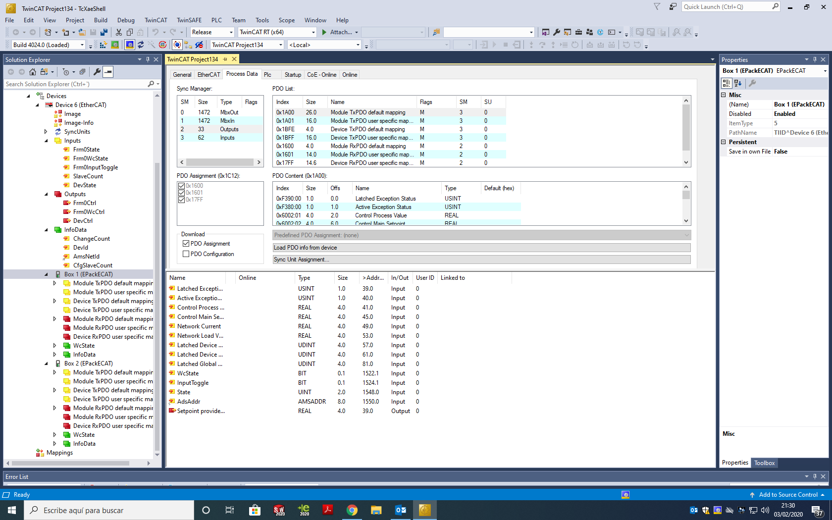

27 Jan 2020 15:23 - 27 Jan 2020 19:33 #155958 by Nico2017

That is why originally I had a config file with all those non defined pdos "Gap" definitions.
For the ethercat I am using:
ethercat version
IgH EtherCAT master 1.5.2 unknown
To come back to the points you asked for:
  • refClockSyncCycles = "1000"
    , if I keep or remove it, it does not look to have any other effect. Again not really sure if it is usefull if those slaves are supposed to work in free run mode.
  • You should also configure the EOE section?
    I am only using EoE to use the proprietary tool under windows to connect myself to change some parameters in the power controller. I have to activate it with TwinCAT that is why you can see it in the project. Although, from the ethercat doucmentation:
    Automatic Configuration: By default, slaves are left in PREOP state, if no con-figuration is applied. If an EoE interface link is set to “up”, the requested slave’sapplication-layer state is automatically set to OP
    , so that could be another way to get those slave into OP mode.
  • ethercat pdos
  • see above
At initial start up, all my slaves are going into PREOP but the EPacks slaves are shown into PREOP with an error E. I have to manually force them to
ethercat state PREOP
to clear the error before launching my linuxcnc with ethercat components. Same thing when I turn off linuxcnc, the EPack slaves go back into PREOP with an error E if I do
ethercat slaves
I can see that there is some AL status message 0x001B: "Sync manager watchdog" in the dmesg, but I am not sure if it is because linuxcnc gets closed and the EPack slave interpret that as an error or if there is something wrong with the way this slave intercats with the ethercat driver.
The manufacturer has guided towards modifying the watchdog parameter. So I have been adding
<watchdog divider="1000" intervals="100"/>
to the slave xml config, but it does not seem to get the normal behaviour neither when closing linuxcnc (EPack slave goes into PREOP with error). To be honest, not sure which value should be entered and what are the units of time for the watchdog.
Nicolas

28 Jan 2020 15:20 #156049 by chimeno
Hi Nico2017
Hi, apparently this additional issue could be from overheating processors. If anyone could confirm this? I think this is not the main problem of this thread but might come time to time on top as the computer is working hard to make the EtherCAT working.
I do not think so, I have forced ventilation in the whole computer and it does not usually get too hot.
etherlabmaster_1.5.2+20180317hg9e65f7-2_amd64.deb
if you have no effect on the devices, only meant every time the Ethercat frame is restarted, I usually stop it at the beginning in the tests to give the whole time, but if it affects "watchdog"
Solo estoy usando EoE para usar la herramienta patentada en Windows para conectarme y cambiar algunos parámetros en el controlador de energía. Tengo que activarlo con TwinCAT, por eso puedes verlo en el proyecto. Aunque, de la documentación de ethercat:
Ok, I thought the configuration had to be loaded every time the device was initialized.
you don't have to worry about the device when it is in PREO-OP E mode before starting linuxcnc-ethercat, since every time linuxcnc-ethercat starts it restarts all the devices and reconfigures, the errors have to disappear once the linuxcnc-ethercat application is started, you also don't have to worry when you close the application, since linuxcnc-ethercat does not close the frame and is left on the air.
<watchdog divider="2500" intervals="2000"/>
can you try this Attached in an .xml file are changes without importance.
also another test that you can do, is to try everything in a single MASTER and change the order of the devices.
Greeting
Chimeno
The following user(s) said Thank You: Nico2017
28 Jan 2020 22:15 - 29 Jan 2020 20:22 #156065 by Nico2017
Hi Chimeno,
so you have just added a watchdog and changed the hal type to u32 for all the pins. Is that it?
I will give it a try later on,
Nicolas
Edit:
Using the u32 does significantly reduce the number of pins used and overall hal memory used (indicated by halcmd status).
But I still get an unstable behaviour.
When I put the non mandatory pdos (empty ones with 0) I manage to go into OP state most of the time but when I put only the mandatory ones, removing the Gap with the 0000 index and subindex, I do not manage to switch to OP most of the time.
Both configuration can actually crash the OS when at the line Ethercat releasing EoE.
Last edit: 29 Jan 2020 20:22 by Nico2017.

Hello Nico 2017
You can try this configuration that attached, I would have to change the configuration to the factory default section 1C32 and 1C33, I am reading the manual a little more and it only works in free operation mode, but the data exchange must be synchronized within 50 hz at 10 ms 60hz at 8ms.
there can also only be a total in the 32 outputs SM2 and in the 64 inputs SM3
I don't know if this can help or guide you
regards
Chimeno

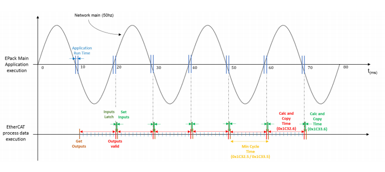

02 Feb 2020 14:11 #156402 by Nico2017
Hi Chimeno,
thanks for your reply, I went extensively over the user guide too.
The synchronisation is a bit specific:
  • when the mains are on, this is following what you described on your post
  • when the mains are off, (not connected, see note on the same page you took the screenshot from), the EPack runs cyclically every 18ms
In my case the mains could either be on or off, the emergency stop de-powering the main for instance. Most of the test I have done so far were with the mains off, and I already observe really strange behaviour of this EPack slave. It does not go into SAFFEOP when the computer start, but goes into SAFEOP with Error. Same thing after closing linuxcnc if it manages to launch it. What would be the 18ms indicating regarding to the EtherCAT config. Has my appTimePeriod to be higher or lower than this?
Moreover regarding the size of the PDO limitation, is it per slave or per sync manager? If it is the second, does this imply that you have a limit on the number of EPack slave with identical configuration that can be daisy chained?
Thank you again for your help,
Nicolas

Hi Nico2017
It's for slave, I tell you because in the project that you passed me from TWINCAT3 on the SM2 OUTPUT you have 33, attached screenshot.
the issue of synchronism not having the device I can not do tests, I still bite the guard dog?
<master idx = "0" appTimePeriod = "1000000" refClockSyncCycles = "1000">
<slave idx = "0" type = "generic" vid = "000001bc" pid = "0000e1a2" configPdos = "true" name = "EPZ1">
<watchdog divider = "2000" intervals = "2000" />
I think you should first set the cycle time, before trying to go to OP, write 1C32.8 = 1 - 1C33.8 = 1 measure time, write 1C32.6 = 1 - 1C33.6 = 1 copy time, then return to set them to 0 and take it to OP, can I be wrong? Never had to do this kind of synchronism.
Greeting
Chimeno
