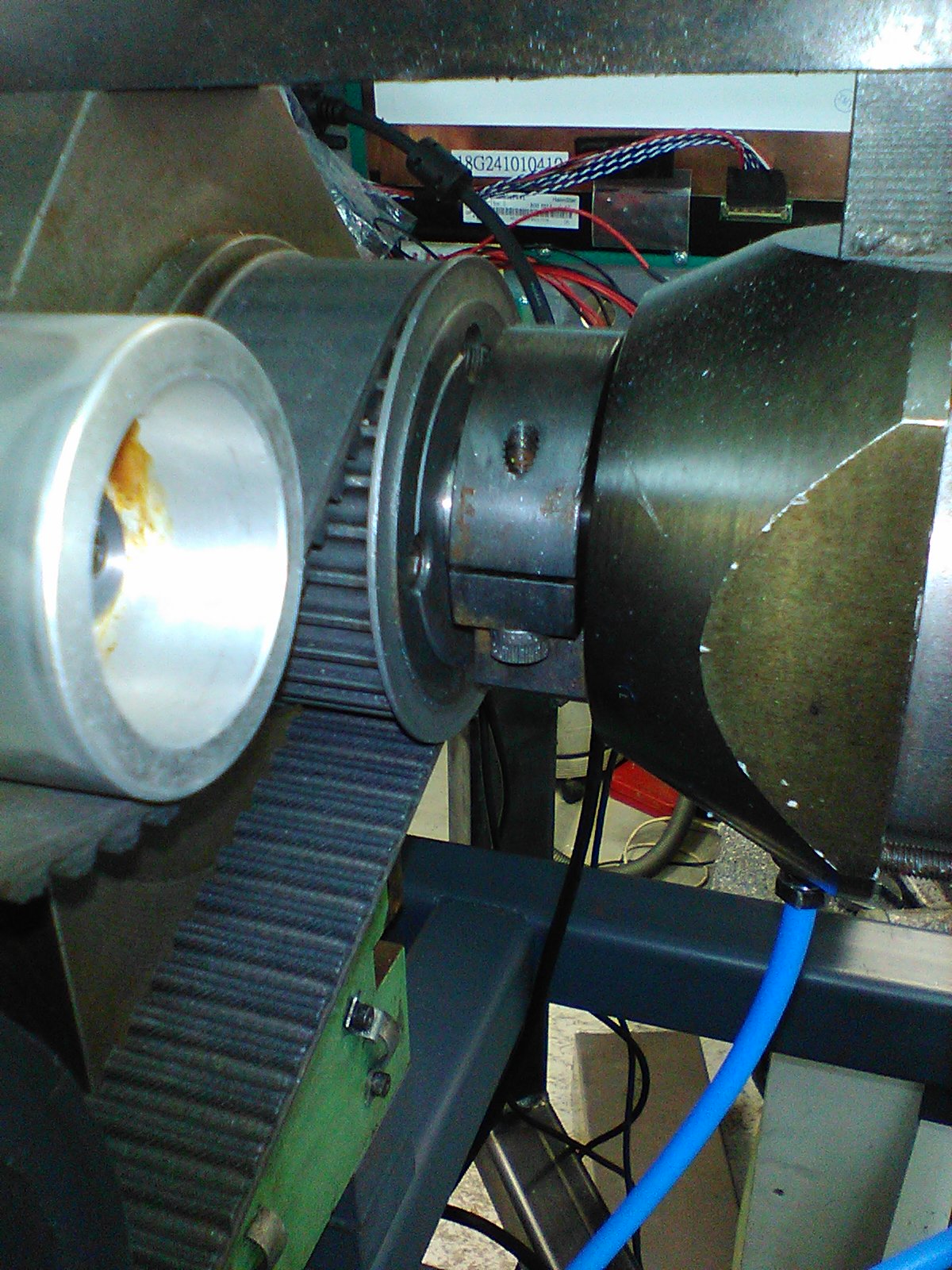

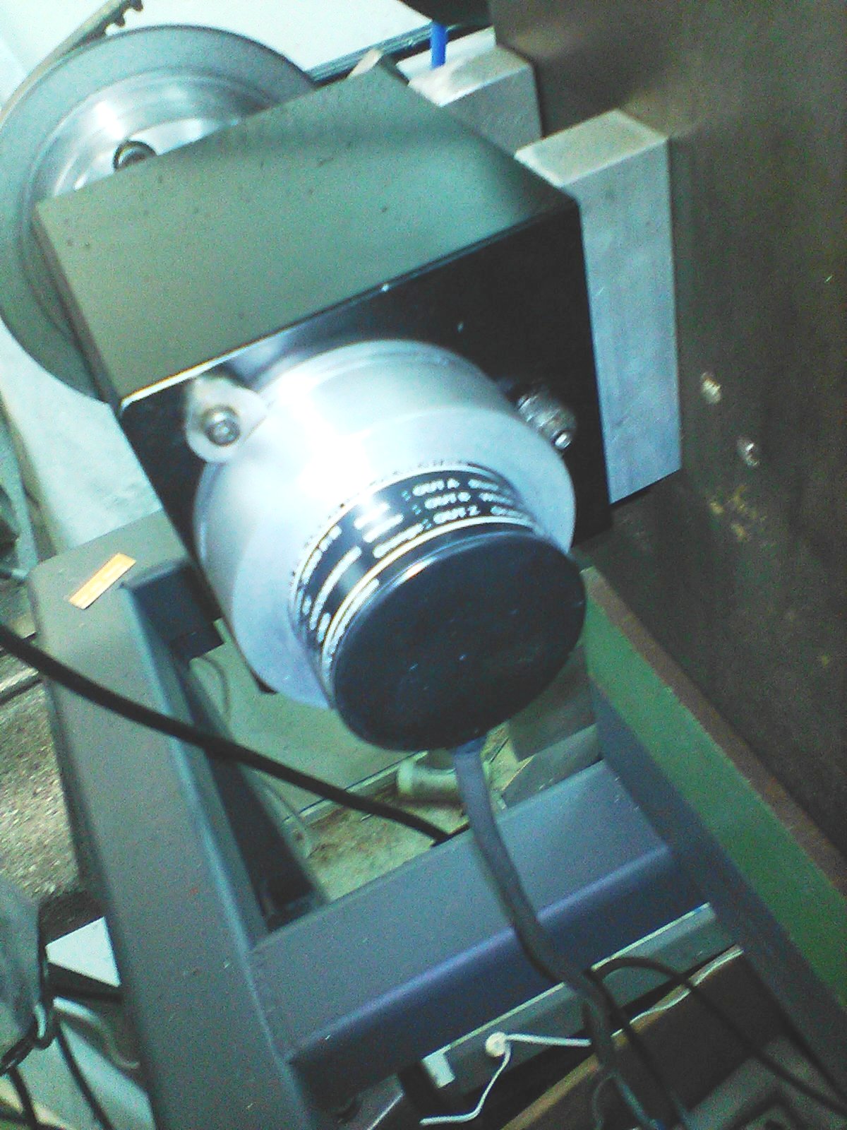

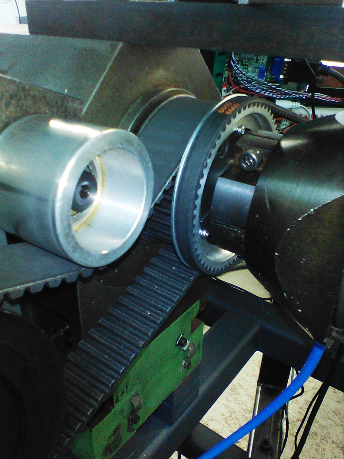

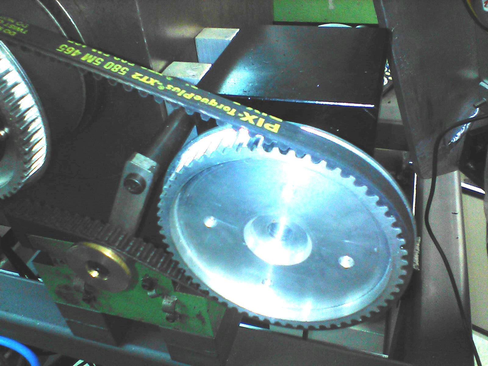

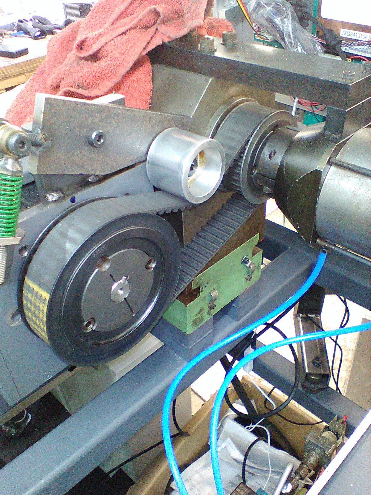

- Daniel_turning
- Posts: 5
05 Apr 2020 09:21 #162749
by Daniel_turning
Replied by Daniel_turning on topic Servo -> Gear -> Spindle
Hello,
I tinker around and put another pully on the spindle shaft.
Now I have a new 2000 line encoder hooked up 1:1 to the spindle shaft. Not beautiful but it seems to works.
Thanks for your help!
Kind regards
Daniel
Kind regards
Daniel
