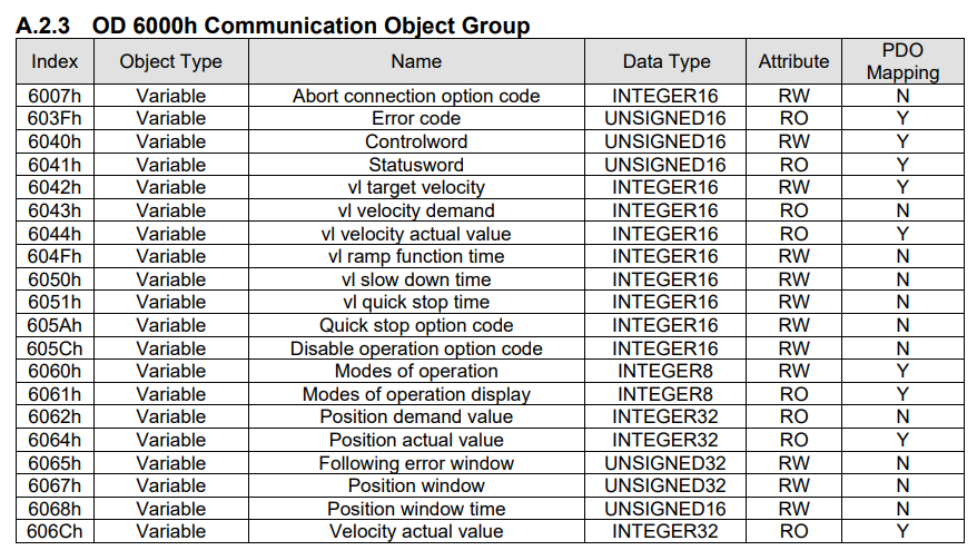

Hi everyone. I have made some progress on 3x Lichuan + 1x Delta C2000. Now I am able to measure the speed when the drive is turned on manually. But still no success with the speed command.
I found that the speed command in HAL CiA402 is 60FF and here in Delta it is 6042. I have tried both, but when I set only 6042 in the XML file, I am not even able to turn on the drive.
Any idea? Thank you.

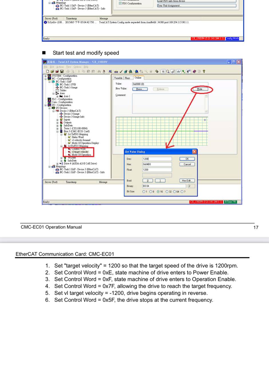

Is that the Delta 2000 CMC-EC01?
There is a manual for download includes a speed demo example.
downloadcenter.deltaww.com/en-US/Downloa...=cdate&sort_dir=DESC

Yeah, it seems you can't do that with the standard cia402 component.
It only support csp mode(1) and possibly csv(0), and what I read your device is working in asynchronous velocity mode(2) and that's not supported at least fully.
It's the controlword, obviously, that starts and stops the motor.
Normally the cia402 component has full control over the controlword and that must be now manipulated by setting on and off bit 4-6 (7F vs 0F) for start stop
There is the option to modify the cia402 component, but maybe "easier" to manipulate the controlword
between cia402 component and lcec.
Break the connection between cia402 and lcec controlword and insert something like
if op-enabled (controlword bit 0-3 set) and start pin (new pin)
set controlword bit 4-6 true
else
set controlword bit 4-6 false
with hal logic. The resulting controlword connects to lcec.
In addition to that, don't connect any of the cia402 commanded or feedback pins, do the speed setting and speed feedback outside the cia402 component. Basically, the cia402 component will bring the device to op-enabled, that's all. You set the op-mode and all speed settings directly to lcec.
else

Hi. Thanks for the help. It works now. It's not finished yet, but it's a good start.
Here are my files, maybe someone will like it.
BR Pavel
