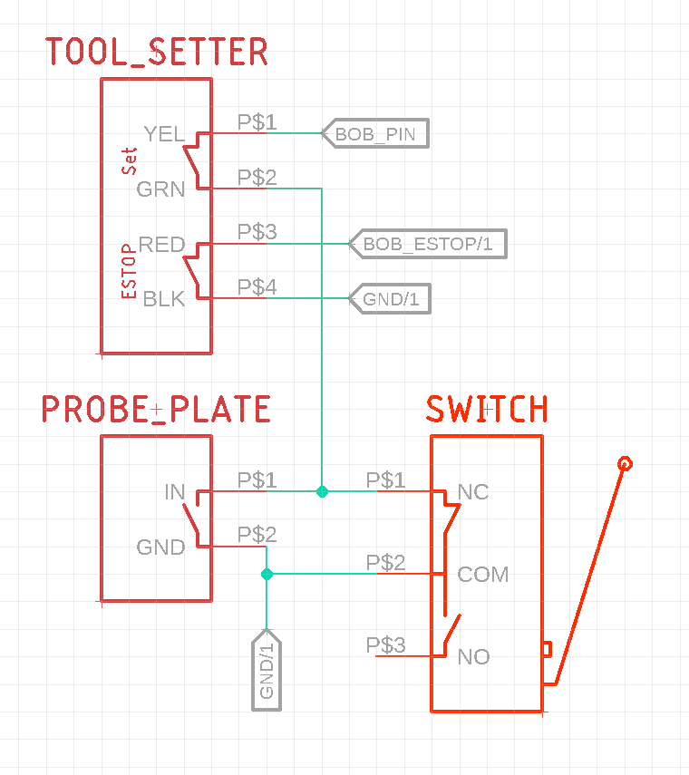

I'm trying to figure out how to connect an NC toolsetter and an NO touch plate to the same input pin on my parallel breakout board. I only have 1 input pin available so I'm really trying to make this work.
Electrically, I'm thinking I can connect both probes in series and have a bypass NC momentary switch that I can manually trigger when I want to use the NO touch plate, like in the attached diagram.
When the momentary switch is untriggered (i.e. normally connected), the toolsetter should work normally. When I want to use the touch plate, I can trigger the momentary switch causing it to be momentarily open, which lets the touch plate to control the circuit.
My issue is I'm not sure how to configure my HAL file to make this work. I'm pretty new to LinuxCNC configuration so I could use some help in this area.

you could also just use a single transistor to invert one of the signals so they are both the same.

I could invert one of them I suppose. And then OR them together somehow.

the switch would work too.
If you want help on the hal side you can upload your hal file to the post and someone can take a look at it.

Ok so my understanding is that in the below code, the line that sets net probe-in <= parport.0.pin-11-in makes probe-in an active HIGH signal.
In my use case, it needs to be active HIGH by default but active LOW when using the momentary switch. Is there a way to do this? I can create a new net called probe-in-not <= parport.0.pin-11-in-not, but then I can't seem to also connect it as a secondary motion.probe-input. (Is this even possible?

On mobile before bed have you looked into this
linuxcnc.org/docs/html/man/man9/or2.9.html
Check the page here for things you can do for and and such
linuxcnc.org/docs/html/hal/components.html
