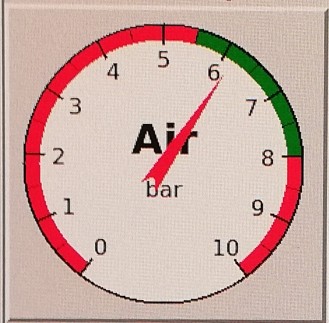

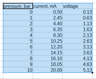

hi !
My pressure sensor is connected to mesa 7i76e analog "0" input....I can read it it and so on...but of course it show me wrong numbers...how to correct all values in properly scaled format
my postgui file contains:
#air pressure
setp hm2_7i76e.0.7i76.0.0.analogin0-scalemax 75 (this scalemax 75 gives allmost correct value with 6 bar air pressure)
net pressurein <= hm2_7i76e.0.7i76.0.0analogin0
net pressurein => pvcp.pressure
pressure sensor parameters are attached
#air pressure

take a look at the scale comp:
linuxcnc.org/docs/2.8/html/man/man9/scale.9.html
- Posts: 12174
- Thank you received: 4155
03 Dec 2021 03:43 #228270
Replied by rodw on topic Air pressure pyVCP gauge real values
Have a look at the lincurve component. That will let you map your output to theĀ non linear data in your tableĀ

hi !
problem solved...
net pressurein scale.1.in <= hm2_7i76e.0.7i76.0.0.analogin0
setp scale.1.gain 2.52
setp scale.1.offset -0.7947
custom postgui.hal
net pressurein2 scale.1.out => pyvcp.pressure
OK....HOW IS IT POSSIBLE TO DISPLAY MESSAGE (ALERT) WINDOW IF THE AIR PRESSURE VALUE DROPS BELOW A LIMIT VALUE? ANY IDEAS?
