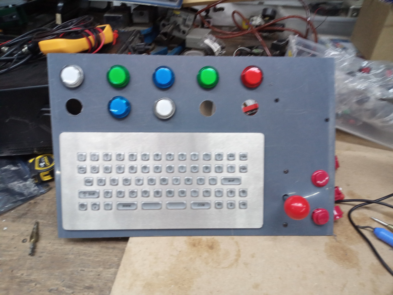

07 Jan 2021 05:07 - 07 Jan 2021 05:08 #194350
by ikkuh
If it is about inputs, I use a cheap Arcade Joystick usb board that gives me a lot of inputs for very low cost. I changed the buttons for arcade buttons with an LED in them, better quality and it looks very nice. I use the Joystick for x-y movement, but if you leave out the joystick you have another 4 inputs.
Btw, using the Toggle component in your hal files for these inputs will make efficient use of the inputs. You only need one input to signal an on or off signal.

Replied by ikkuh on topic External E-Stop
if it comes down to it the second parport
Snippet from my postgui.hal (I am using gmoccapy):

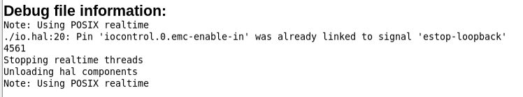

Hello all,
I would like to install an E-STOP button.
Not Off = www.amazon.de/gp/product/B09H49D44Q
with the code:
Do I get an error:
Why do I get the error?
The CODE is here from the forum, it says that it works.

The error message is very clear, it says that the emc-enable signal was already connected. And indeed in your 7i95-notaus.hal file are the following lines:
# Standard I/O Block - EStop, Etc # create a signal for the estop loopback
net estop-loopback iocontrol.0.emc-enable-in <= iocontrol.0.user-enable-out
Last edit: 27 Apr 2022 06:09 by ikkuh. Reason: The editor of this board sucks big time!

27 Apr 2022 08:00 #241375
by Muecke
Replied by Muecke on topic External E-Stop
THANKS @ikkuh, I just looked in the io.hal, sorry.
Now I can operate the emergency stop
