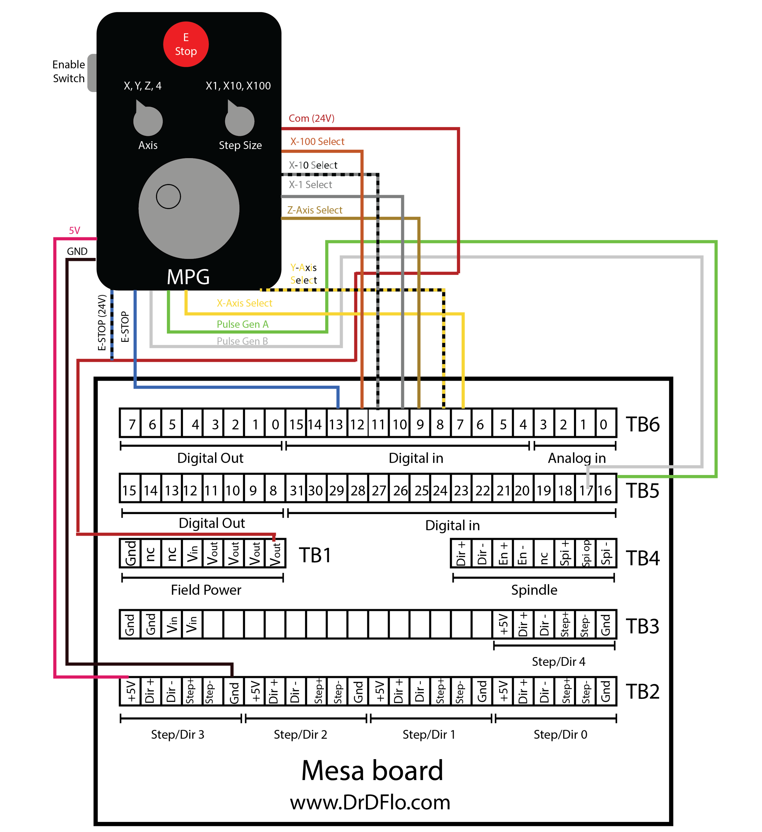

hey guys,
suddenly my MPG hand wheel has stopped working, (it wont move any axis ) i can move them by keyboard and ps3 controller, im still on building the machine, so i don´t know what happened.
im getting readout from HAL METER pins @ encoder-count , , it counts when i turn then encoder wheel, and selctor for xyz is also showing when i press the side button and turning the knob,
what i can get show up in Hal meter when i turn knob and press the side button:
>encoder-counts ( counts up and down when i turn encoder wheel )
>mpg-x (when i select x and press the side button )
>mpg-y (when i select y and press the side button )
>mpg-z (when i select z and press the side button )
>scale1 (when i select scale 1 and press the side button )
>scale2 (when i select scale 10 and press the side button )
can´t find the input when i select scale 100 and press the side button

I think that you have forgotten an addf line
addf mux4.0 servo-thread
