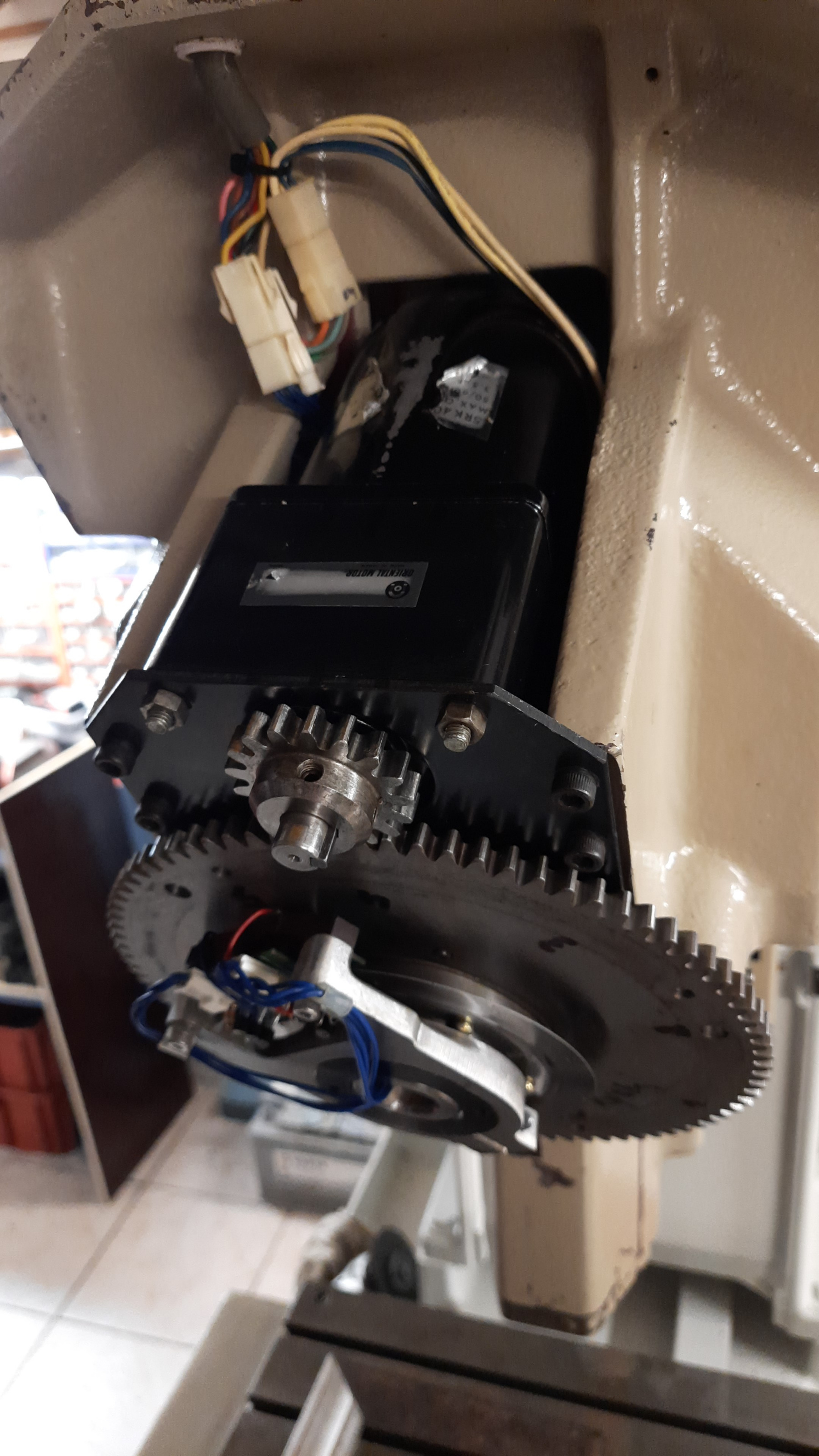

Hello,
We have Brother Tc-211.
I has rotary ATC.
I use HAL component carousel.
Binary encoder 4 bit, w/o trigger bit.
Controlled by asynchronous motor.
Pin for controller - carousel.0.motor-fwd and carousel.0.motor-rev
My problem is that the encoder doesn't have a trigger bit, so sometimes some bits are read faster than others. The carousel component is confused by this.
So we have a problem when moving from position 9 to 8 and from position 3 to 2.
Why is this so:
9 = 2^3+0+0+2^0
8 = 2^3+0+0+0
3 = 0+0+2^1+2^0
2 = 0+0+2^1+0
When I want the revolver, let it turn from position 9 to 8 or from position 3 to 2. Then the engine starts and immediately stops. A situation occurs when, due to manufacturing tolerances, bit ^0 (2^0=1) turns on one millisecond before the rest of the bit, and the program thinks it is already in the position where it should be (but physically it is not) and turns off the rotation relay.
Any Idea what should I do now?

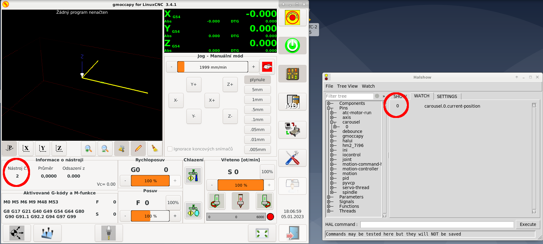

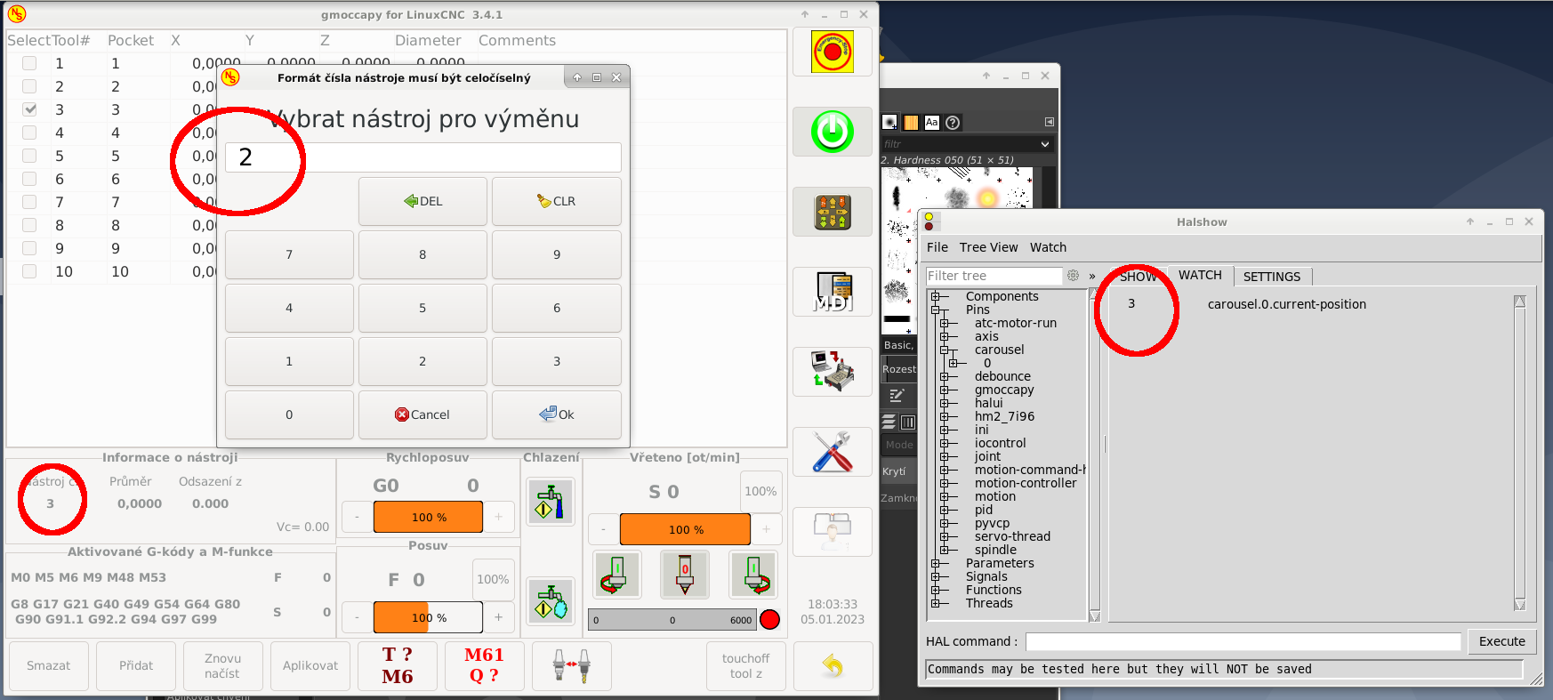

05 Jan 2023 11:14 #261009
by zz912
Replied by zz912 on topic Carousel - dont work w/o trigger
It did not help:
I am in position 3 and I want move to position 2.
ATC descends from position 3 and stops.
ATC generally works, but some positions do nonsense.
# nacteni komponenty debounce
loadrt debounce cfg=4
addf debounce.0 servo-thread
setp debounce.0.delay 10
# vstup komponenty debounce
net atc-bit0 => debounce.0.0.in
net atc-bit1 => debounce.0.1.in
net atc-bit2 => debounce.0.2.in
net atc-bit3 => debounce.0.3.in
# vystup komponenty debounce
net atc-deb-bit0 <= debounce.0.0.out
net atc-deb-bit1 <= debounce.0.1.out
net atc-deb-bit2 <= debounce.0.2.out
net atc-deb-bit3 <= debounce.0.3.out
# spojeni nactenych bitu a komponenty carousel
net atc-deb-bit0 => carousel.0.sense-0
net atc-deb-bit1 => carousel.0.sense-1
net atc-deb-bit2 => carousel.0.sense-2
net atc-deb-bit3 => carousel.0.sense-3I am in position 3 and I want move to position 2.
