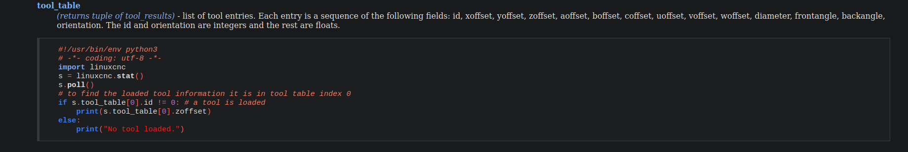

28 May 2024 03:57 #301647
Replied by Aciera on topic Custom Hal Component
- Posts: 4819
- Thank you received: 2177

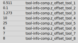

28 May 2024 04:34 - 28 May 2024 07:04 #301649
Just tested it:
gives me:
[edit]
Had to add this line in the code above otherwise the component would crash if the tool table was changed:
if s.tool_table[1]:

28 May 2024 08:04 #301673
Replied by Todd Zuercher on topic Custom Hal Component
Thank you very much. I'm eager to test it out.
